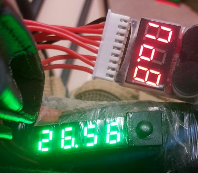

And of course i'll need to get some low voltage alarms to protect.
I'm still needing to learn about matching/balancing the cells and using the PL8 properly but wondering if any advice before i purchase?
Also does anyone have accurate fuel gauges, or just the low voltage alarms?

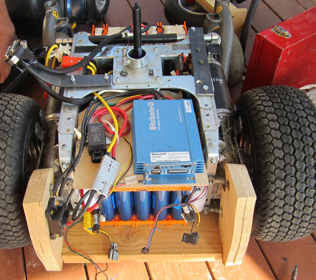

Postby robert97 » 05 Sep 2017, 15:15
front pack
wiring diagram for two 7S 5P packs
I got my prototype chair converted to lithium over the weekend. works great.
i'll be checking the range.
I used a couple of novel approaches that I haven't seen before
on the forums. Maybe others will find some of these ideas useful.
One of the major constraints was fitting the lithium to a C350 permobil.
Because of the center seatpost I required split battery packs.
Also, the PL8 charger cannot handle more than 8 cells in series.
Given the space requirements, the desired amount of power,
and the desired voltage I chose to make a pair of
identical packs. Each is 7 series 5 parallel.
My diagram is crude but should be easy to follow. One novel
idea is how the pull loop connects the two packs in series via
the yellow wire. I get 48 volts and I get a full loop to
interrupt power. Power can also be interrupted via the contactor
which ves positive 48v to the Robotech. And
the circuit breaker which goes to the ground side of the
Roboteq.
With Anderson connectors and careful wiring it's very easy to
remove the packs from the chair. again the packs are identical
and interchangeable.
robert
rear pack
robert97
Posts: 74
Joined: 03 Jun 2017, 15:34
Location: Boulder, Colorado
Postby Burgerman » 05 Sep 2017, 16:38
You should have a ton of range.
Thats 14S and 5x 12Ah, so
3.3Vx 14 = 46.2V
X
12Ah x 5 = 60Ah. And thats 2,77kw hour pack.
Posts: 71106

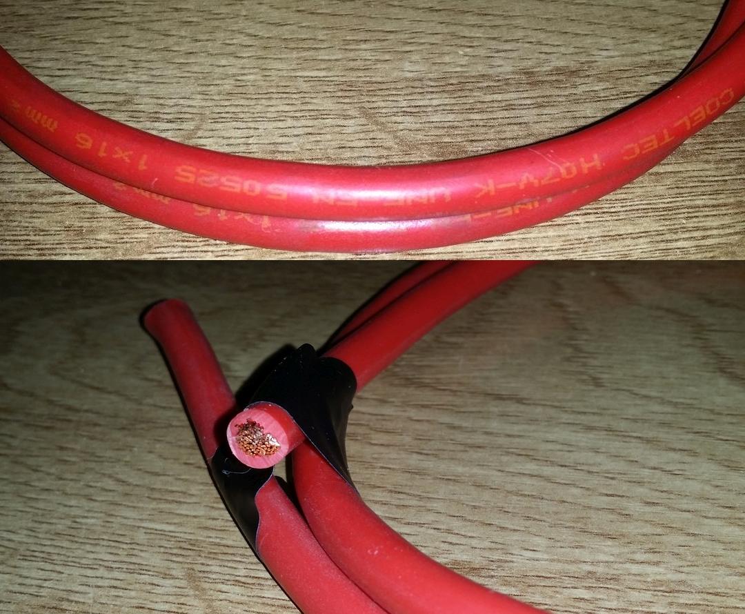

By "Battery Discharge" I assume you are talking about the cables that actually power the chair?
If so, I would be inclined to say that AWG 10 would probably work, but is on the light-weight side... I would go with at least AWG 8. Personally I use AWG 6, but that is on the over-kill side...
FWIW, BM uses Metric 10mm^2 cable on his chairs. If you look that up on some of the charts, it's about equal in theory to AWG 7, but since the only place I've ever seen odd number AWG sizes is as numbers on the charts, we have to go to either AWG 6 or 8.... Others have suggested that AWG 8 is OK for most users, but if you want the absolute maximum performance (i.e. for sports use) go with AWG 6. I figure the cost difference isn't that much to go for AWG 6, and that has the advantage of being the size of the most common pins for the SB-50 / PP-75 series shells...

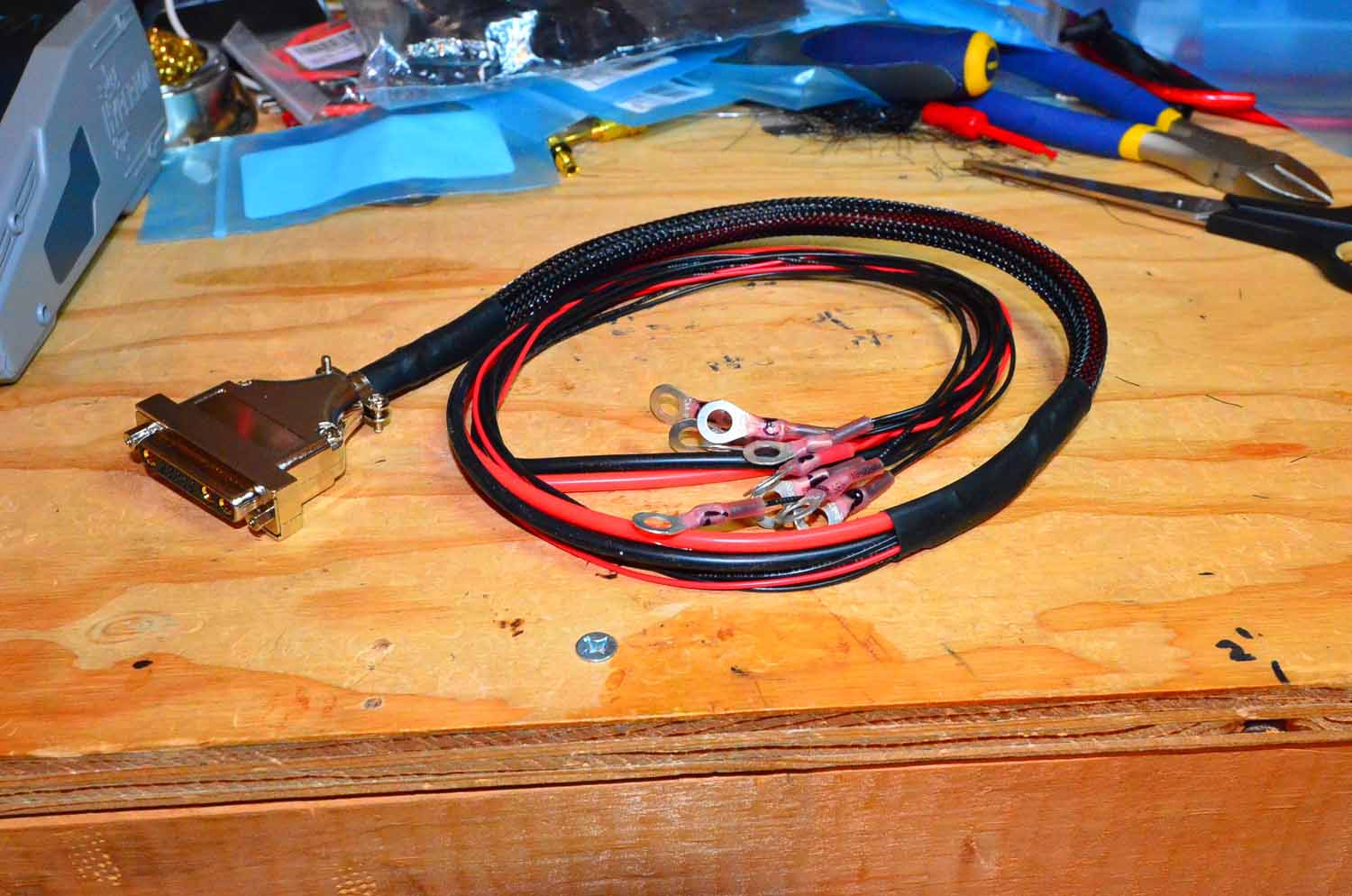

Initial & Single Cell Charge: 12AWG w/ 8AWG copper ring terminals (1/4" stud holes) to D SUB connector
Cell Voltage Monitor: 22AWG to D SUB connector
Have yet to nail down the PSU but it's looking like the 24v47a supply from FeatherMerchantRC.com.
Also need to find the ebay link again for those cell monitors and pick a D SUB.
Any fast links to a good thread for initial charge & cell balance process for assembling my pack?
Thanks!!
Postby dEknowmight » 12 Sep 2017, 04:48
Yes "battery discharge cables" meaning battery to scooter. The current cables are 10awg so I figured there wouldn't be any change in draw from battery so should be good. I'm actually going to use the same cables that are on there now. In future I plan to step up voltage and get different motor/controller combo so will definitely upgrade the cables. Thanks for the input, I'm learning a ton here and thankful for all the shared experience everyone offers.

Cable size selection should be based on current draw, not voltage. Using heavier than 10ga. may well improve responsiveness even if the original was awg 10, but in general scooters don't draw as much current as powerchairs when maneuvering so smaller may be OK. Still, it costs very little to put in heavier wires.
Postby Burgerman » 12 Sep 2017, 18:25
I may also add that if you increase the volts, any given level of motor power used will now take only half the amps. And so the stock cable size becomes much less of a problem.
Posts: 71106

One more question...
This cable:
https://hobbyking.com/en_us/turnigy-hig ... m-red.html
should be fine for chair-side cable or 12AWG like PL8 charge cable is OK?
FJC10
Posts: 128
Joined: 30 Jul 2014, 20:42
Postby Burgerman » 15 Sep 2017, 12:33
Ideally on the chair, where 200A can be demanded you need 10sqmm and it needs to be marine, tinned, and thin hard insulation.
Silicone is used by the hobby industry because it means the cables can be smaller, lighter, more flexible, because it doesn't melt. But that stuff is easily torn, or ripped and you don't want silicone cable on the chair itself.

I think I explained myself wrong ...
chair-side cable for charge and balanced, like this:
My wheelchair (Invacare TDX SP) have Anderson SB50 connector + 80 amp fuse, can you see it in this photo:
If I see that I need a longer cable, I have this cable to make one for battery->chair side:
Is ok?
