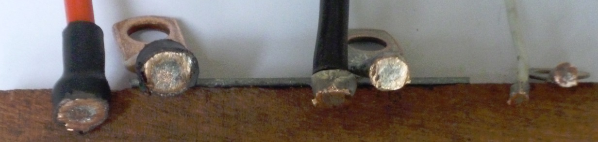

My dad has done some solder tests, here is the result. Are they Ok? Is there anything he should do to make solder better?
Posts: 1259
Postby Burgerman » 21 Sep 2017, 11:44
Looks like too much heat and not enough cleaning or flux. The larger cable doese not look soldered or not enough solder? Could be wrong as pictures very noisy. Probably taking too long. The discolouration shows that. But it would likely work ok as it is.
Tin the cable on the larger one first. Then assemble. With flux, and add a small amount of extra solder as you heat it.
A good solderjoint is shiny, smooth, and no discolouration or dull appearance.
To get this you need to use flux, and just enough heat for a short time then stop!

The black cable was soldered. The ring terminal before soldering is like the pic underneath.
My dad followed the video below. He heated the terminal, tin was melted and ran from top down to bottom. Did he do the right way?
https://youtu.be/L9crUFwN6DE
He used a tiny flame gas pen for heating. As I saw he to soldered the black cable in 10 seconds. So he needs to reduce the soldering time down to a half. He did use flux, wires and terminals were clean before soldering.

Here is the pic of terminals after being cut off.

They are ok. Just dont look pretty. Too much heat maybe? Or bad photo even!
