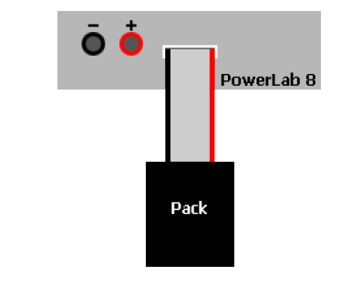

Postby snaker » 25 Sep 2017, 02:06
Please help me to check if the pins and holes on DB13w3 are correct?
- Red: positive pin/hole
- Gray: negative pin/hole
- Blue: unused pin/hole
Posts: 1259
Postby Burgerman » 25 Sep 2017, 09:36
Theres no correct way. As long as both halves match up!
I did mine this way. 1 error on schematic. Pos on the top, should be pin zero! (neg) And 12345678 are the pos ends of the cells. And I also decided to join the two large neg terminals (that are close together), and on subsequent cables by splitting the wire into two. But thats not essensial. Works fine anyway.

Postby Burgerman » 25 Sep 2017, 09:54
power lab as you look at it...
Main pos/neg connectors.
Then balance connector has 9 pins.
Pin 0 (or zero), negative is the closest pin. Black on this drawing.
After this, counting to the right, is pin two which is cell1pos, then cell2pos cell3pos cell4pos cell5pos cell6pos cell7pos cell8pos.
So pin 9 is cell8 positive, and battery positive. As long as these all end up correct at the battery it will work and no smoke from charger!
Balance port: 0neg then 1 2 3 4 5 6 7 8 (NINE wires)
Posts: 71117
