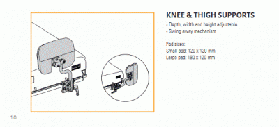

Going to get some of those knee or thigh pad thingies. On this Sedeo pro seating brochure. I usually have a "bumb bag" velcro strap etc around my knees to stop my legs splaying. (centre footrest causes that). But it leaves a mark around my legs...
Page 10. Keep trying to get a price but sunrise seem to go home at night!
SEDEO_PRO_Brochure_V1-Low-Res.pdf

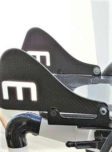

knee guards carbon fibre ideas
Postby Burgerman » 11 Nov 2020, 13:45
I need them to flip up and down and be padded. But I will be doing something similar! I could actually do with in on all my chairs.
Posts: 71086
Postby hank » 11 Nov 2020, 14:56
Those do the black plastic front lugs are slotted for each wing to locate
Just ideas for you Lightweight models :thumbup:

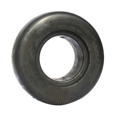

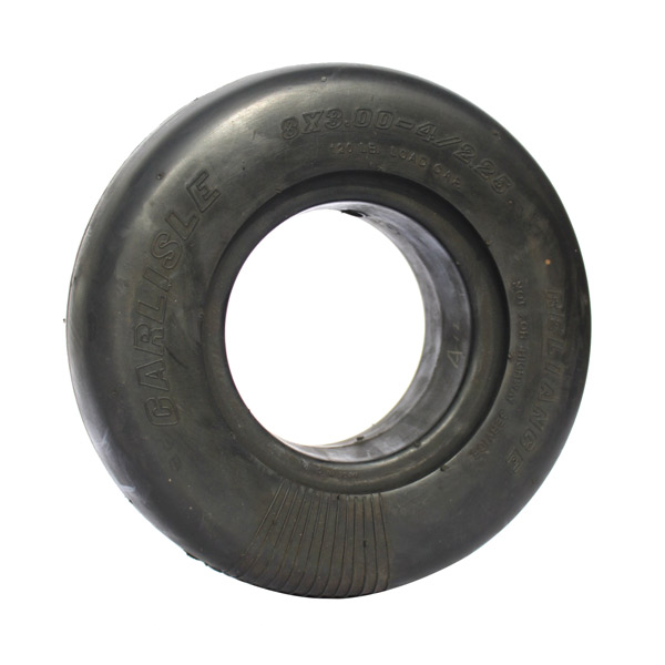

For those that worry about tubes. The 8 inch caster tyres are available as semi solid.
a Carlisle Reliance 8x3.00-4 here:

Postby Burgerman » 17 Nov 2020, 18:16
Solid ones are similar price.
I ordered 4 (2 sets) from a dodgy site - coming from china. £34 inc delivery. Cheap, and carlisle branded. But slow... 20 days so far. Thats £8.50 each for a good brand with high load index..
