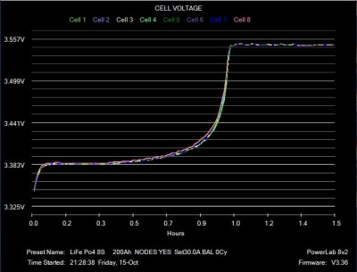

Postby LROBBINS » 18 Oct 2021, 12:34
Or the cells were balanced by wiring in parallel and charging as a single cell. My 200AHr 8S pack, having been initially balanced that way, behaves like this with the PL8:
Not much imbalance to remove
