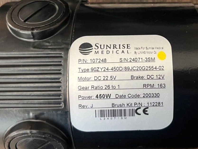

Again though, they are all the same "fit" as such. So as long as they are both the same it really shouldnt matter.

That's interesting thanks. Why so many different specifications for same speed motors then! Sunrise like to make it difficult.

Because they use 12 inch wheels. 14 inch wheels. 2 different 3 bolt hubs, and a 4 bolt one, some with differing offsets to keep chair narrower ith thinner tyres and they make minor revisions to design internally year on year for reasons they only know. Remember tat even the cable length changes a part number. So mid drives or chars with 12 inch whels may both be linix 6mph 4 pole but be different RPM, or different connector length, different hub with different offset and / OR stud PCD
They all "fit"... But maybe needs your old hubs, or a motor compensation change or whatever. And some go the opposite way. So you swap a different part number and your left right/back forwards are all wrong. Again no prob if you have a programmer but they dont want that when someone swaps a motor...

Yeah, guess so. A set of 4 pole, 6.5MPH motors from a Q300 running smaller wheels might well be a revelation then. :mrgreen:

As thought, the other two 6.5 MPH motors with the higher RPM and lower wattage figure are 2 pole. However, I am informed another 2 sets of 4 pole 6.5MPH motors are being listed shortly for anybody else interested.

I see this Q700 motor listed on ebay. Is it 6mph or 8mph?

6
