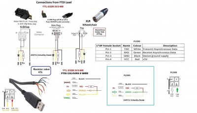

Re: VR2 Programming problem - Q500R
Postby Potty » 21 Sep 2025, 21:03
martin007 wrote:Hi.
What connector do you use to communicate the powerchair with the computer?
Have you made it yourself?
I made a cable to this spec:
I bought this cable( https://www.amazon.co.uk/dp/B08Y8DQ4NX? ... title&th=1 ), cut the end off, soldered the the 47k resistor, soldered the 1N5711 Schottky Diode(make sure it's the correct way around), used some heat shrink and soldered it to a XLR plug.
Works fine with regualr VR2 controllers (I think pre 2023 ish), but does not work with the new ones that read "VR2 2" like in this picture:
Potty
Posts: 66
Joined: 09 May 2024, 02:59
Postby martin007 » 21 Sep 2025, 21:08
That's what I wanted to hear.
The industry has modified the new VR2...
They want to prevent us from programming VR2 in a cheap way.
Thank you very much.
