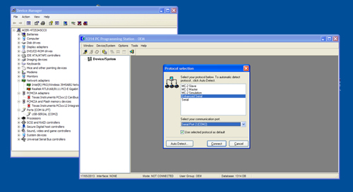

Postby zamahuikano » 21 May 2013, 02:28
:D The cheap blue USB/Serial CH340 works perfectly. The protocol used in the 1314 is the Enhanced Serial COM2 and lower the minimum buffers on the properties of the serial port "device manager".
screenshots:
USB/Serial CH340
connections TX, RX and GND
2-SERIAL ADAPTOR INTERFACE.jpg (109.76 KiB) Viewed 22023 times
Thank you and greetings
