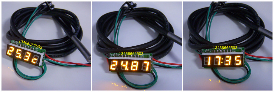

:D Found this small combo metre . It has 4 modes ; TIME ; TEMP ; VOLTAGE ; CYCLE through all 4 modes at 5 second interval . 8-)
:P Two versions ; 0 - 33V ( or 200V ) . Price is in RMB , so is 1/6 in $ USD . . . ;) DISPLAY SIZE : L 32mm × W 10mm× Thickness 13mm 8-)

Does it have the low voltage alarm that you can set for the life batteries? My reason for using one.

Burgerman wrote:Does it have the low voltage alarm that you can set for the life batteries? My reason for using one.
NO. IT'S A VOLTMETRE . ;)

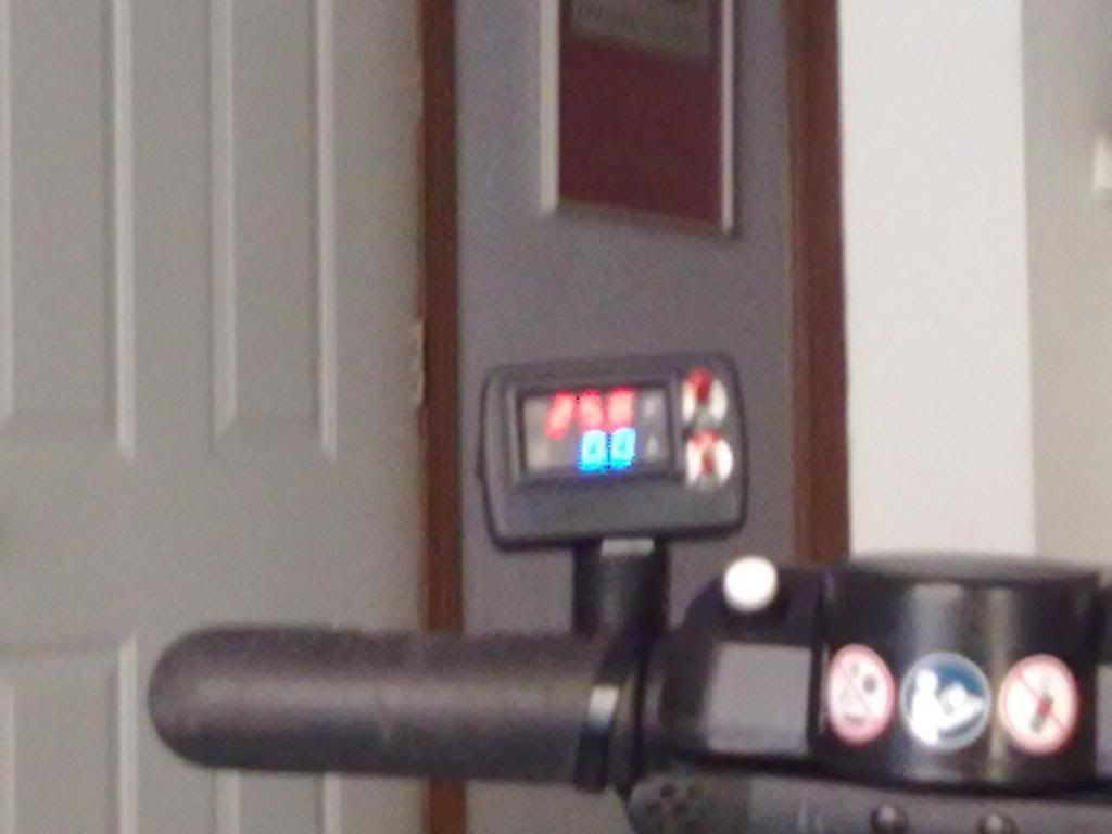

Sorry for the fuzzy pics, my hands have gotten a bit fuzzy the past few years also LOL. I will setup a tripod when I finish the project and take some better pics if anyone is interested. . These are pics of my new volt/amp meter and lights I added to the Revo. I am going to remove the temporary gooseneck I have the meter mounted on and replace it with an 18" black microphone gooseneck that will clean up the mounting also. I am very happy with the LED lights which were dirt cheap and I ended up mounting both so I didn't use the voltage converter. I added two small toggle switches to the meter housing to be able to turn the lights and meter off/on. Total out of pocket expense so far is around $35.
Before I had the amp meter I had always wanted to know what the amp draw was on the batteries and how my driving affected it. Since it's digital I'm sure I'm missing some peaks but I am very satisfied in what I'm seeing. The results bore out what Bm has said about current draw being lowest when driving flat out. I was surprised to see that my peak draws are mostly below 40amps and my scooter averages between 7.5 and 9 flat out at 4.5 miles an hour on flat. sidewalks or pavement. With the new Gels I'm seeing a very flat voltage and haven't driven it far enough to see any voltage sag. That is very comforting and makes me so glad I added the amp/volt meter.

Postby Burgerman » 19 Feb 2013, 04:39
This is why scooters go further than powerchair on the same batteries. They dont use power for turning... And motor amps are a very different thing to battery amps.
Its also why running flat out is the most economical.
Going slower uses the same amps but does it for longer to get to the same destination.
So traveling at half speed would need to use less than half the amps. To be more economical. But thats not what happens. So go full speed.

I'm measuring current between the battery and controller, so would that be motor amps?

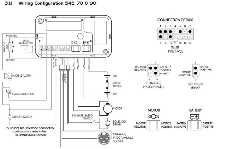

Is the data, schematic published for a PG 45a controller?
You mean this for the S Drive?
s-drive wiring.jpg (72.38 KiB) Viewed 7687 times
Voltage specs on the final page of this.
http://www.pgdt.com/pdf/s-drive.pdf

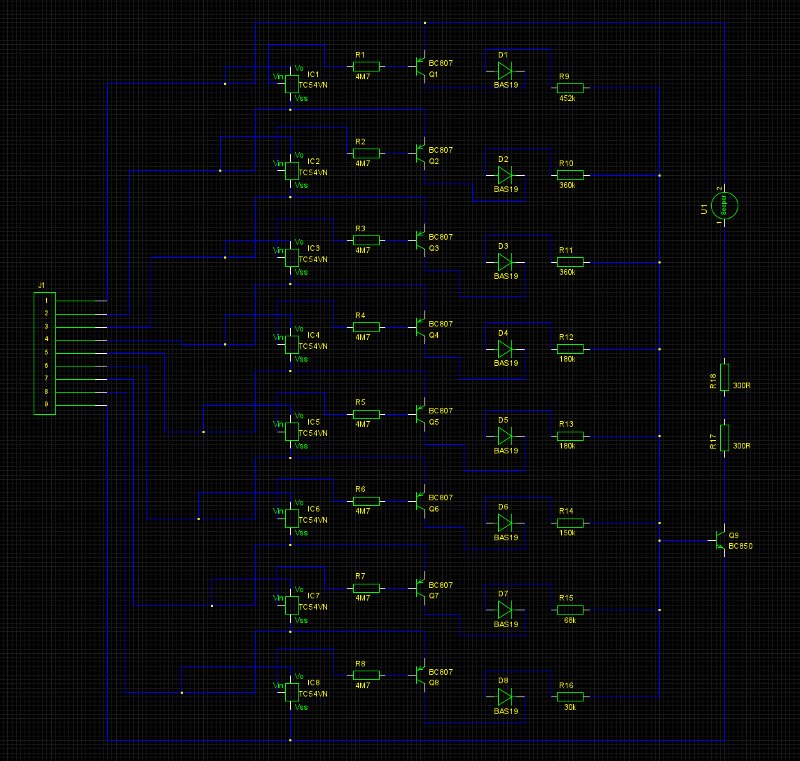

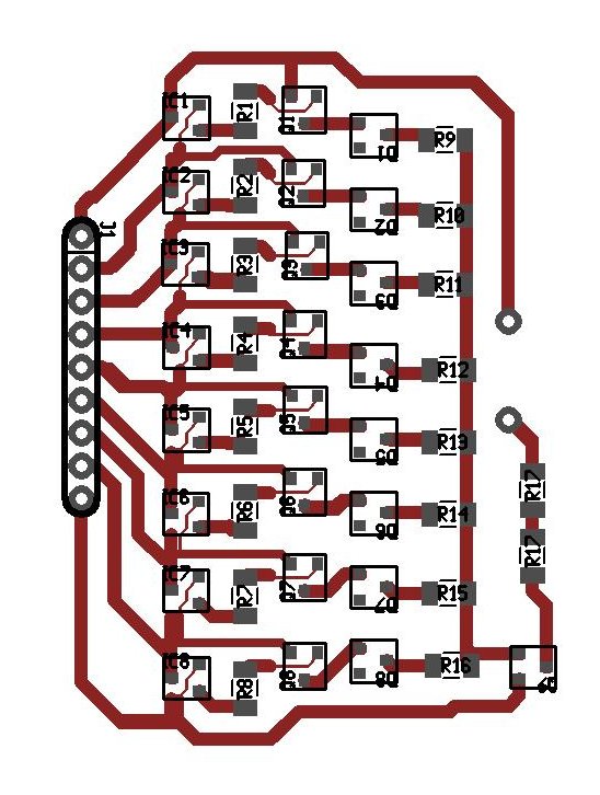

I don't know how helpful this will be for others, but I've designed a low voltage alarm for my LiFePo4 batteries (8s).
It uses TC54VN3002ECB713 voltage supervision chips (3.0V) - they are also available at different voltages, but obviously cannot be adjusted.
The circuit diagram is as follows:
I've measured the voltage the alarm switches on for each of the cells and for most of the cells it switches on at 2.90V and stays latched at 2.95V, but the latch drops out at a voltage of 3.05V. I didn't measure the exact voltage because I only wanted to check it worked, so used potential dividers (with an extra resistor in parallel for the input being tested) to give a rough idea of the switching voltage. (I may do a proper test and measure the exect switching voltages another day).
I haven't measured the quiescent current, but the datasheet specifies a typical quiscent current (per device) at 0.9uA, so leaving the battery monitor permenantly connected will over a week drain the batteries by 0.9uA*24h*7 = 151uAh, or over a year 151uAh * 52 = 7852uAh = 7.9mAh which in 15Ah batteries is negligible. Also the drain on each battery is identical.
Best Regards

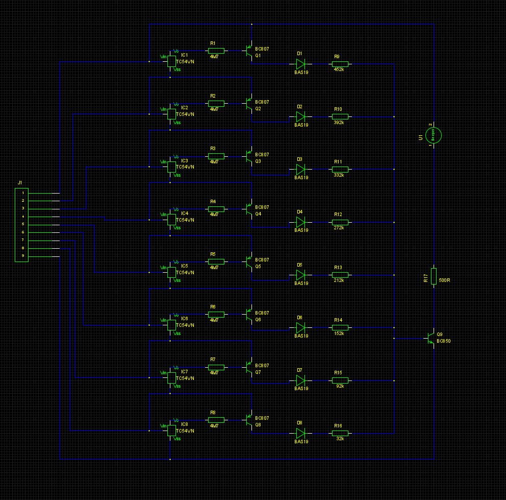

Oops the circuit I posted wasn't quite correct (I fiddled with it to get the schematic capture to work as I hadn't got the layout of the SMD components quite correct),
The one below should be correct - the values of R9 to R16 are the values calculated and need replacing with the next preferred value lower than what is shown:

Postby g7pvs » 24 Mar 2013, 18:22
Hi Again,
I used a single sided PCB design as follows:
Best Regards
Trev
g7pvs
Posts: 110
Joined: 21 Nov 2012, 11:58
Location: Stafford, UK
Re: LOW VOLTAGE ALARM
Postby Burgerman » 24 Mar 2013, 18:26
I think you will find 3 volts too high. Every time you load the batteries it will beep at you. 2.5 is a better point. Maybe add a series diode or 2?
Posts: 70148

Postby g7pvs » 24 Mar 2013, 18:47
It started beeping when going up my driveway which is a slope I've measured at about 10 degrees. I'm in the process of recharging the batteries and it is looking like I'll be putting approx 8Ah back into the 15Ah batteries.
Next time I'll leave it until it beeps whilst using it on the flat and see how discharged the batteries are.
If the voltage is too far out I'll make another PCB and use a different version of the voltage supervision ICs.

Postby Burgerman » 24 Mar 2013, 22:20

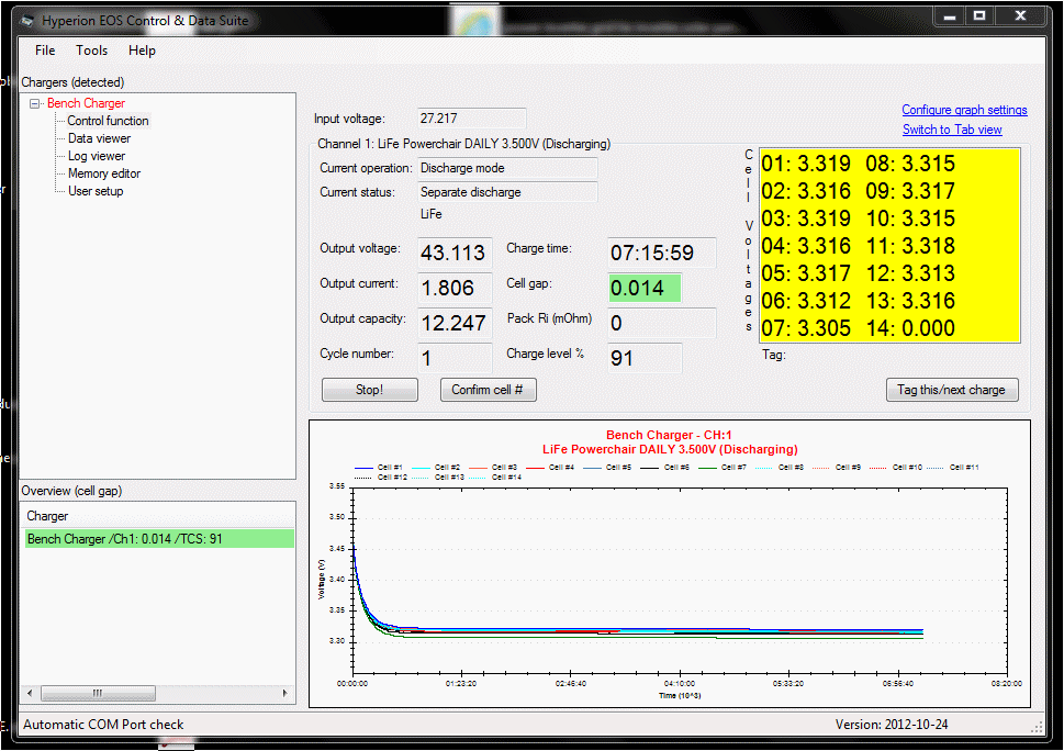

You will struggle to get any sense from an alarm other than at the very END of charge.
There Is more difference between different cells, than voltage drop due to discharge over around 85 percent of the charge.
Set to say 2.5v it may/may not start going off under load regardless of charge - depending more on load/resistance than state of charge.
1.8 Amps discharge for 7.5 hours here. Looks much the same for the first 15 hours...
Lowest cells are still better than highest cells everywhere!
Posts: 70148
Postby g7pvs » 24 Mar 2013, 22:31
I'm not using the Hyperion to discharge the battery.
The alarm only sounded when the batteries were under lots of load i.e. 10 degree slope.
The recharge process had reduced the current to 0.1 Amps when I posted - now at 0 Amps (still 8Ah).
I'll wait until I've discharged the batteries under normal use, then I'll see.
Best Regards
Trev
g7pvs
Posts: 110
Postby Burgerman » 24 Mar 2013, 22:52
It doesn't matter what actually discharges it. The point was to try and explain that the cell voltage is constant. It does not drop as it discharges. All day long. Voltage will not tell you how discharged a pack is. Until it really drops off a cliff right at the end.
It falls in proportion to load (regardless of charge.) But doesn't drop significantly for almost the whole charge.
And it falls INITIALLY in the first few meters.
And it falls fast right at the end as the pack becomes exhausted.
The bit between 99 per cent full, and about 85 per cent used, stays much the same.
In other words the only thing that the voltage (alarm) can tell you is that the pack is completely empty, or that you are going up a hill. It cannot tell you if its 50 per cent, 20 per cent, 75 per cent used up. Because individual cells in a pack vary by MORE than the difference between almost full almost exhausted.
So you will need to set it to around 2.3 to 2.5 volts. Then it will reliably tell you when its empty. It cant tell you anything else with any reliability.
Posts: 70148

Postby Fulliautomatix » 25 Mar 2013, 00:54
Yeah! Mine tells me I'm going up a hill...through a kerb cut...over a step...accelerating hard...
I suppose if it stays on continuously when stopped or light running, the battery is flat?
Set at 2.7V...lowest those AOK ones go.

Postby Burgerman » 25 Mar 2013, 03:00
Fit a forward diode. Various types. You lose part of a volt from .3 to .7 depending on type. Then it will only come on when you reach end of charge.
Or connect via a capacitor / resistor that acts to smooth pulses.
