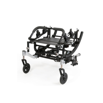

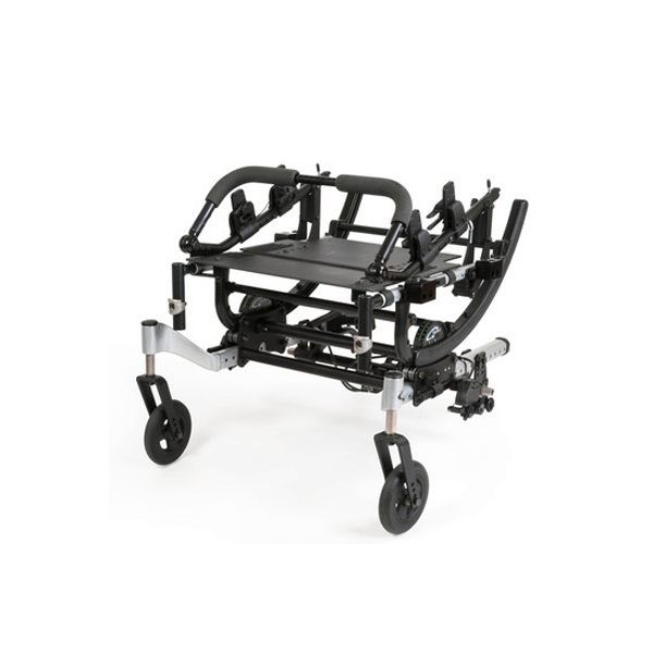

Postby Arima » 23 Feb 2020, 09:48
Posting this as a reminder to myself...or for discussion. I only see 2 basic designs...a tubular frame or a box. One element I like is narrowing the frame to tuck tires within the boundary edge of the seat pan if you have a seat pan. The folding frame pictured means you would not need to cut to narrow it. Obviously the frame shown is much lighter than the average power chair and there is still a ton of bracing fabrication and detail to be engineered. Just a half baked brain fart I have not thought through.
One huge challenge is determining my needs...trying to build one chair to do it all is to really hard for me to think about. Everyone has unique needs...this would be an indoor chair that doesn't scare people from getting near you. Would be nice if it could go to the mall I suppose...and drive from the chair. Something like the lightweight Hawk or Eagle folding chairs which also interest me.
What would happen if you bolted some lighter 2 pole motors with a gearbox to a frame like this?

Postby Burgerman » 23 Feb 2020, 13:23
You would get a weedy chair with little torque, zero suspension, the rear would be way too low, front casters will snag and bounce off every edge and jam in every place they can as you drive till something breaks. And you wont have space for big enough batteries. By the time you fixed all the problems, it willlook like all the other powerchairs do. Guess why they look that way. :D
Thats what they did in 1950. Then they adressed all the issues over the years...

Postby Arima » 23 Feb 2020, 21:49
Okay so tube frame is preferred to a box. In case we need a tilt version. I'm sure you're right about the casters.
