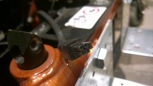

New motors! I got AMT SRG0410 motors with the frame. Used only few hours for demo purposeses. Lucky go incidence.
There is an extra cable coming from end of motor. Also the extension of motor looks different than pictures i have found from internet.
Could not find proper manual for this engine type.
Any one has idea is it cooling system or what?
