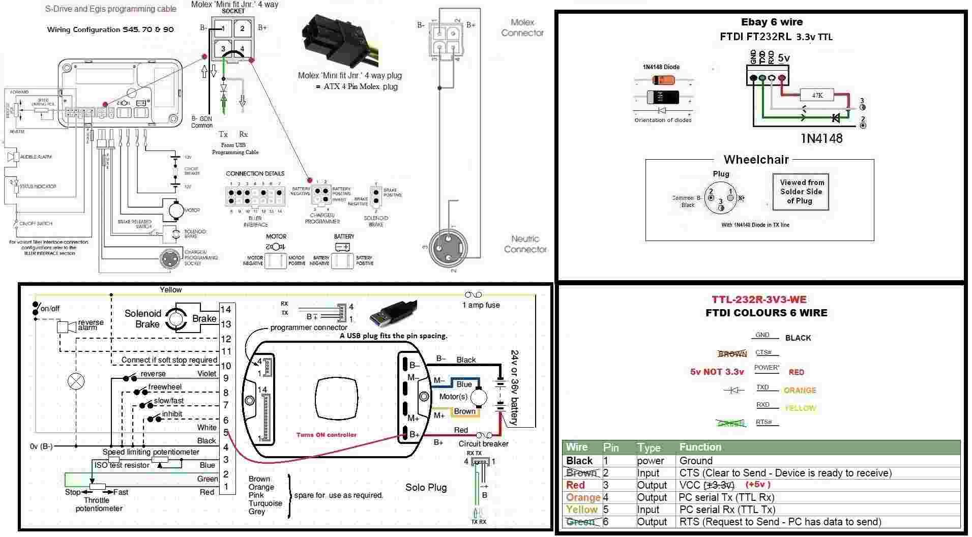

Programming cable specifically for S-Drive controllers
Re: Programming cable specifically for S-Drive controllers
Postby woodygb » 31 Mar 2018, 19:45
Pop over to this thread for an update on making cables.
viewtopic.php?f=2&t=2111&start=1160#p117017
Postby Digipro » 03 Apr 2018, 00:32
Thanks woody have been and downloaded the diagram and will start to get the parts needed for the cable. May I ask does anyone know where I can track down the software to program my s-drive for when I get the cable all made up ?.

Note:- The cable build diagram has altered slightly ...the 47k resistor is now 33k.

woodygb wrote: Note:- The cable build diagram has altered slightly ...the 47k resistor is now 33k.
Hi All,
Huge thanks firstly to WoodyGB and Nick for posting this!

As I have electronics experience I will be able to build this cable and continue diagnosing the problems myself.
My special needs Son has a Monarch Royale 4 with the s-drive 200 controller, can I get the software to check the settings and program the controller please?

You can open up the P.C. Software and select NEW S-Drive profile ...this will load a dummy set of parameters that you can look at.

Hi guys! Really enjoying reading this forum!
Just selecting a USB-TTL cable to reprogram an S-Drive controller, using the expertise shared here by woody and friends!
The FTDI FT232 is universally recommended but quite expensive from Uk sellers.
The Prolific PL2303 perhaps less popular (driver compatibility issues?)
But what about the Winchiphead CH340? Anyone tried that one? It doubles-up as serial EEPROM programmer too! https://www.mpja.com/download/35227cpdata.pdf
And finally the lesser-known SiLab CP2102 USB-TTL bridge adaptor?
Maybe try one of each?! czy :D

woodygb wrote:9 Flash
•••••••••__•••••••••__
There is a fault within the electromagnetic brake circuit. Check all
brake and motor connections. Make sure controller connections are
secure and that the scooter is not in the freewheel mode.
This would make the Scooter STOP and if the parking brake is dragging the motor and brake will get hot.
Yes that was exactly the argument I put forward to the repair company as one of the possibilities for the overheating problem - they had replaced the Elecrtomagnetic Brake under warranty for an other issue and it wasn't until a month after that we had the overheating problem and why I expected them to at least diagnose this under warranty even though it was a month out of warranty by the time we noticed the overheating problem.
Details of Turn Speed Mode are in the manual -> NO... Turn Speed is simply referenced , but what on earth is Turn Speed Mode !?
You are correct, I should not have used the word "details" - it is only a sketchy sentence at best.
My deduction from the words "(2) Take exterior turn-switch as determinant signal,(TRN as control signals)" means that there is a sensor that detects when the scooter steering is turned to a certain amount left or right, and tells the controller that the scooter is doing a turn and sets the motor speed to "L" until the steering is again within the parameters to indicate that it traveling "straight ahead"
That sketchy sentence plus the fact that I noticed on page 21, in the parts listing Item 30, is called 'Speed Sensor', which I think is the sensor responsible for that detection.
