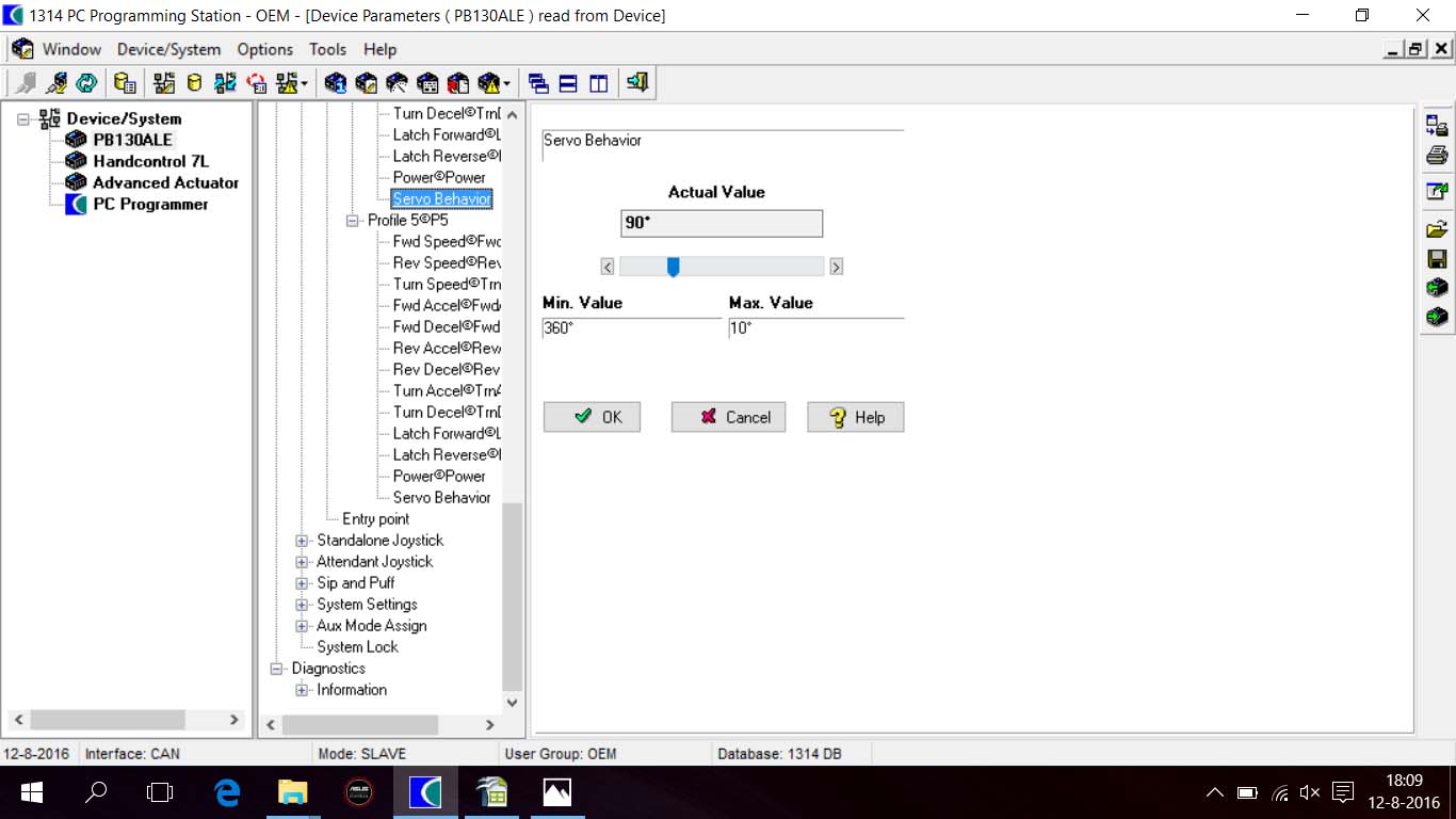

I came across something that I do not understand. I have 5 profiles in which I can define speed, acceleration, etc. Each profile also has a parameter called "Servo Behavior" (it is not a DEALER or SERVICE parameter but an OEM parameter). I do not want to change parameters if I do not know what I am doing, and normally would not have even looked at this one, but I was surprised to see that the value for profile 5 is different than for profiles 1-4.
Overview of all 5 profiles:
Details profile 4:
Details profile 5:
Does anyone have any idea what this parameter does and why the value is different for profile 5?
Thanks,
c500user

Re: Programming Otto Bock C2000
Postby Burgerman » 12 Aug 2016, 22:01
No idea what that does. But does you chair have powered casters?
One thing you don't mention is the turn acceleration. Turn Deceleration. And Minimum turn acc and minimum turn deceleration. Normally this needs setting from whatever ridiculous low figure they choose to 100 for all 4 settings. Then it steers when you tell it. And it STOPS turning when you tell it. But is your chair uses casters that are powered to steer, then those settings may be different or not exist and that servo setting may be instead of. Of course I could be talking bollox. :lol: But I don't really see what you can.
And your chair is really a scooter. With funny steering. So I suggest you watch to see the affect of servo max and minimum settings. It probably speeds up the steering delay and 'stop steering' now, delay too...
Postby Burgerman » 12 Aug 2016, 22:12
Yes I think. See above. The problem is going to be that its a fork lift truck layout. Steers from the rear -- and that's unstable from a basic chassis layout arrangement... Getting it to steer faster may make it swap ends or be hard to steer at speed because its going 'backwards'...
Posts: 71117
Postby c500user » 12 Aug 2016, 22:35
Burgerman wrote:Yes I think. See above. The problem is going to be that its a fork lift truck layout. Steers from the rear -- and that's unstable from a basic chassis layout arrangement... Getting it to steer faster may make it swap ends or be hard to steer at speed because its going 'backwards'...
No, mine is RWD with servo steering at the front. None of your FWD jokes apply, haha.
Not sure why the servo parameter value would be different for profile 5 compared to profiles 1 through 4. The parameter is not listed in the C2000 manual.
BTW, I set turn acc and dec to 100% earlier, you can see it in the screenshot.

Postby Burgerman » 12 Aug 2016, 23:52
But what does it do?
Posts: 71117
Postby c500user » 13 Aug 2016, 00:13
Well, that's what I was asking. I have no idea what it does and I don't want to change parameters I don't understand. Recipe for disaster, haha.
I would like to know if the fact that the values in profiles 1-4 are the same but in profile 5 is different is on purpose or an error in the way my chair was set up before it was delivered to me.

Postby Burgerman » 13 Aug 2016, 10:48
No doubt on purpose. Experiment and examine what it does by setting it really low, and really high and watching carefully. Then you will know.

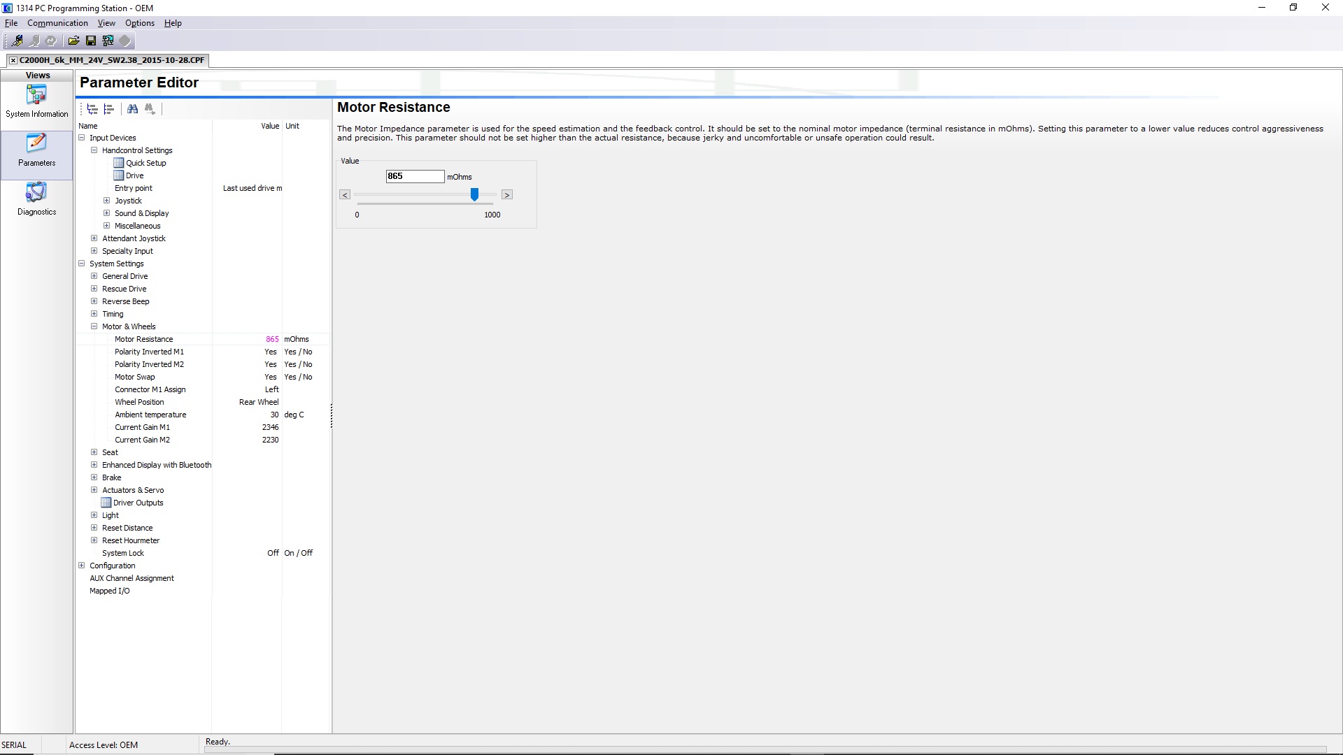

Postby woodygb » 17 Sep 2018, 13:20
What level of programming access do you have?
Postby woodygb » 18 Sep 2018, 09:53
the Motor should take 100A+ at low speeds.
Yes... but only if the batteries can supply what the controller is asking for.
There are... as far as I'm aware .. no other parameters to tweak.
Have you measured the battery voltage under acceleration / load with a DECENT meter?
Postby max78 » 18 Sep 2018, 14:30
I have acceleration and power at 100 and Ohm’s as high as possible (80)
(I don’t have a programming cable, it will take some time to get the adapter)
For the first 0,5s the controller isn't asking for 100%
In the programming tool there are only a few parameters (Motor and Wheels), if you look with wordpad there are much more in the file (C2000F_...).
I think you need a higher access Level.
There are some sample files with more settings…. (Q-Logic), but you can’t change with the tool.
Postby woodygb » 18 Sep 2018, 15:04
max78 wrote:I have acceleration and power at 100 and Ohm’s as high as possible (80)
http://www.amltech.co.nz/programming.html
What level is your handheld ?... 1313-4331 is the OEM level
The OEM level of the PC Programmer shows an Ohm's setting MAX of 1000.
Postby woodygb » 18 Sep 2018, 15:53
80 mOhm appears to be the standard setting.
Postby max78 » 18 Sep 2018, 16:11
Sorry what I wrote was a bit confusing.
My configuration is 80 Ohm. I can set higher, but then the wheelchair is choppy and I didn’t gain much power.
Yes. OEM level.
