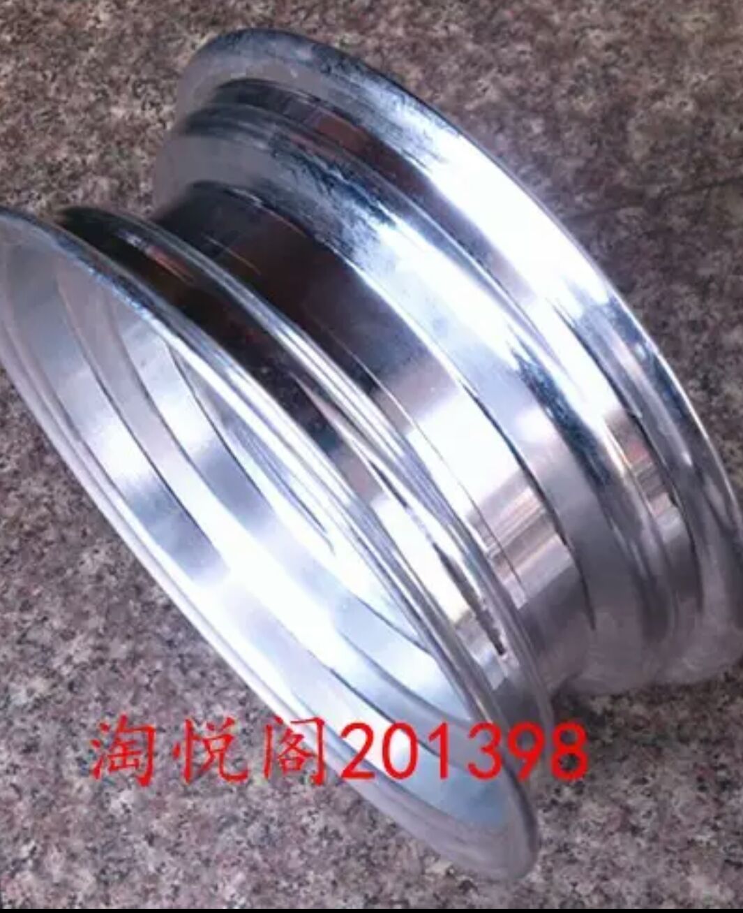

http://www.j-mart.biz/j-parts/index.php ... ts_id=3707
I need ONE wheel G-craft 8 x 5.5J plain and...
One x wheel G-Craft 8 x 4J plain.
Each wheel gives me a left and right half rim.
So making the brushless motor wheel rim 8 x 4.25 wide and 3.25 wide.
One for W I D E stretched 120/70 tyres, one for 110/80 on the xplore chair.
And with both motor/rim sealed should be OK tubeless.

Postby Burgerman » 03 Feb 2017, 00:49
Thanks!
Not symetrical... So will need 2 rims! :x
http://www.gm-moto.jp/item/mky-00121/
Maybe they have the flat ones no holes that I need.
Posts: 71104
Re: Brushless eBay!!! Bought.
Postby shirley_hkg » 03 Feb 2017, 03:40
No fruitful result .
3.5j for 8 inch / 4.5j for 10 inch . :cry:
I guess my mechanics can lathe one from a aluminum block , estimated £50 for one half .

Alternately , cut this apart , and put an extra ring section to extend to your desired width . Weld them together , lathe the slot for rubber seal, and redo the finishing .
That may be even better and costs less .
This costs £12.00 a rim .
Wait till you received the 8” rims and confirm them fit for modification .
Postby Burgerman » 03 Feb 2017, 09:45
It wont. The center well, too deep... No room for bolts. Unless I drill 5 new holes in the rotor...
