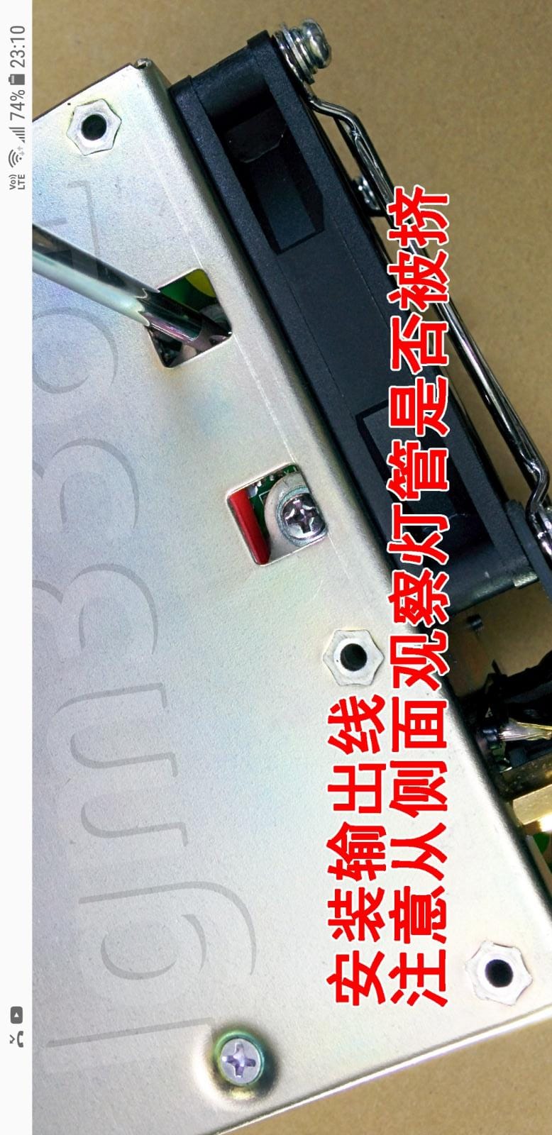

Insert tools here to loose the main outputs .

https://translate.googleusercontent.com ... O_2h0w8c8w
Still can't believe it's compact size! :)

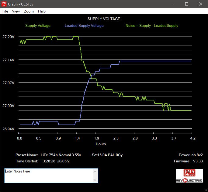

Nope, just the PSU with the mod already done. Been testing it with the PL8 today, set 27v max and 20A max for a 15A charge, seems ok so far...
Postby steves1977uk » 20 May 2018, 17:51
Charge & PSU graph... (Remove .zip as usual!) :)

Postby steves1977uk » 20 May 2018, 18:51
Opens for me as a graph in CCS... Anyway, here's what I was trying to show...

Postby Burgerman » 20 May 2018, 18:59
Saw it. 2nd file download worked fine! Power supply also looking OK. Drops .3V under load. Not marvelous, but acceptable considering the power output and the price! Good enough for a charger. Probably a bit dodgy as an accurate bench supply. But for most purposes its fine.

Postby Burgerman » 20 May 2018, 19:11
Your charger works by switching power ON/OFF at high frequency. What you are seeing on that screen is the loaded (pulling power) and unloaded (not pulling power) at whatever frequency the PL8 is set to.
You can choose:
125 Khz
62.5 Khz
31 Khz
The lowest frequencies are the greatest efficiency. As in less wasted energy. But that requires the biggest components in the charger. As for eg capacitors. So this is only allowed at low currents. So small batteries, or slow low amp charge rates.
The highest frequencies are easier on the charger. And the power supply. Since the on/off times are shorter. So the charger can use smaller components, and still charge at 40A. It also usually means a closer match between supply on/off states. And is kinder to the power supply.
Just so you know what you are measuring. As usual, everything is a compromise! 40A charge requires higher frequencies, and is less efficient. And 2A requires the lowest frequency for best efficiency. If I make a charge profile with a wide Amp range, say 1A to 40A then I choose 62.6khz. If I make a profile for a small battery at say inder 3A I choose 31khz. Etc.
Your graph shows that at high currents voltage falls. And at low currents it is actually higher than the unloaded setting. And so crosses over. So it would likely perform better with a huge very low impedance capacitor in the output. But its fine as is.

steves1977uk wrote:https://translate.googleusercontent.com/translate_c?act=url&depth=1&hl=en&ie=UTF8&prev=_t&rurl=translate.google.com&sl=auto&sp=nmt4&tl=en&u=http://diy.lgm3361.com/zxd2400/3/&xid=25657,15700023,15700124,15700149,15700168,15700186,15700189,15700190,15700201,15700205&usg=ALkJrhiEpGE3pPSx2zOTsvypO_2h0w8c8w
Great job by Steve . cheers :worship

Postby shirley_hkg » 21 May 2018, 14:43
Burgerman wrote:What did he do? :shifty:
Translated the mod pages. :worship :dance
Postby Burgerman » 21 May 2018, 14:55
Yes I figured it out now. Well done steve! Very useful. Now I can calibrate exactly! And understand how it works.
Posts: 70452
Postby steves1977uk » 21 May 2018, 15:09
:mrgreen: beer cheers
Postby Gnomatic » 21 May 2018, 23:13
Thanks for the translation link, Steve. I'm sure I'll still have questions anyway LOL. :thumbup:
