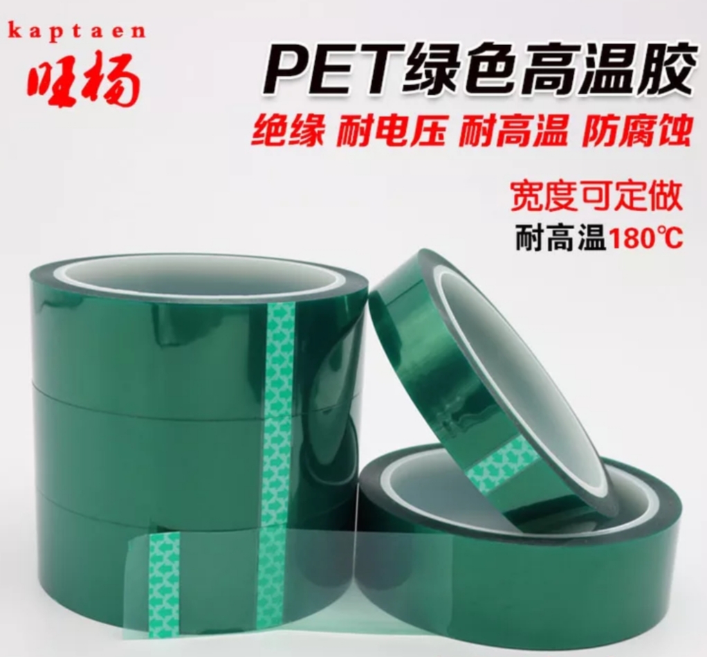

Postby expresso » 30 Jun 2018, 01:53
Green PET Tape High Temperature Heat Resistant For Soldering BGA PCB
cant seem to find this here unless i want to wait till August to get it delivered -
what can i use to wrap it instead of this that is just as good and i can order it here in the states and receive it in a few weeks at least is ok - but amazon tells me delivery will be in a months time - not looking to wait that long - even though by the time i get around to wrapping it may be a month -
in the event it am ready to wrap it earlier - i want to have it here ready - being that my Main lithium chair is out of service for time being - i feel very limited without lithium now -
and excited to see how this 60ah ADD ON will do - in terms or range - i managed about 25 miles with a 36ah ADD ON - this is almost double
maybe 35 miles ? that would be great if i can get that much out of it -

Postby shirley_hkg » 30 Jun 2018, 07:10
Our stores have numerous . A roll of 4'' @33m high temperature 280℃ tape is $6.50 US.

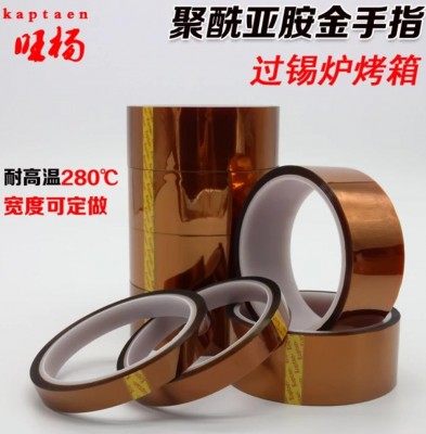

Postby LROBBINS » 30 Jun 2018, 08:28
Espresso,
Try searching (e-bay too, and perhaps electronics suppliers) for Kapton tape - that's a brand name, but people may use for listings that instead of the generic PET name. Most of the e-bay listings will be from China or nearby, but there are some in the U.S. too.
Postby expresso » 30 Jun 2018, 15:42
shirley_hkg wrote: Our stores have numerous . A roll of 4'' @33m high temperature 280℃ tape is $6.50 US.
Thanks - i just ordered it from Ebay - it shipped already - coming from HK - i got the larger roll wider and it was cheaper than amazon here - i figure whats the rush - i wont be ready by then anyway most likely and i should have it by end of this month July -
https://www.ebay.com/itm/200mm-x33m-100 ... %7Ciid%3A1
this would wrap the whole pack bottom and sides - then i have to cut and trim to fix the top etc, dont think mines will come out as pretty as Snakers pack did -
Can i cover the middle relief value on the Cells ? or do i need to leave it exposed ?
Postby expresso » 30 Jun 2018, 15:45
LROBBINS wrote:Espresso,
thanks and your right - i just checked it on Ebay and they have it here - but i already ordered the large roll - coming from HK - its ok i need some time to do the wiring anyway - dont have the same help as i had when i built my full pack - no sure rushing
but i may buy some of that also - smaller size could be useful
https://www.ebay.com/itm/40mm-X-100Ft-G ... xyUylTQfxK

Does this Tape stick to itself or do i need to get Tape to hold it in place ?
i got some of this on the way - hope it works to hold it in place
Postby Burgerman » 30 Jun 2018, 16:04
Its sticky one side. Hard to cut, needs sharp scissors. I use it on model planes to join foam wings. High tensile strength.

Postby expresso » 02 Jul 2018, 02:45
Charging is coming alone pretty fast - tomorrow i will be doing the last cell -
i wrapped up the bottom of the Cells also and top a bit - since they are exposed on the bottom - i feel better this way - till i start to wrap it better
looking over the connectors - the wiring will be very short runs - not sure i can bend it like a loop or try to make it straight from one cell to the next
i measured the wire will be around 3 inch long - will have to see if can add the ring ends on such short wire -
on the top of the Cell - theres the little pressure relief i believe is what its called -
When i wrap the whole thing with the PET green tape - Can i cover that pressure relief tab in the middle of the cell also or do i need to leave it exposed for it to do its job in the event its needed ?
