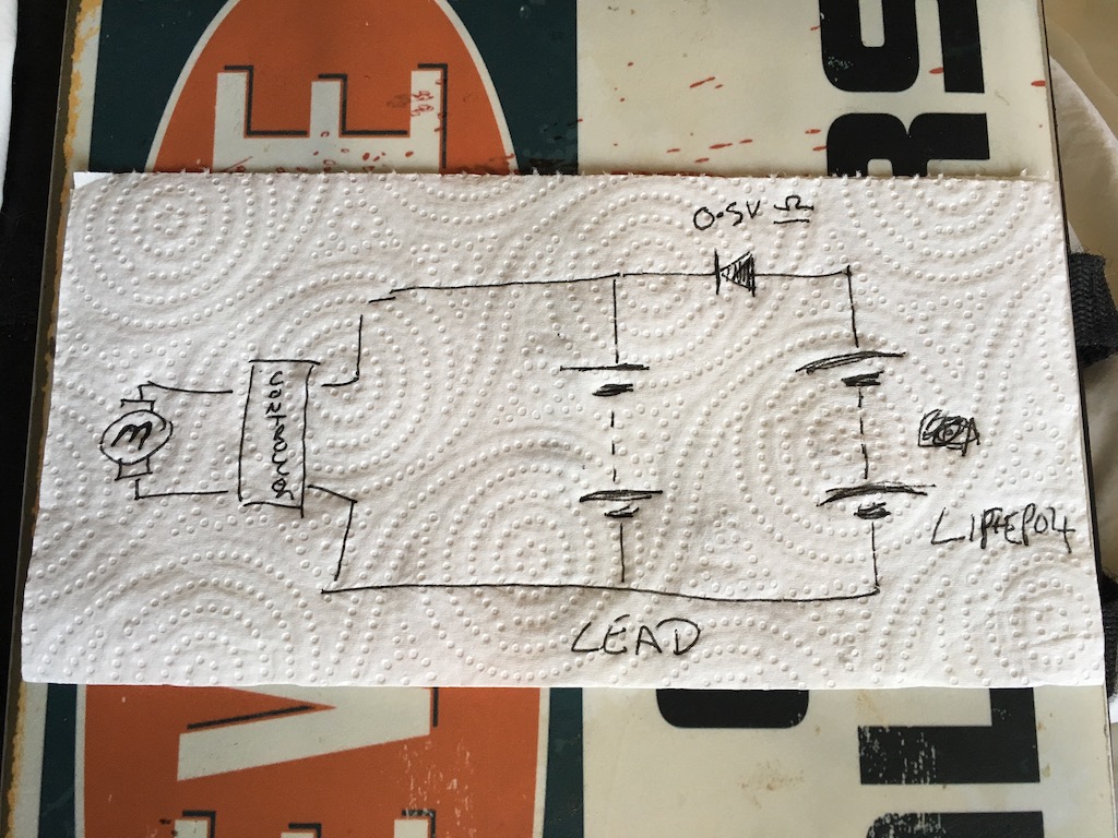

Just for clarification is this where the diode is placed?

Scooterman wrote:Just for clarification is this where the diode is placed?
BM can explain this better - i took it from him - the diode only flows one way and it can only be placed in that one direction. depends what diode it used - you would have to first know which direction is correct and then place it in line in the correct fashion. in my case with the diode i used - recommeded by BM - i placed it the way he told me since i wasnt sure which direction either.
my diode has 3 spike ends and that end is the direction of the flow - discharging direction out of the pack is the direction the 3 spike end of my diode is facing. - hope that makes some sense - if not BM or someone will explain it better than me - i am just like you learning as i go :clap:

Postby Burgerman » 10 Nov 2018, 18:05
Yes, and now you know what a diode does!

Postby Scooterman » 10 Nov 2018, 18:29
Burgerman wrote:Yes, and now you know what a diode does!
:thumbup: :D
I never realised that diodes have an internal resistance. But I suppose going by that all semi-conductors do. Just as copper wire, batteries and everything else electrical/electronic does.
And that's where super-conductors come in!!!
see, I'm learning all the time, (with your help) :D
EDIT: RE the diode I should have probably said drops voltage across it. Because as you said the voltage drop stays constant over a wide current range whereas with a resistor is doesn't VD = I x R. And that is why a diode is used and not resistor.

Postby Burgerman » 10 Nov 2018, 18:50
Well pretty constant across a rtange of currents. You need to select the right diode!
