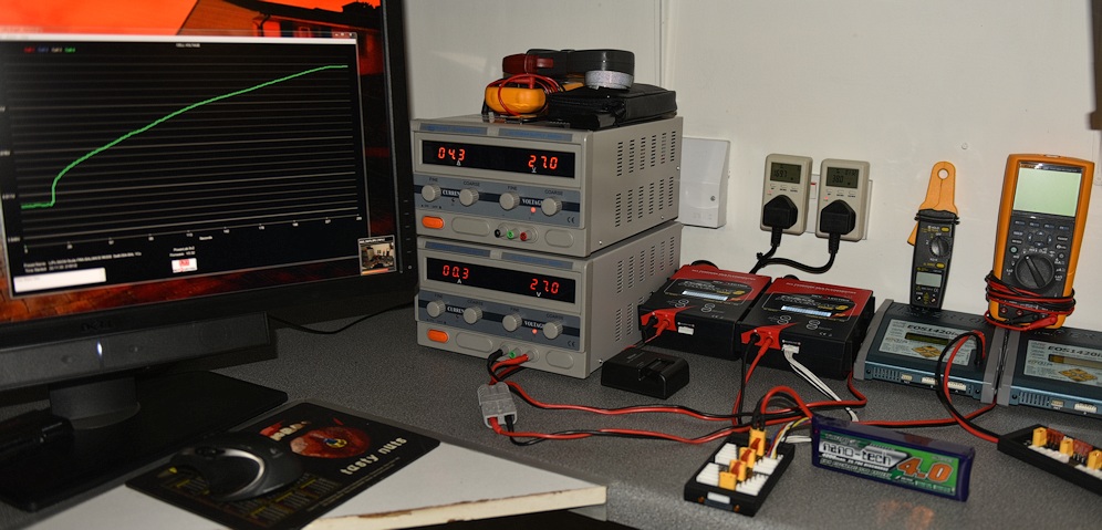

Heres my usual charge setup that is run at max power with 2x 1200 watt power supplies at once and at 40A to charge a 13S (6S and 7S) split pack
http://www.wheelchairdriver.com/BM3-con ... on/PL8.jpg Normal 13S setup with 2x 1200 watt isolated supplies.
Typical battery: This is 120Ah 8S and 5C charge compatible. So 40A just tickles it! Still takes 3 hours and a half... http://www.wheelchairdriver.com/images- ... hair-7.jpg

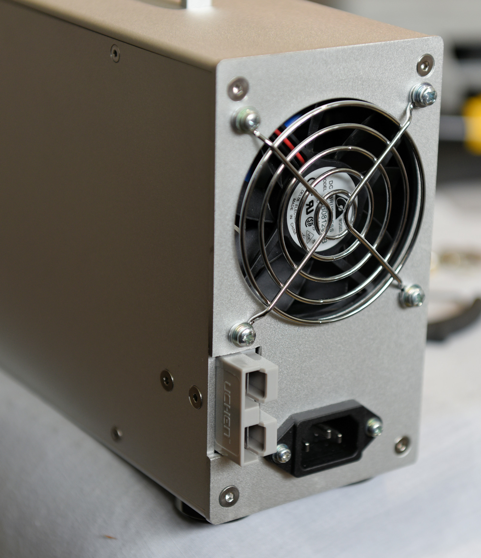

Here is a photo of one of my 2400 watt, 12/24 volt units. Bit smaller than the lab PSU's.
EDIT BURGERMAN, I MAY HAVE MESSED UP YOUR POST A LITTLE IN ERROR... WHAT CAN I SAY. IAM AN IDIOT! :cussing
No picture?

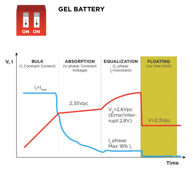

I was wondering about that. I was looking for something definitive on their site, like that chart and diagram you attached earlier. I wanted to show someone that a manufacturer says that voltage above 28.2 for a 24v system would be bad for it. All I found was their retail / promo material which says up to 14.6. Do you have a link to the technical stuff on their site? Or is it behind a wall?
Even on this FAQ which says gels never need to be equalized (in the "Broadband/CATV Questions" section for some reason), it says "The correct charging voltage for a Gel battery is 14.4 to 14.6 volts maximum at 68°F."

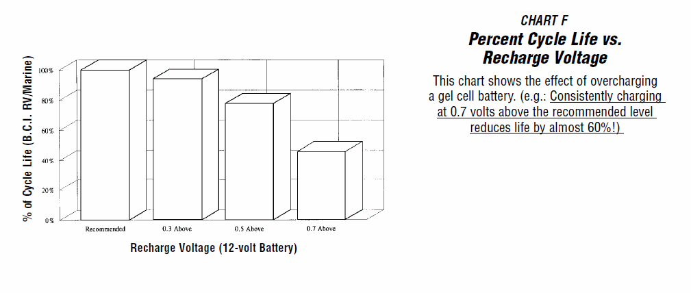

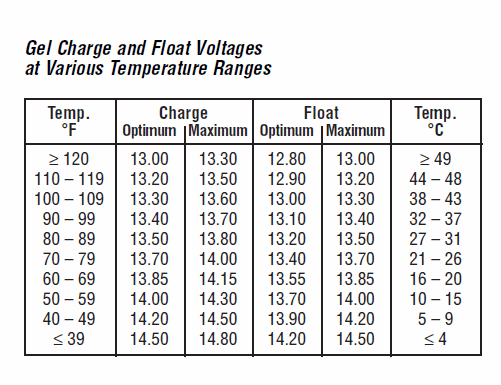

Postby Burgerman » 22 Nov 2018, 20:17

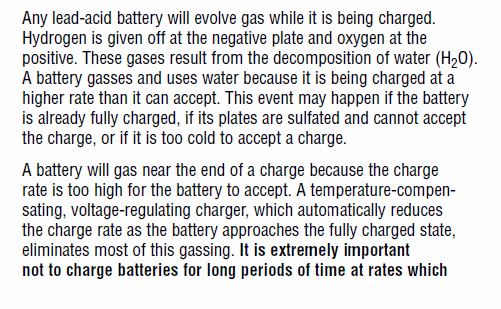

Theres a massive difference between what WORKS, as in sell sheets and written on a battery. And what is best for longevity and cycle like. They want to offer a wide voltage range. Because otherwise they lose sales.
Chargers... Almost every mobility charger claims to be universal and that they can charge AGM or Gel, or any sealed battery. They do this with the CC/CV and sometimes float algo. So 2 or 3 stage. And they all charge the MK at too high voltage. Typically 14.4 to 14.6 or even 29.2V per battery. So they charge at too high voltage. Its perfectly true, you CAN charge these at 14.6V as long as you dont care that it reduces service life very markedly.

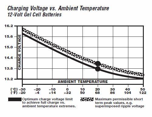

See the chart on here showing the result of charging above the recommended voltage! You lose 60% of the battery service life, by charging just .7 volt too high. And the correct voltage is 13.8 to 14.1 MAX at 20 degrees C.
So ideal voltage would be 13.95V.
That means that charging at the typical 14.5V per battery, is over-voltage by .55V at 20C. And by .75V at 25C! And by even more in summer at 30C... Remember that this means your battery has just 200 to cycles instead of the claimed 500! So 8 months heavy deep cycle use. Instead of 17 or 18 months!
Whats more almost all of these chargers tell you its charged after say 8 hours overnight with a green LED. Well its not! To fully charge, and so fully return all of the sulfates back to the acid, requires 12 to 16 hours minimum in cyclic use. Again MK shows this clearly here: http://www.mkbattery.com/pdf/mktechm.pdf
So they lose more life through sulfation.

Charts from MK for gel...

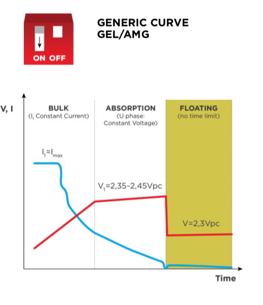

I got some charge curves back from the Italian charger company that has the relatively lightweight 24v 12a charger. Not very scientific but it looks like the gel curve has about the right voltage, but then does the unwanted higher voltage after CV. The generic gel/AMG (AGM?) curve doesn't have the higher voltage phase, but the CV stage looks too high for gel.
Just out of curiosity I asked if they'd do a custom curve. They said they could for a VAT registered company, in conjunction with their UK dealer, if there was a commitment to buy 50 units. And they also said the 12a charger would not be made any more, so it would have to be 10a or 15a. So I guess I won't try to start a business to sell the perfect 12a 24v charger suitable for travel since it won't exist any more. 15a might melt things with an XLR connector and 10a isn't that much of an advantage over 8a to make it appealing.
I suppose if I got the existing 12a, I could use a diode to lower the voltage of their generic curve and it wouldn't be harmful. Then the float would go down a corresponding amount, but maybe that would be good too.

Postby Burgerman » 26 Nov 2018, 01:45
Dont buy that. Their CV stage is not constant! It is supposed to be CONSTANT voltage...
And we dont see any mention of the termination point in a time limit sense and they claim its 16% of the charge current which is way too soon. And they dont even get the AGM abbreviation spelling right. It stands for Absorbed Glass Mat separators. That equalization stage is meant for large deep cycle lead storage batteries with WET acid. Not gel. Its designed to mix up the acid by making it gas. Which destroys sealed batteries, and damages gel batteries by making voids in the gel that never heal if you do it regularly. We wont mention that the float voltage for gel is 13.5V at room temp. 13.8 will overcharge it after a few hours. And too high.
You CAN do an accelerated finish, if you stop the CV charge at half the charge current, but unless you know accurately how much was taken out then its inadvisable.

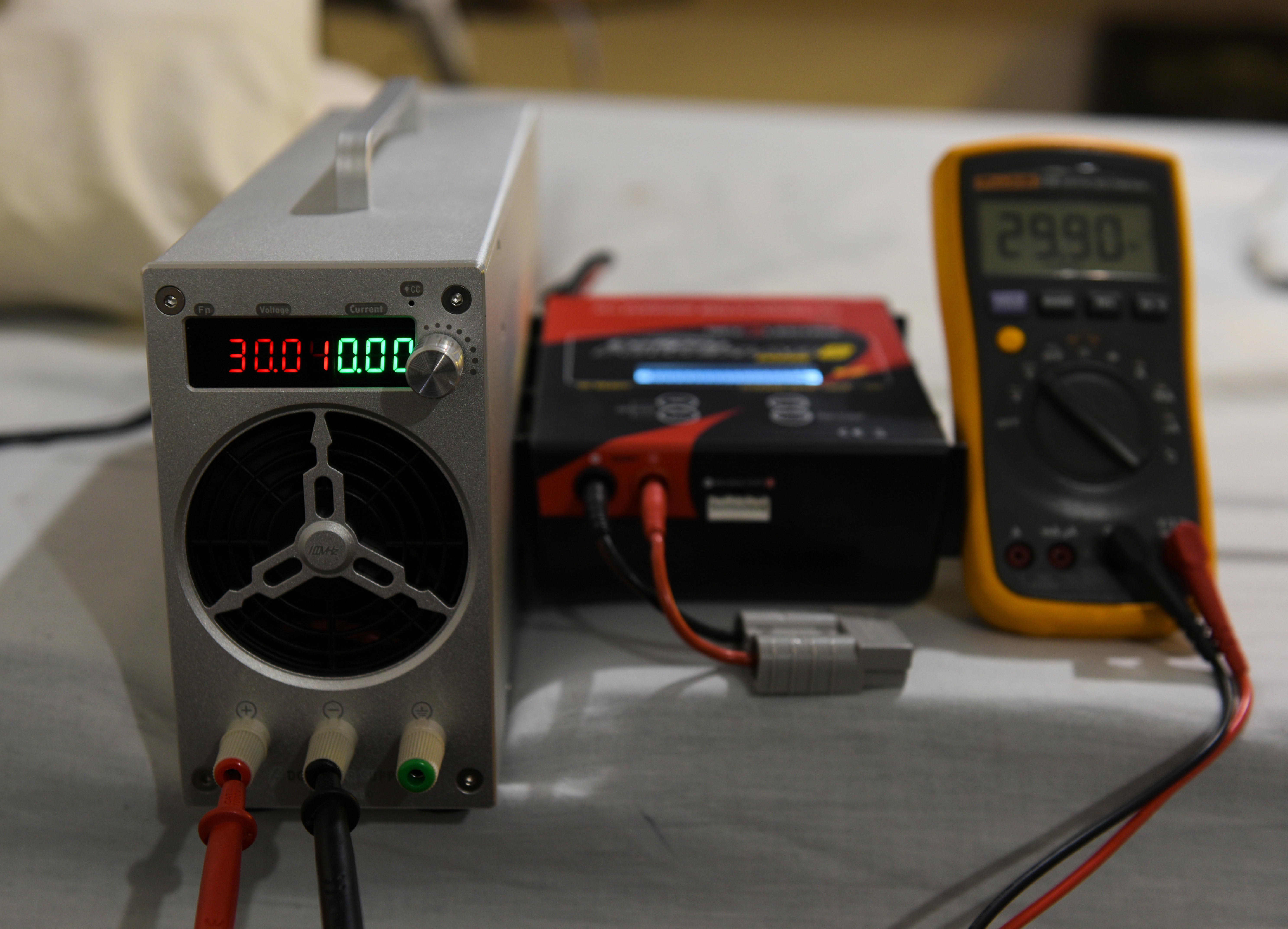

I received the PowerLab8 and FUIM3 from revolectrix (£26.51 import tax + Fedex fee). I also got the power supply with EC5 connector and a custom XLR - Banana plug cable I ordered from Coolice. That was everything I needed to connect to my Permobil C500s.

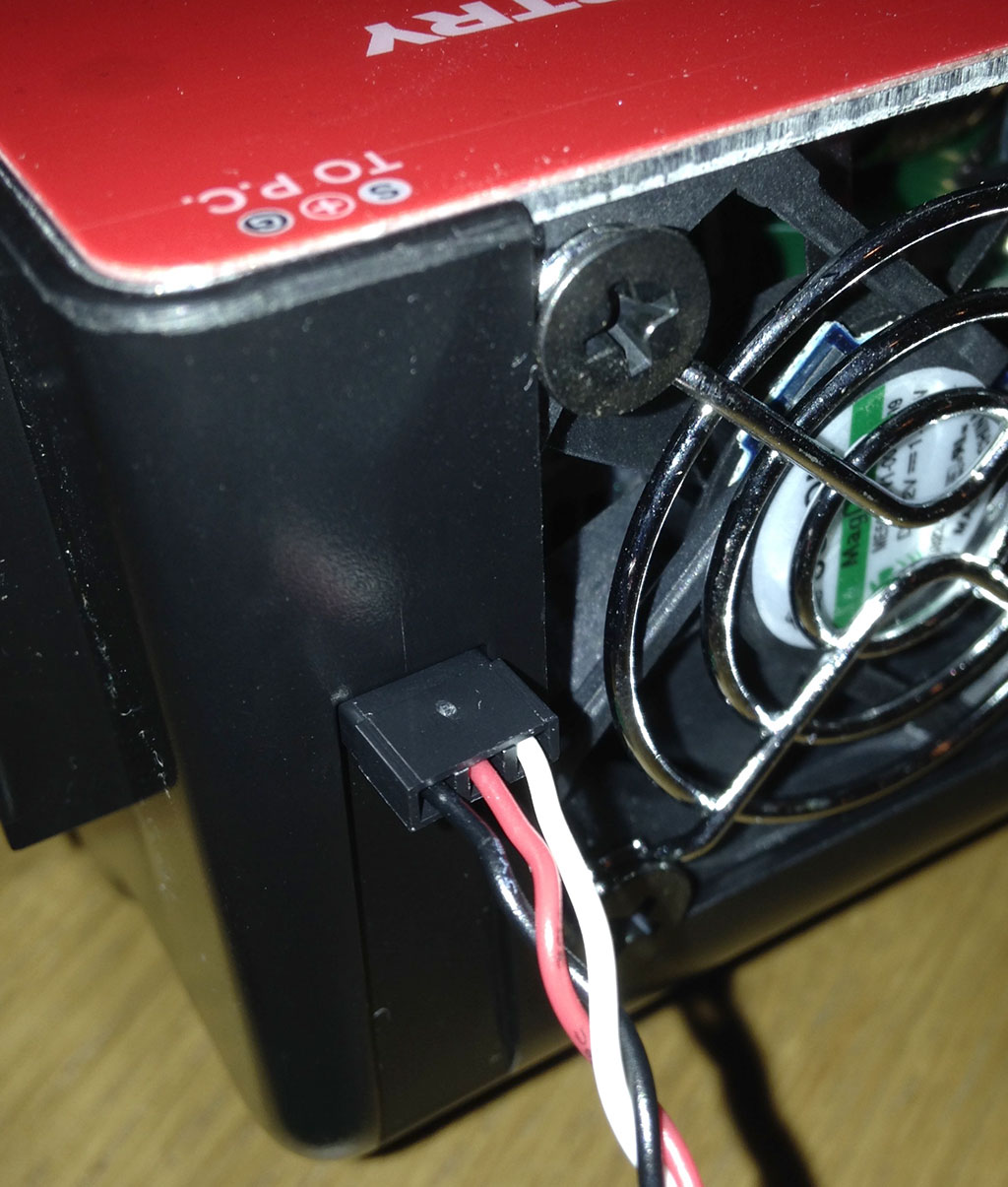

Is there anything on the FUIM3 which indicates which side is up to plug it in to the PL8? I guess I got lucky because it worked when plugged in, or does it matter if it's upside down? Seems like it would physically fit either way.
I downloaded Oracle's free VirtualBox and a Windows 10 iso for a Mac laptop running Mac OS X (10.13) and installed it. I ran the installer for the PL8 v2 software and the FUIM3 usb driver. I set up a USB filter to let the virtual windows talk to the USB port and it connected to the PL8. I played around with the software a bit and got the gel 12a preset to load, then figured out the right sequence of buttons to press and charged at 12a for a few minutes as a test. Seems to work. Thanks Burgerman and everyone for advice and suggestions.
I think I'll get some kind of small wheeled cart, maybe with space for a laptop on top, so the supply and charger can live next to the chair while I'm in bed and be wheeled out for a quick charge when necessary.

jefferso wrote:Is there anything on the FUIM3 which indicates which side is up to plug it in to the PL8? I guess I got lucky because it worked when plugged in, or does it matter if it's upside down? Seems like it would physically fit either way.
I just found the answer to this question. I took a photo of the USB to FUIM3 plugged in to remember which way it worked, and only then noticed the little "TO P.C." "S + G" legend on the top of the PL8, which corresponds to plug hole in the back for the black, red and white wires of the plug.
