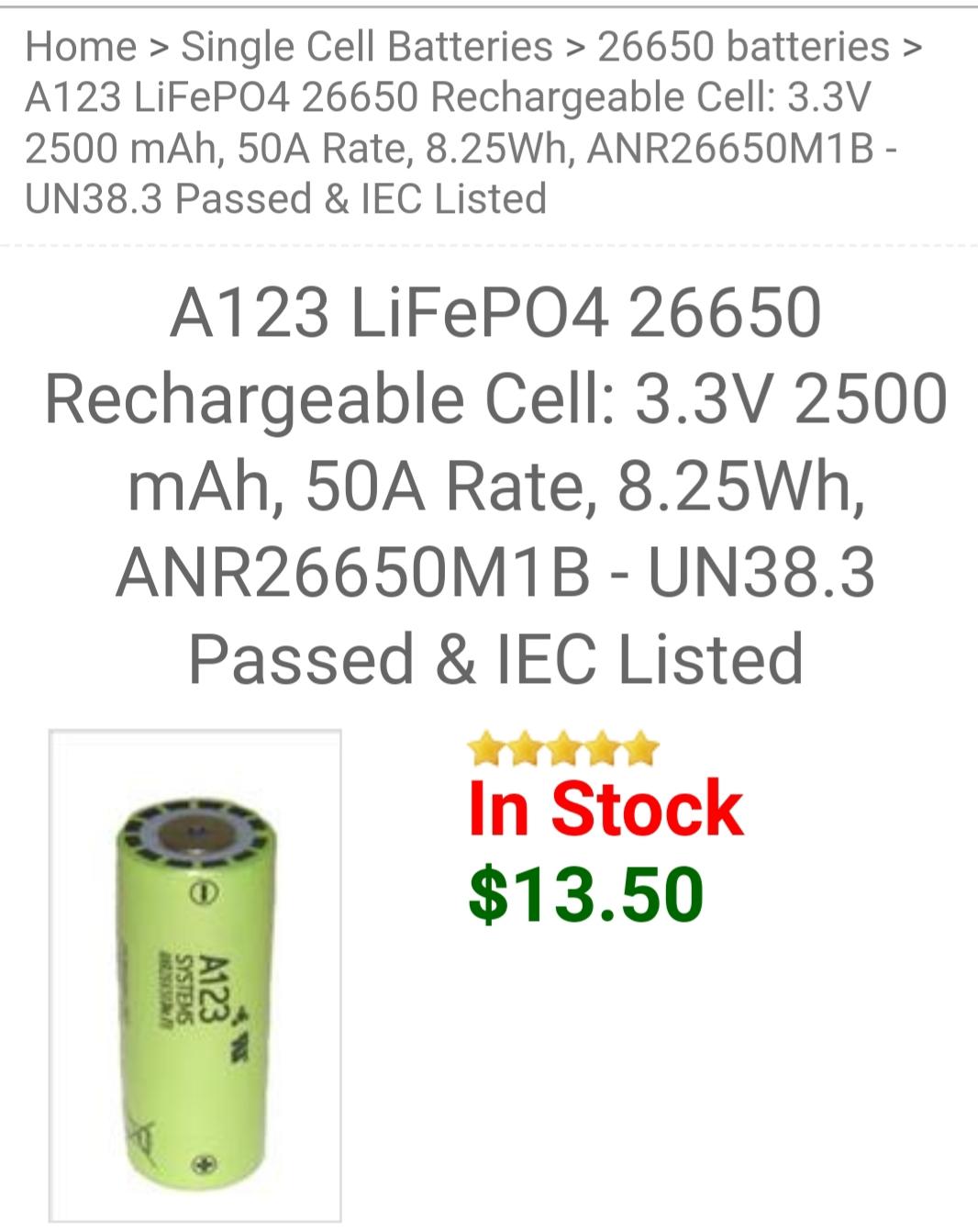

Postby shirley_hkg » 07 Jan 2019, 02:27

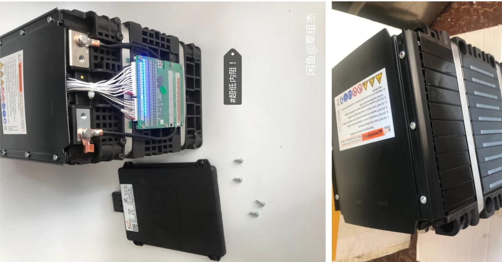

A123 is still the most reliable .
Old stock is still found in the market .
This 5C pouch original factory assembled 12V 200Ah pack costs £350.00

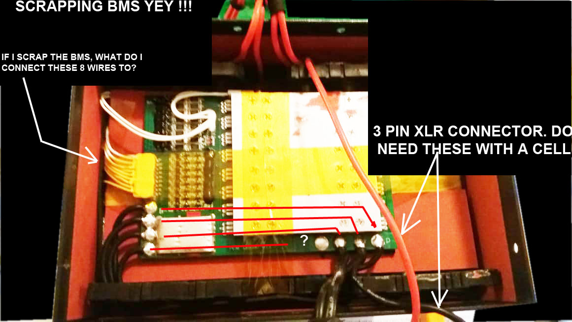

Scrapping the BMS

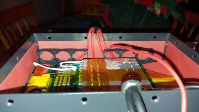

Please can you help me make sense of what to do with these cables pictured below, in preparation for the intelligent charger.

9 wires . Good . That's completed .
Posts: 4479
Re: Can I remove or adjust the BMS in my LiFePo pack?
Postby Burgerman » 08 Jan 2019, 02:38
There should be 9 wires, not 8. Those go to the PL8 balance ports.

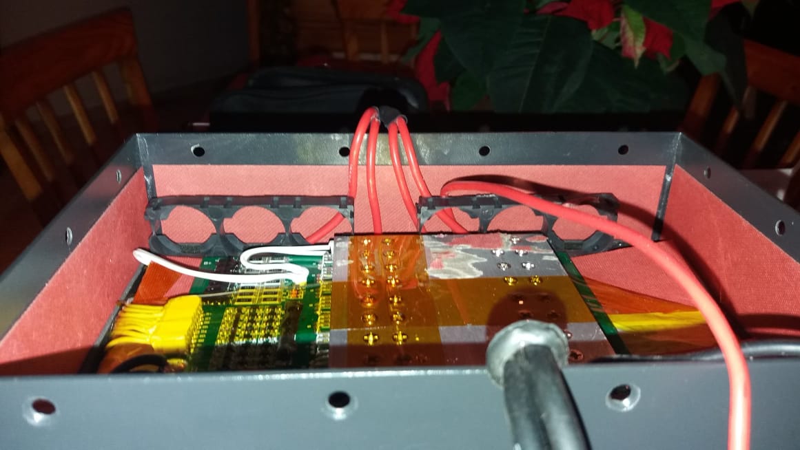

I bought a generic liFePO4 pack for my TravelScoot rated the same 10AH as the official LI pack. When the BMS failed after a few months of use, I undertook a salvage operation. I found 8 series groups of 3 unmarked cells. I removed the BMS board. I had to rework the large power positive & negative leads. There was a series of small wires to the BMS board via a plug in... these are my balance leads. I adapted the balance leads to my smart charger. (I used the now obsolete Hyperion but today I'd use the PL8V2) Remember these wires are "live" so don't short anything. I now have 6 years on this pack & still going strong.
NOTE: I bought a pack of equal power to the OEM pack so my output was similar. Surely maker of the golf buggy have specs for a lead battery option.

Postby woodygb » 10 Jan 2019, 16:49
A count of the wires in the pic gives me 9 ...thus I assume a miscount by Crazy.
Postby flagman1776 » 10 Jan 2019, 18:31
Absolutely YES. An 8S pack... 8 cells (or parallel groups of cells) require 9 balance leads. Whether a BMS or smart charger. Must be a miscount.

Yep! Hands up guys there are 9 white leads and not 8 as I assumed. Where is the best place to buy the PL8v2 with fast delivery. I was told by another member to buy a power pack to accompany the Pl8v2. True or false? If true, what size power pack should I buy. This would be for my 55Ah LiFePo4. I'll use this on the flat, until I get my big mountain going battery pack sorted out (It will take me time to raise the cash.) cheers

Postby Burgerman » 12 Jan 2019, 01:15
While you save, please read this thread as it will answer all the questions, and the ones you haven't thought of yet! viewtopic.php?f=2&t=1813
The PL8 will need a few 36 inch balance cable extensions and a FUIM3, and a power supply.
The power supply can be anything.
The PL8 is 1344 watts. Or 20 watts. You tell it.
So for max power you want a 50A and 24V supply. Such as a dual server supply made for us hobby people, or a quality bench power supply such as the two you see here http://www.wheelchairdriver.com/BM3-con ... arging.jpg
You can also use any 12 to 30V supply from say 5A to 50A or above. Such as the ebay cheap ones.
You will also likely want to make up a chair side charge cable, and a charger side charge cable such as this one here. That allows one simple connection, and plug and go... And its good for 40A charging. So your battery will be done in 1.5 hours from dead flat...

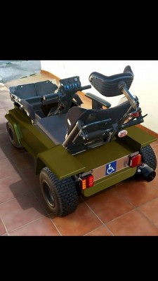

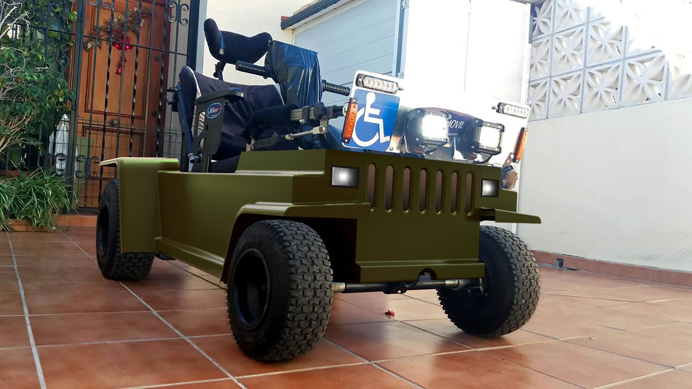

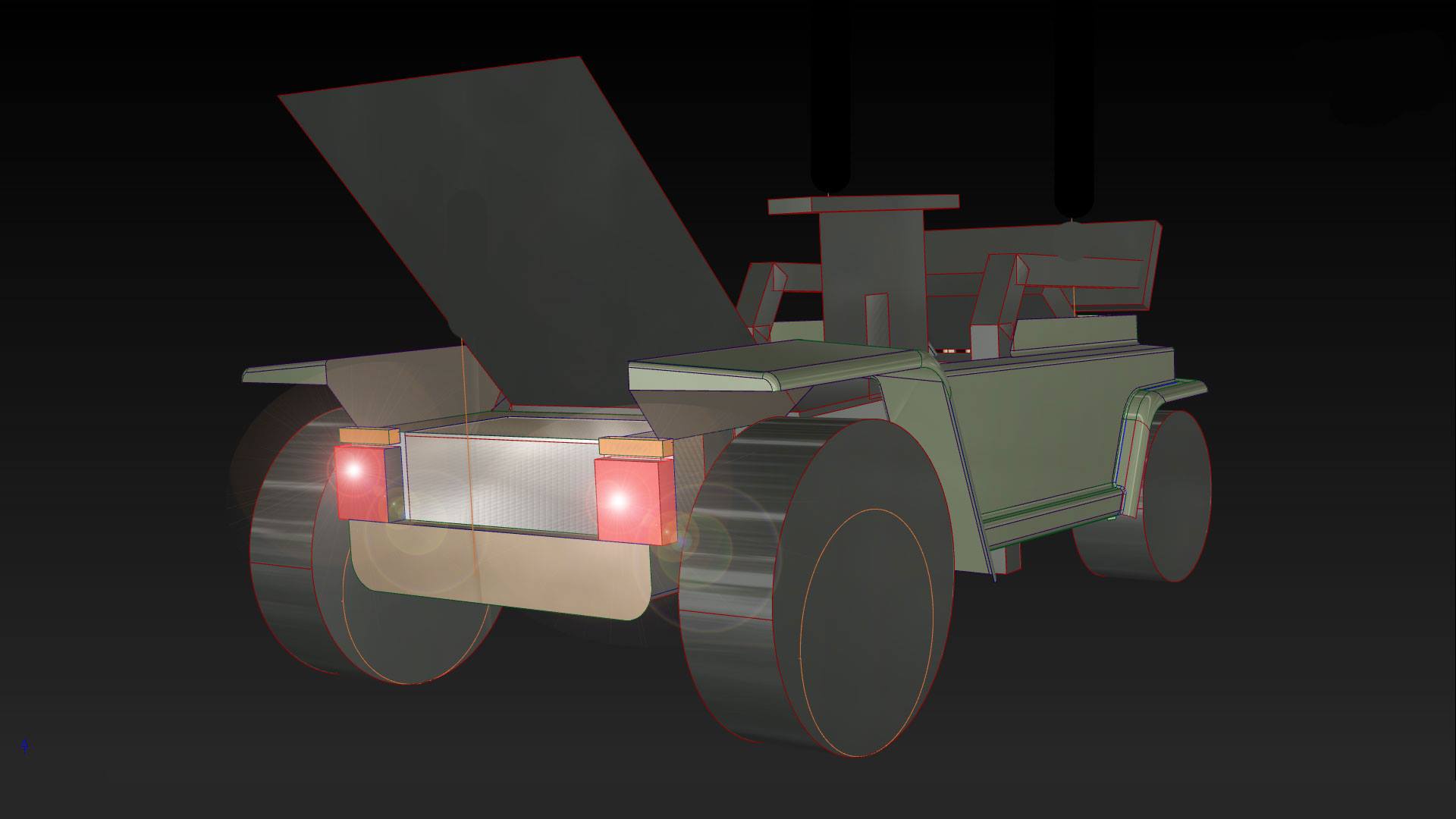

I am having a body made in Atlanta, in return for teaching the guy how to model Porsche body kits in CAD:

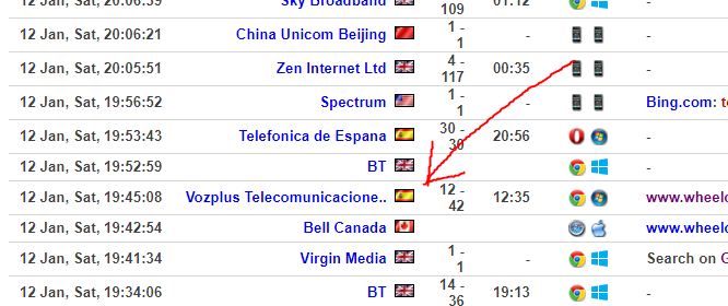

You are correct. His IP address resolves as a Spanish dynamic IP so Spain. I could look up exactly where if it wasn't dynamic and changing. So that wouldn't be very precise.
Posts: 69891
Postby martin007 » 12 Jan 2019, 21:26
This??
