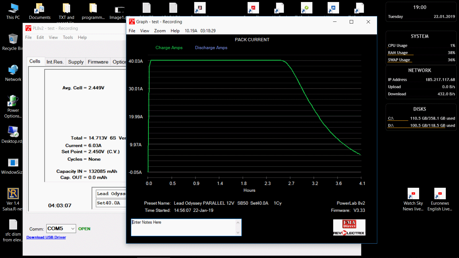

We took out 121Ah. Total discharge 101%.
Charge at 40A and so far we put back 133Ah in 4 hours, and still charging at the same low rate as a mobility charger begins! With an 8A mobility charger that means we would have taken 17 hours to get this far!

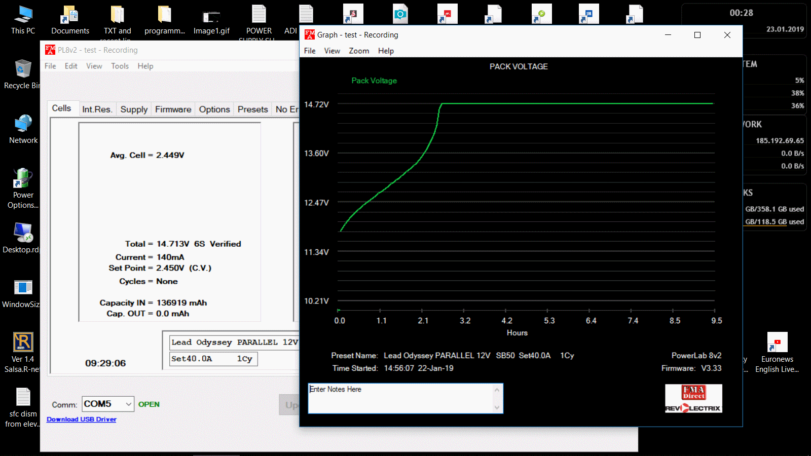

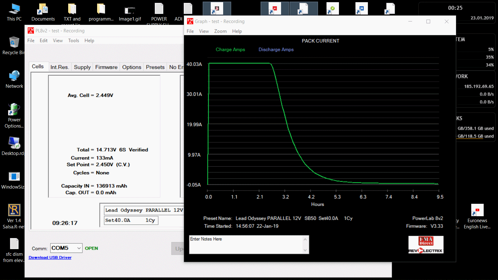

Here we see charger CURRENT at 40A putting the BULK (CC stage) back then gradually falling as the battery gradually sucks up less and less Amps. Eventually it falls to 1000thC or 1000th of the battery capacity. So 130mA.
Here we see the BATTERY VOLTS first the climbing part of the graph, while it is fed 40A (ABOVE!) and the battery volts increase as far as CV stage of 14.7V. And thats exactly where the charger holds the battery until its 100% full... Charge ended when Amps fell to just 130mA.
