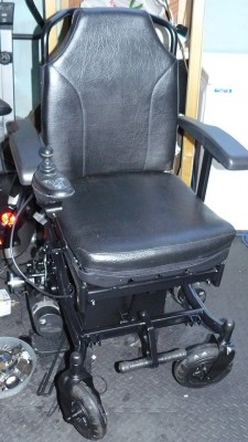

hi all well i had a 3rd reorientation of the motors and have decided its where there staying now and i just have to accept that wheelbase must be 2 inches wider than i was aiming for so be about 26-27 inches but thats ok for the bungalows nice widened doors i did not like either of the other 2 positions its possible to fit motors in so had to restore the same box section mounting and have motor 2 inches more outboard but happy that the mount is sturdy and motors are not endangered by kerbs and clumsy reversing that tina is prone to esp if having a painful day!
so just need to find suitable wheels and new batteries and despite most folks opinions on the leoch brand i have been pleasantly surprised with the set we fitted on tinas chair they was fitted mid 2016 and have done minimum of 6 miles a day and max of 15 and still in great working order,following bms advice on charging def helps and also a very good charger but im maybe just been lucky idk so must decide at some point if its worth another set of leochs or save for an age for mks again?
was reading bms post on batteries and the haze ev batteries are not so expensive ,anyhow heres a few pics of progress,peace

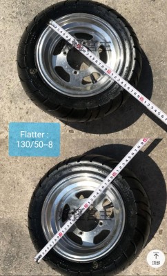

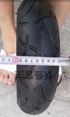

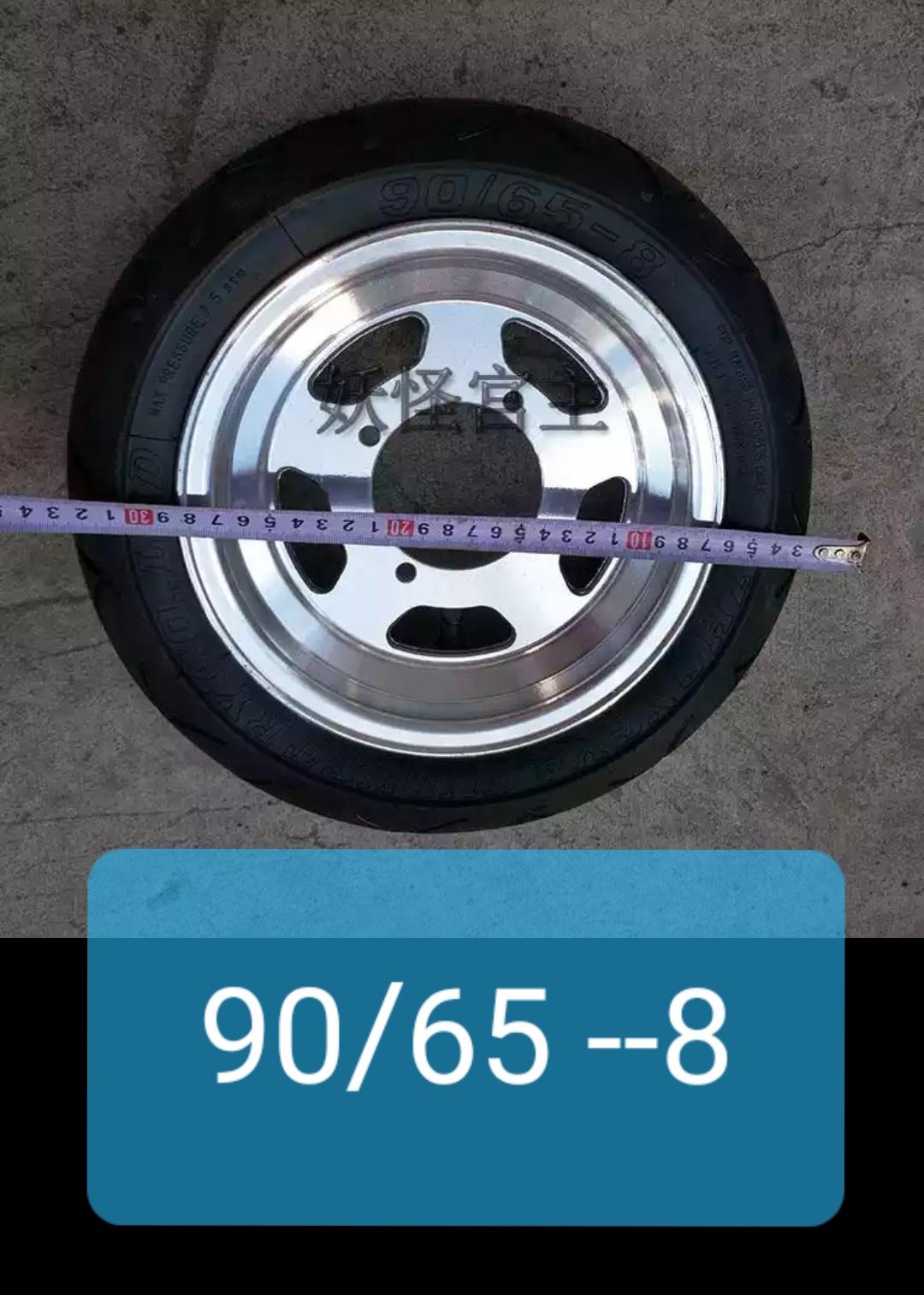

Postby shirley_hkg » 25 Sep 2019, 04:03
I always recommend 3.50-8 as it is the best fit.
There are shorter but flatter choices @ 90/65-8 ; and 130/50-8, good for soft terrain . No loss of torque .

a few quick progress pics,sorry still not the best pics as cant get far enough away from the chair due to such small workspace!
