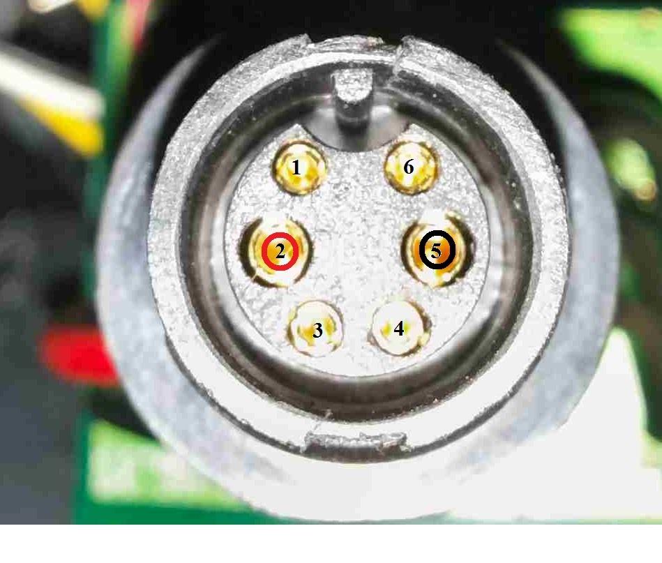

It's an MC2 socket .
mc2 socket1.JPG (80.03 KiB) Viewed 26367 times
http://curtisinst.com/Uploads/DataSheets/MC2web.pdf

Ah! .... Finally found some more info that I hadn't seen before on the pin designations and an indication that the MC2 is probably programmed via a Serial interface rather than the CANBUS....that makes life a little easier as far as the programming cable interface is concerned.
mc2 curtis conxall.JPG (99.45 KiB) Viewed 26359 times

Postby woodygb » 06 Nov 2014, 17:02
Did you download the MC2 manual? ... it has pictures :P
Despite the relabeling by Ottobock ..the item that you have photographed looks like a seat module.
Postby woodygb » 06 Nov 2014, 17:10
Service manual.
http://www.ottobock.com/cps/rde/xbcr/ob ... -1003w.pdf
Page 24 shows the location of the main control box.
Page 76 on for more about the controller.

Postby ex-Gooserider » 13 Oct 2015, 04:56
I don't know if you have the same type plug as some of the earlier Pride controllers. Their plug looked like a standard XLR plug with a couple of extra smaller socket holes added, with the matching pins only present in the programmer plug....
If so, the programmer plug is proprietary and not available.
Search back in the threads, around the same time as the earlier Gologen thread (possibly the same one?) and they had a couple of solutions...
1. Make a 'suicide cable' with a couple of bare pins (IIRC they used paper clips) to stick in the holes...
2. Get fancy and drill a standard male XLR plug to add the extra pins. IIRC they used spring loaded 'pogo pins' and sockets (as used in electronics test fixtures) to make the pins....
See the original thread for details...

Postby gcebiker » 15 Oct 2015, 12:53
SouthmanGA wrote:I'm needing to get this chair sped up, and I've read up on Quantum chairs. I've tried using a dealer programmer, but when I got to the setting(s), the +/- wouldn't allow the # to move. It is my guess it is locked?
Hi this happed to me on Tuesday as well, but it only locked in one screen.
When you open the program and read the settings, the screen with all the settings in the one place, that is where it locked it at 100% (to much for the user)
To change it i was able to go to the left to the '+' sign, and just open the one drive setting i was looking for '4' in this instance.
I was then able to change the settings i needed to.
As for wiring, i just have some think copper wire, tinned with solder to keep them tidy and just slide them into the pins, if it does not work, i reverse them and then it works. (i forget who asked about wiring it up)
The chair joystick also needs to be turned on for the computer program (1314 Programming station) to connect.
I use a Shark controller on my new chair that came with the QLogic so this picture is how i wired it up to test...opened the case, soldered a regular RC JST connector to it and put it back together, saves me remembering how to wire it later when i put the Qlogic back on the power base (when i get time to do the JC2000 testing/arduino Wii Nunchuck hack)
I think i should have posted these pics here , sorry mods, i got lost...
I think some of these boxes were greyed out (refer above) but i think its something to do with having been written/need to be re read from controller/refreshed/powercycled. I forget, was in a bit of a rush at the time, i tend to do cycling/reloading as an automatic thing as i repair pc's and they need it a lot...and it is a mini pc..

Postby gcebiker » 15 Oct 2015, 13:03
SouthmanGA wrote: I also saw the instructions on how to build the programming interface, buy that usb and build a cable, but it's a little above my current capabilities.
All you need is
- 1314 Program (i used Golenms settings/dll file)
- USB - Can adapter (mine was $64 but there are cheaper)...i wonder if an Arduino FTDI usb would work...mmm must try that out, oh wifi programming, that would be cool...i am digressing.
Two bits of wire.
..maybe a USB extension lead would help
Soldering the ends of the copper wires lets them be bent slightly. Helping them stay in the holes and give good contact.
I can take more pictures if you like, just tell me what you need.
Cheers
Tony
gcebiker
Posts: 879
Joined: 11 Jul 2015, 14:20
Postby gcebiker » 15 Oct 2015, 13:23
Took a picture and added notes to bits.
Software and more instructions at the start of this thread http://www.wheelchairdriver.com/board/viewtopic.php?f=2&t=2757
