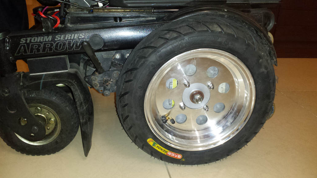

:P Can't resists the temptation of tubeless . Shirley_hkg goes tubeless too . :lol:
Re: Rebuild BM2 green...
Postby expresso » 22 Apr 2016, 15:22
Nice -- is that tire a direct fit - bolt in ?
its larger also - so you gain speed ?
Postby Burgerman » 22 Apr 2016, 18:40
Its a 10 inch aftermarket monkeybike wheel, not sure what tyre size probably 300 x 10. But its added some speed, but also lots of height as its 16 inches diameter. And maybe caster barrel no longer vertical?
Maybe an 8 inch tubeless rim would be better? But cant be done because of motor type.
Will increase speed by 14.9% and decrease torque by the same amount. So a 7.0 mph chair now goes 8.04mph
Posts: 71092
Postby shirley_hkg » 24 Apr 2016, 07:09
Burgerman wrote: So a 7.0 mph chair now goes 8.04mph
It's a 8.5 chair that I exceeded 8.04mph long ago , with full lithium on Bridgestone 3.50-8 tyres. :lol:
ON A BURNING AFTERNOON LAST YEAR :
I may hit 20 kph down hill this summer. :P
Postby Burgerman » 24 Apr 2016, 08:08
Thats 12.4mph.
Are the casters not a problem if you lift up the rear? I have the rear of the chair adjustable for height, so have the ability to lower it to keep caster barrel at 90 degrees to the road. Or very close to it limited by frame/tyre gap.
Posts: 71092
Postby shirley_hkg » 24 Apr 2016, 11:02
NO. They didn't shake even at 15 / 85 weight distribution.
Unlike snaker's case, my chair's caster stems may be not vertical but lean forward slightly . That will only extends the ground contact point from stem, not shorten it .

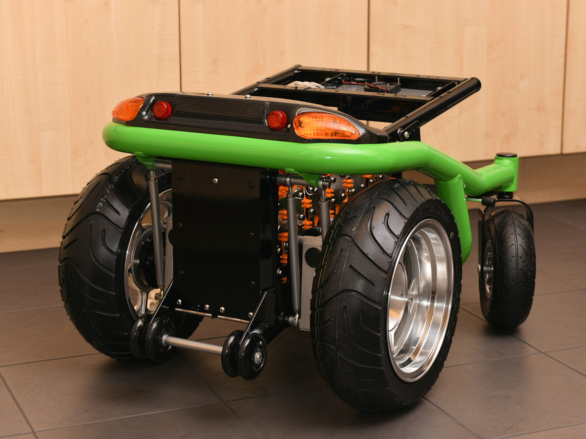

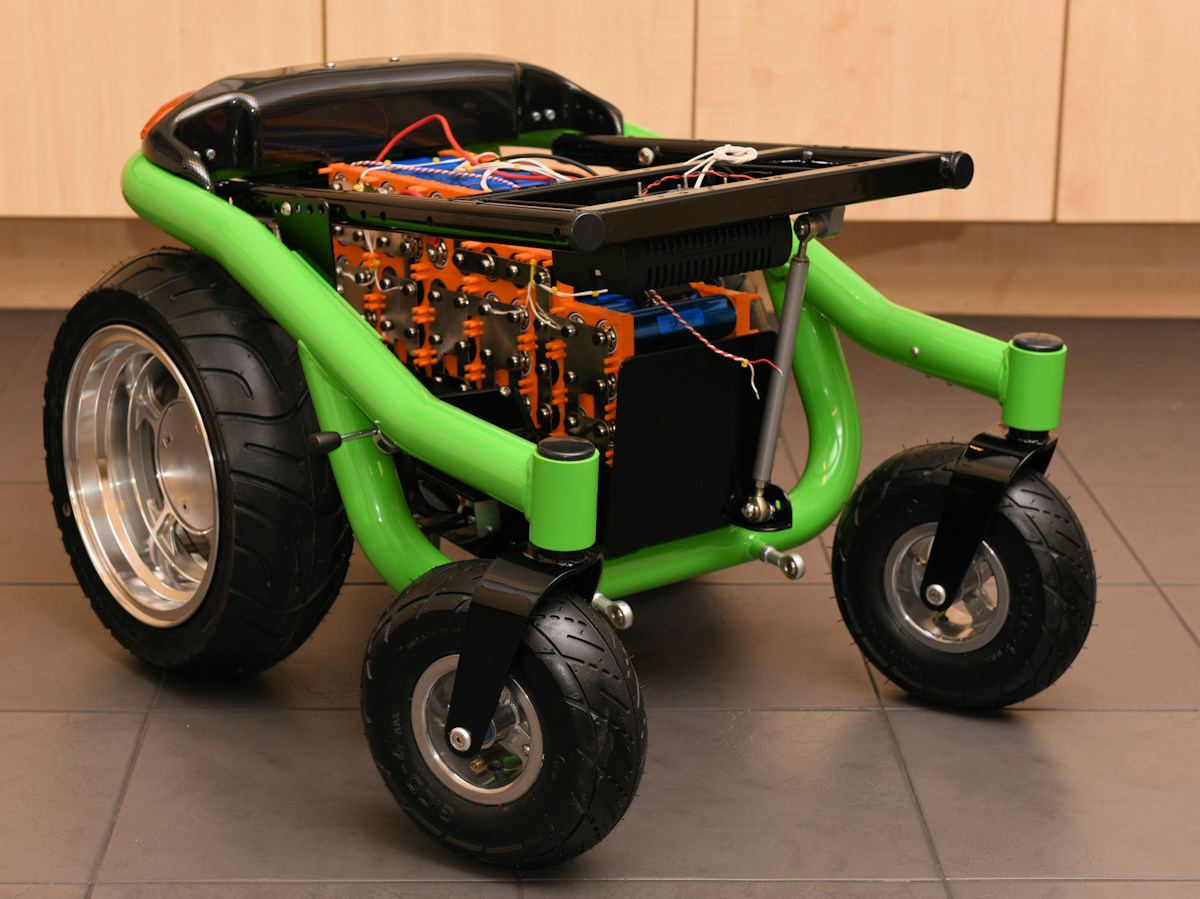

I see BM2 has some turnbuckles at the front and the rear. Does the original F55 frame already have them? Or did you modify F55 frame to fit them?
My chair only has 2 small latches under the seat pan to change the seat angle, but the adjustable height is just 1cm. I am thinking about fitting a turnbuckle at the front like BM2. Is this job easy for a small local workshop (I mean for those who are not very skilled)? Can you give me the code name (mechanical name?) of the turnbuckles used in BM2? So I can search and buy them.
download/file.php?id=4456&mode=view
download/file.php?id=4455&mode=view
Posts: 1258
Postby Burgerman » 18 Jun 2016, 07:33
Turnbuckles? Do you mean rose joints? Self aligning rod ends? There are non on the original chair.
I use them all over the place when building cars, bikes, powerchairs because they are strong, adjustable and can be aquired quite cheaply in bulk. Almost all of the BM chairs are fabricated from fresh metals, inc footplate design, all mounting points, etc. apart from the green fat tubular frame. Including all of the seat positioning mounts, footplates, centre section, motor mountings, wheels, etc.
These are m8 Female rose joints. http://www.wheelchairdriver.com/BM3-con ... 0_0766.JPG
Mostly I use m8 Male rose joints, heres some! http://www.ebay.co.uk/sch/i.html?_odkw= ... r&_sacat=0
Take a look at a few pics of footplate, seat frame, mountings, bars etc.
There are 8 in this image:
http://www.wheelchairdriver.com/BM3-con ... hair-6.jpg
10 here:
http://www.wheelchairdriver.com/BM3-con ... hair-9.jpg
http://www.wheelchairdriver.com/BM3-con ... air-14.jpg
http://www.wheelchairdriver.com/BM3-con ... air-13.jpg
http://www.wheelchairdriver.com/BM3-con ... air-12.jpg
http://www.wheelchairdriver.com/BM3-con ... air-10.jpg
Posts: 71092
Postby snaker » 19 Jun 2016, 02:54
Yes, they are rose joints, I used wrong word "turnbuckle". I just see in a car forums site in my country, people argued about these items in 3 pages. Someone recognized "rod joint" in English but there are not equivalent words in Vietnamese. They simply called them "chicken leg" :lol:
How about the tube between 2 rod ends? Does it have a code name (e.g M8 male rose joint tube)?
Posts: 1258
Postby Burgerman » 19 Jun 2016, 08:11
No its 16mm aluminium bar. Cut, drilled, tapped to M8 as needed.
Posts: 71092
Postby Burgerman » 19 Jun 2016, 11:20
Another 8 here. And 4 alloy bars. Drilled and tapped M8 thread. And then powder coated and stainless steel washers and stainless steel locking nuts. They allow me to adjust the frame height to make sure its equal both sides, and above the bigger wheels/tyres.
In this picture only the green part is F55 and it is stock, 18 years old, powder coated green. All the rest is either modified, from different chair, hand made, or nothing to do with powerchairs...

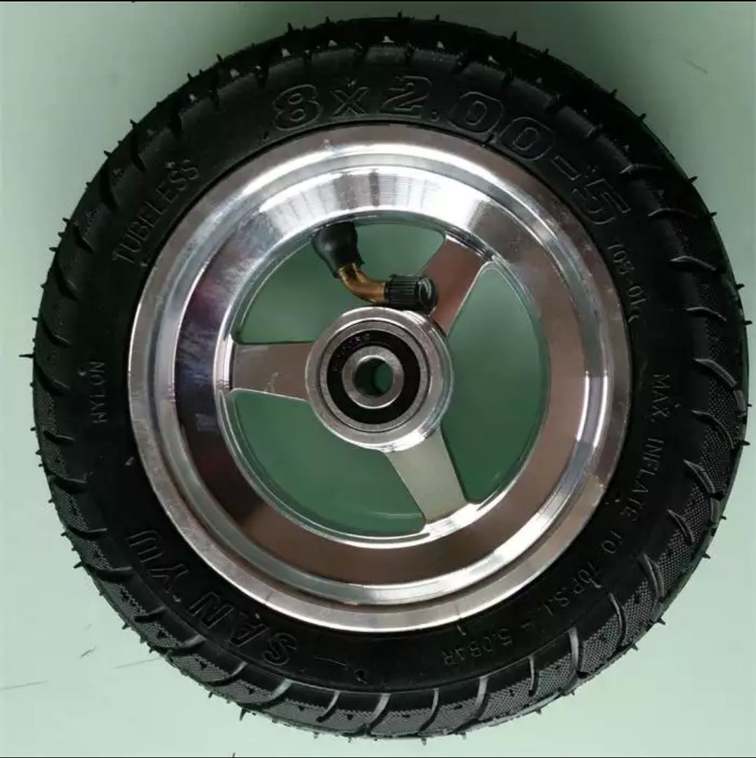

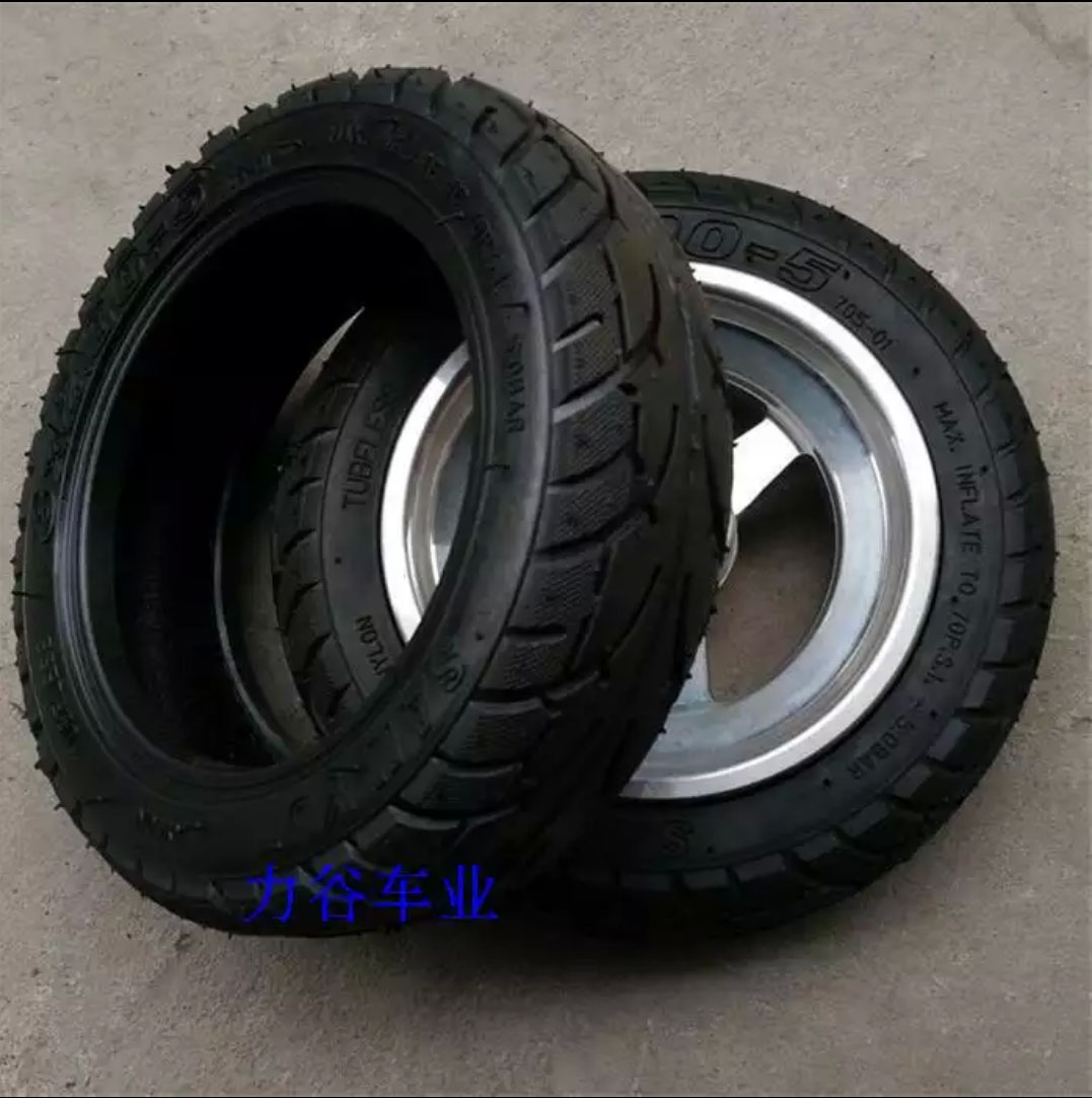

Postby shirley_hkg » 02 Oct 2016, 14:34

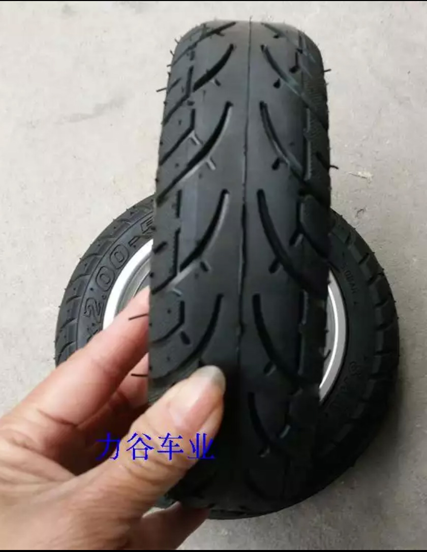

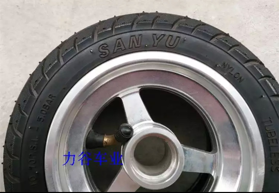

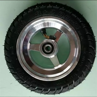

Can't you belive that ? There are really 8" tubeless . :D
Postby shirley_hkg » 02 Oct 2016, 14:36
Postby Burgerman » 02 Oct 2016, 14:47
Where can I get some?
Posts: 71092
Postby LROBBINS » 02 Oct 2016, 15:40
Pity those nice looking alloy rims wouldn't work on the MicroMotor in-line motor hubs. I'd certainly rather have them than the gloss-black painted 8" trailer wheels now on Rachi's chair. BTW, those aren't the only 8" tubeless tires that can be had - Rachi has Carlisle Turf Saver 4.80 - 8 tubeless; diameter 16.5", mounted width 4.8" running at 5 psi.
Postby expresso » 02 Oct 2016, 15:47
nice tires - would love to fit those to my chair -
Postby Burgerman » 02 Oct 2016, 15:48
No they are 8 overall. Actually 9. CASTER wheels/tyres.
5 inch diameter rim, 2 inch tubeless tyre. 2+5+2=9
Posts: 71092
Postby LROBBINS » 02 Oct 2016, 17:20
Ah, that is different. What's their width?
