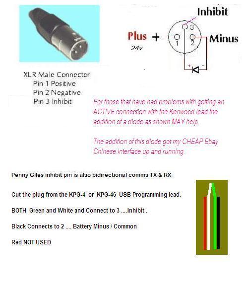

Postby wheeliechair » 23 May 2012, 18:45
woody I am having the same trouble that brax had I have the cable soldered the driver installed and it passes the loopback test and when I open pgdt programmer it says not connected for a second then it says comms inactive.
My chair is a quickie s646.Can I send you my cord and you send me one of yours?

Postby woodygb » 23 May 2012, 19:12
I have NO USE for the programming lead ..it was simply a project that I set myself to aid this community..and Brax's problem was ... if you like ... a part of the initial project.
Unfortunately I have no idea why his lead worked fine for me and vicer versa.

Postby woodygb » 23 May 2012, 19:54
Wheelie ...
It should be noted that the two lead types I purchase and convert are thru Radio Arena UK and both ...if my Googling is correct ...made by RAYTALK.
I did purchase a MUCH cheaper version .. also Chinese and KPG-4 / 46 ...to try ...and it ...like yours.... passes all the "tests" but will NOT connect as a single or one wire interface.

Postby woodygb » 29 May 2012, 10:49
Some people have been having problems with the Kenwood lead ... including myself with my new batch!.... SO ... a bit more research and a chat with Radio Arena plus Raytalk ( damn those leads are CHEAP direct ..but 50 at a time is to rich for me! ).. gave a new lead recommendation.
An Icom OPC-592 USB RIB-Less Programming Cable ..just 2 wires .. I've bought one and just tested it .. absolutely no problems!
So revised pic...old ones DELETED.

Postby woodygb » 02 Jun 2012, 11:50
wheeliechair wrote:woody I am having the same trouble that brax had I have the cable soldered the driver installed and it passes the loopback test and when I open pgdt programmer it says not connected for a second then it says comms inactive.
I have a lead made up for you...but .... you might like to try this mod to yours first.
Postby woodygb » 02 Jun 2012, 12:42
