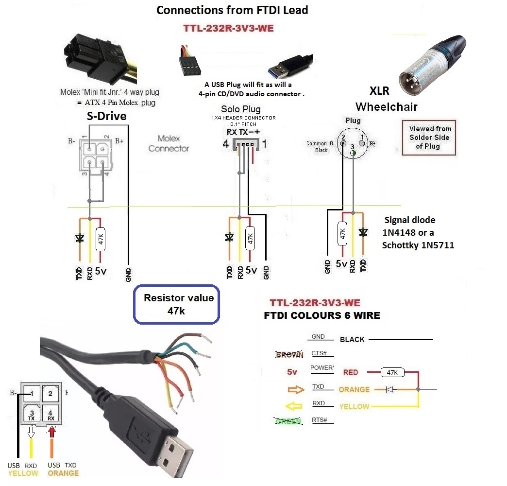

Re: Where to find PGDT programmer software
Postby Jinks02 » 01 Feb 2022, 12:49
Quick Question
If I'm making a lead from a USB serial adaptor to a "ATX" 4 pin Molex plug can I just connect pins 3 & 4 on the Molex plug to the Tx & RX of the USB lead, or do I still need to bridge pins 3 & 4 and add a diode to control the flow.
Also do I need to set a baud rate and flow control anywhere ?
Once again
Many Thanks
Jinks02
Jinks02
Posts: 9
Joined: 01 Feb 2022, 09:08
Location: North West England
Postby woodygb » 01 Feb 2022, 13:27
There is no need to play with any settings...the cable should just work.
Connecting RX and TX from the Molex to the USB TTL Serial Adapter will work and you will not need the diode or resistor.
Postby Jinks02 » 01 Feb 2022, 14:02
Brilliant Thank You
Jinks02
Posts: 9
Postby woodygb » 01 Feb 2022, 14:06
Pic.
