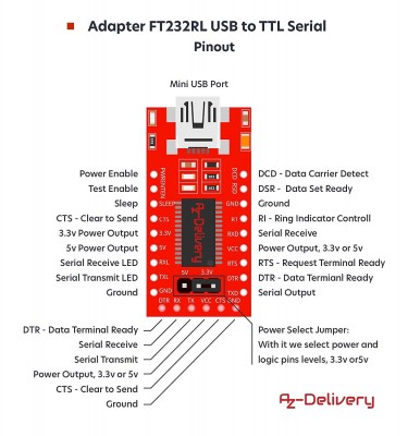

You need to use one of these...other types simply do not work.
https://www.amazon.co.uk/gp/product/B0753GY7FR
https://www.amazon.co.uk/gp/product/B079X3SWHV

gcebiker wrote:Wouldn't that RS232 cable just replace your Red RS232 to USB board you are using woody ?
I will attempt to make it clearer... One uses TTL Signal Logic the other uses RS232 signal logic .
TTL serial & RS232 serial are NOT the same or compatible , their high and low signals are the opposite of each other.
THIS Adapter uses TTL serial logic signals .
This method of serial communication is sometimes referred to as TTL serial (transistor-transistor logic). Serial communication at a TTL level will always remain between the limits of 0V and Vcc, which is often 5V or 3.3V. A logic high ('1') is represented by Vcc, while a logic low ('0') is 0V.
The board in the pic IS NOT RS232 it is TTL.
It uses a FT232RL Mini USB to TTL Serial Converter Adapter Module 3.3V 5.5V .
E.G. https://www.amazon.co.uk/gp/product/B0753GY7FR

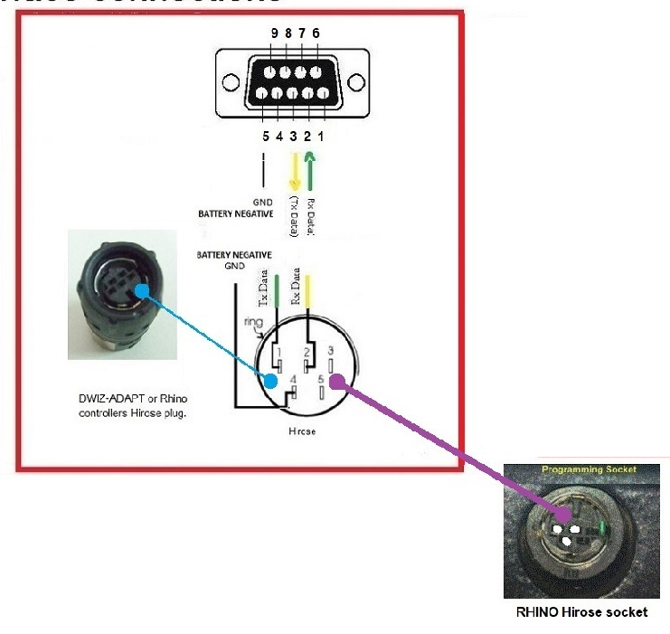

I already got the software, the OEM dongle, the DWIZ adapter + XL3/Molex 4pins adapter and the USB/RS 232 adapter.
So if I'am right I just miss the RS232 to Hirose plug cable
In order to built it can you confirm this and by the way confirm that :
RS 232 pin 2 goes to pin 2 of Hirose plug
RS 232 pin 3 goes to pin 3 of Hirose plug
RS 232 pin 5 goes to pin 4 of Hirose plug
Thank you

Postby woodygb » 19 Aug 2021, 19:08
FrenchGuy wrote:Hello,
As Daf I need to setup a dr90-a01 controler.
Thank you
Hi ,
NO
The convention is TX ( Transmit ) talks to RX ( Receive ).
RS 232 pin 2 "listens" to pin 1 of Hirose plug
RS 232 pin 3 " talks" to pin 2 of Hirose plug
RS 232 pin 5 GND goes to pin 4 GND of Hirose plug
JUST USE YOUR RS232 to Hirose plug cable!!!

So ... Connect the RS232 to Hirose plug cable into the RS232 -USB adapter cable...plug this into the DWIZ-ADAPT and finally plug in the MOLEX adapter cable.
Does this make sense?

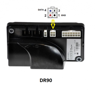

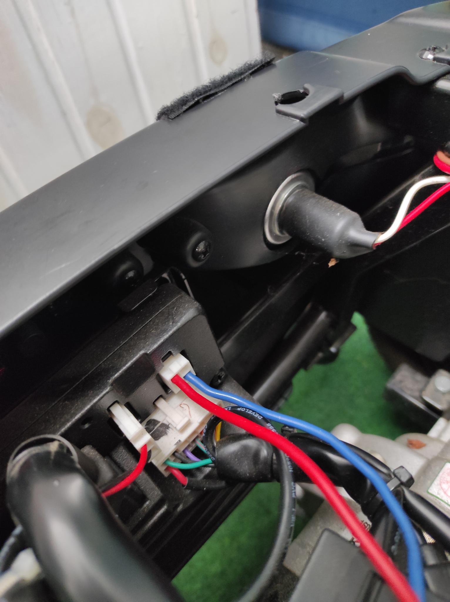

I have now soldered the circuit board 3 times and checked it x times. but I can't get a connection to the control unit.
When I stand behind the scooter and look at the control unit from above, I use pin 1 GND at the top right and pin 4 DATA at the bottom left ... when I measure between data and GND, I have about 3.7V
I installed this control unit. https://drive.google.com/file/d/16n0a7cN6h_WRnkVGsNW4uY0u7ZzMhV2-/view?usp=sharing
https://drive.google.com/file/d/1FnifVoLdybwTjKONFK-LmLEUv021hr-e/view?usp=sharing
I ordered this Rs232 / TTL converter https://www.ebay.de/itm/293942252350
Do I have to change the settings in the software? The COM port is correct and the data LED on the TTl converter also flashes when the software scans the addresses
What else could I check to find the error? Thank you for your help

Postby woodygb » 21 Aug 2021, 17:08
Your Google Drive links give an ACCESS DENIED.
The USB - TTL Convertor that you linked to is the correct type... other types simply do not work.
NO SETTINGS NEED ALTERING.
I am unsure about your pin number positions as your description requires me to know which way around your controller is when you are looking at it..
