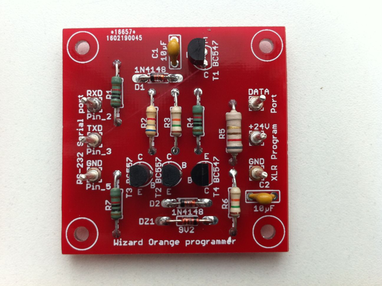

I've had success with this board connecting it to a built in RS232 port and also with the same board via a MAX 3232 to a TTL - USB.
download/file.php?id=4612&mode=view
I've currently got 2 more MAX 3232 boards on order ... ( I've inadvertently killed my current MAX 3232 board :cry:) ...so that I can investigate some more .

viewtopic.php?f=2&t=4095&start=40
I obtained the bare board from Anubis and populated it myself.
Re: Arduino controlled wheelchair
Postby gcebiker » 19 Apr 2016, 13:06
I really like his board, super straight forward for new users to wire up.
I have asked if there is two for purchase.
...i am wishing i had a 3D printer...this board is a great candidate for making into a more 'factory' look/feel.
