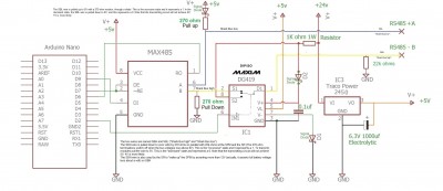

Postby gcebiker » 07 Dec 2022, 00:05
This is the trace that is 'missing', in retrospect, I should have put one in but thought every one would be using a physical switch or want to use a Raspberry Pi to power the board, thus left it not connected.
Also there were different code and jumper-ed pins on the input side to use Pi, PPM, I2C or serial.
Please get back in touch should you like further guidance.

Re: Dynamic Controls Power chair, RC Boat trailer project
Postby gcebiker » 05 Jan 2023, 01:05
Paolodir wrote:
gcebiker wrote:This is the trace that is 'missing', in retrospect, I should have put one in but thought every one would be using a physical switch or want to use a Raspberry Pi to power the board, thus left it not connected.
Sorry but I cannot see any file, could you send it back again please?
http://www.greenmobility.com.au/wp-cont ... er3.25.png
The positive trace from the 6.3v 1000uf capacitor to the Arduino header pins.
