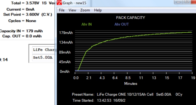

Postby Dan » 16 Sep 2017, 14:09
expresso wrote:Dan - your going to make a 30ah Pack - look back from Page one here - i have pictures - you can follow them - it will show you how to arrange the Cells - attach the balance wires etc, -
when you say a BIT - what does that mean - Did you charge each Cell with the PL 8 Full and left them ALONE for a MONTH or TWO ? at least a MONTH is fine - before you continue ?
Yes I had fully charged each cell when I got them. They have now been sitting for a few weeks. I'm charging them back up. I numbered each cell when I first charged them.
I'm looking for the capacity returned to each cell? This one is 179mAh.
Dan

Postby expresso » 16 Sep 2017, 15:18
that seems pretty high for a Cell sitting for only two weeks - thats even high for two months sitting - Two weeks is really not enough - At least a month sitting after fully charged - - OK if you going to continue this way - i would put that Cell aside for the moment and continue with the rest of the cells and see what you get back in mAh returned -

Postby Dan » 16 Sep 2017, 15:26
It was a few weeks. Just checked the date they were charged. It was early July so they haven been sitting about eight weeks.
Highest returned so far is 275mAh, the lowest is 105mAh.

Postby expresso » 16 Sep 2017, 15:32
Dan wrote:It was a few weeks. Just checked the date they were charged. It was early July so they haven been sitting about eight weeks.
if i recall mines - were all much lower - those all seem high - not sure what that means but if they are all similar - i guess you can match them the best you can - you can try to test them again - discharge one and then recharge it again to see how much it returns -
