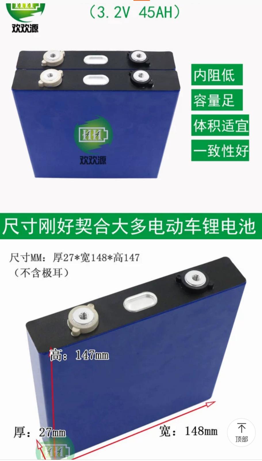

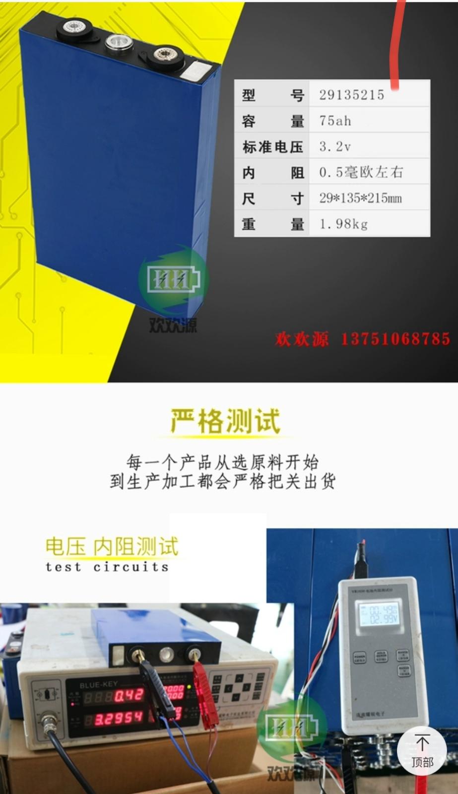

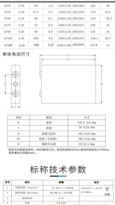

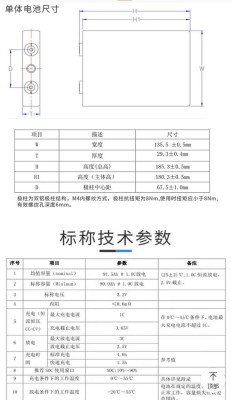

Postby shirley_hkg » 09 Jul 2019, 03:16
cheers JUST FOR REFERENCE drunk2
45A is compact .
75A has good review from "snaker" here .
EVE_LF105 is the best I met.
