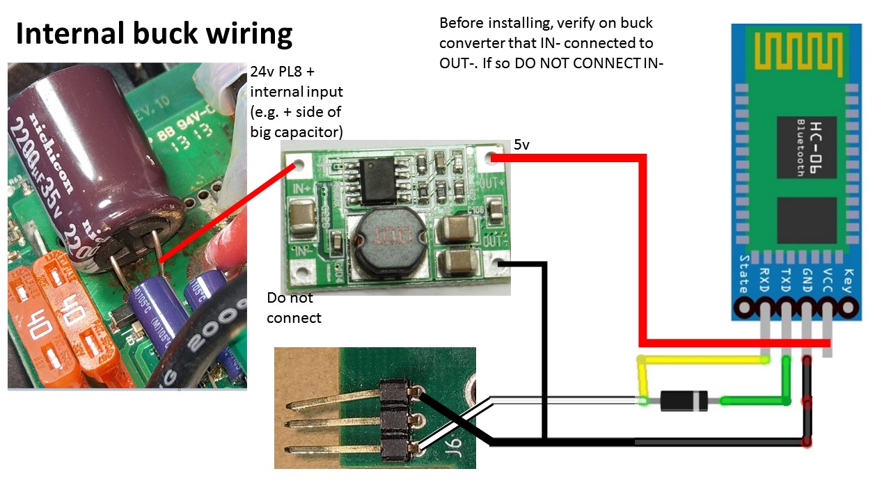

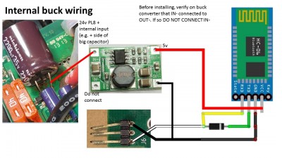

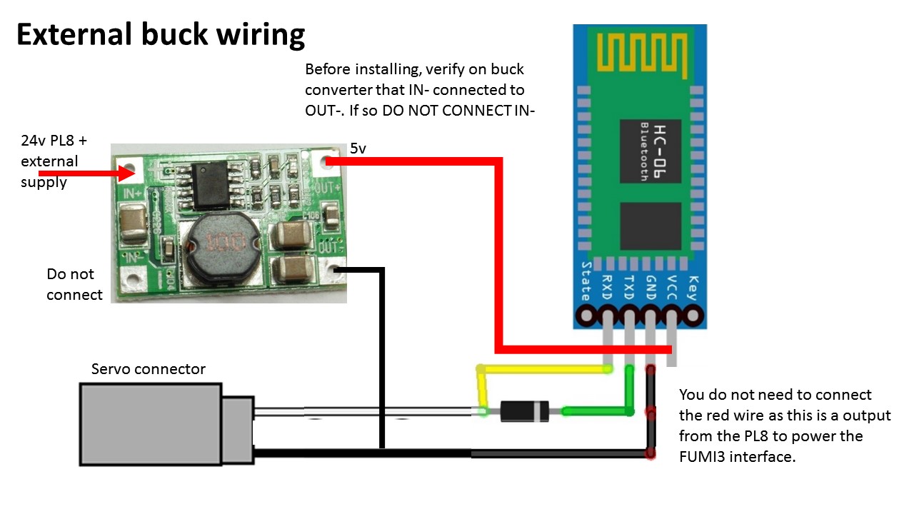

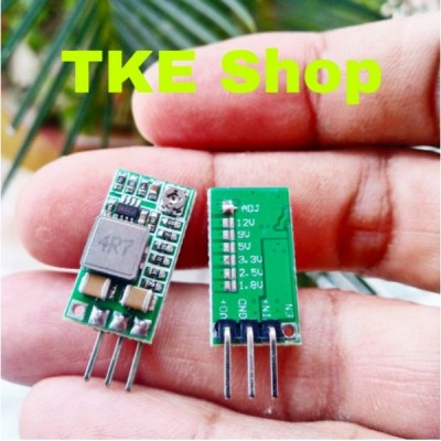

Irving wrote:One major caveat to the diagram on how to connect the BT adapter negative ground (black) wire.
If you are using an external buck (down) converter DO NOT power it directly off the main charger supply unless it is an isolated DC-DC converter. If it is non-isolated, connect the + input to the PL8 + (red) input only and be very careful that the - (black) connection of the buck converter does not come into contact with the - input to the PL8. Better, for safety, use a stand-alone isolated 5v USB charger, a stand-alone 5v USB powerpack, or a 3 x AA cell switched battery holder and do not connect the negative side to the negative power input.
Now, I know there are those that say they've wired it directly and it works, and yes it will, most of the time. But it is a problem waiting to happen...
The negative input to the PL8 goes to a pair of parallel 40A fuses, a MOSFET isolation switch and a high frequency noise filter BEFORE it becomes the internal 0v rail and ground connection on the 3-pin remote control connector. So connecting the BT ground to the negative power input ground bypasses all of that and under fault/overload conditions and/or when doing high-power discharge into a dummy load, that connection can potentially become the main current flow in or out of the PL8 which is almost guaranteed to do some serious damage to the BT adapter, the PL8, the wiring and/or the local environment...
So asking what to me seems an obvious question - wouldn't that be the same problem if I take the supply from the same place internally which is what I thought was the idea? So if taking the supply internally where would you supply the DC to DC converter from if not from the charger's input?

Mines (5v supply) is wired direct to the 10 to 30V power input internally by soldering to the board. Been that way years. No problem so far. If thats wrong I would also change it. Better safe than sorry I suppose! But again, dont know where!

Thank you - I will take the top off one of my PL8s and have a look now - This will make life so much easier for me if it all works :worship

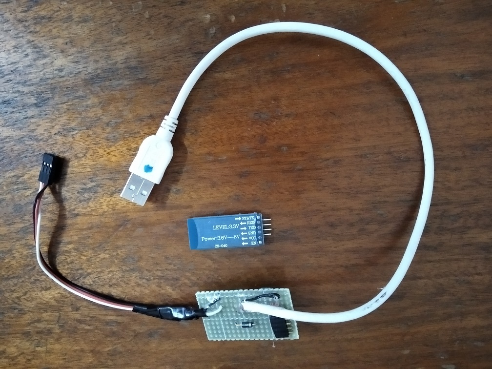

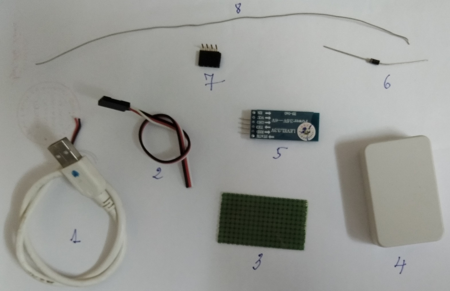

Postby snaker » 28 Feb 2021, 04:24

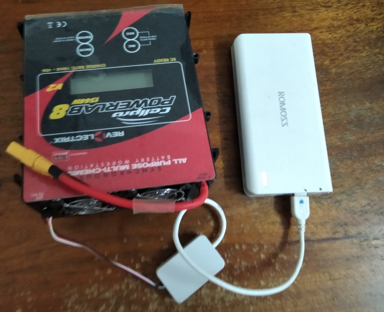

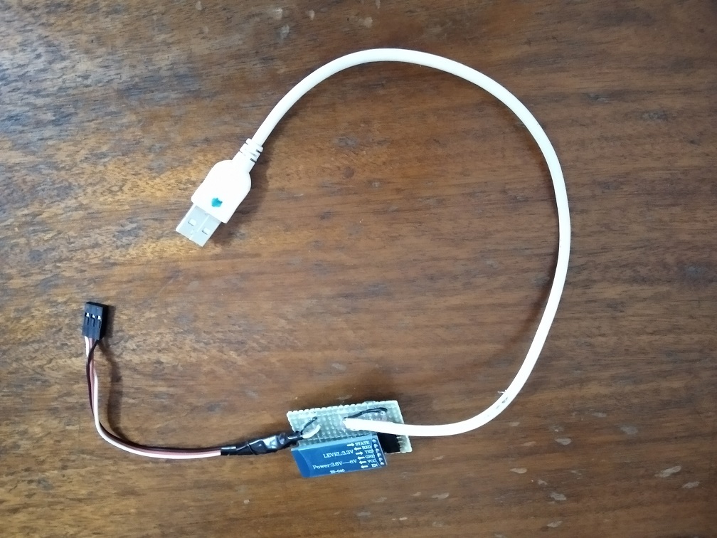

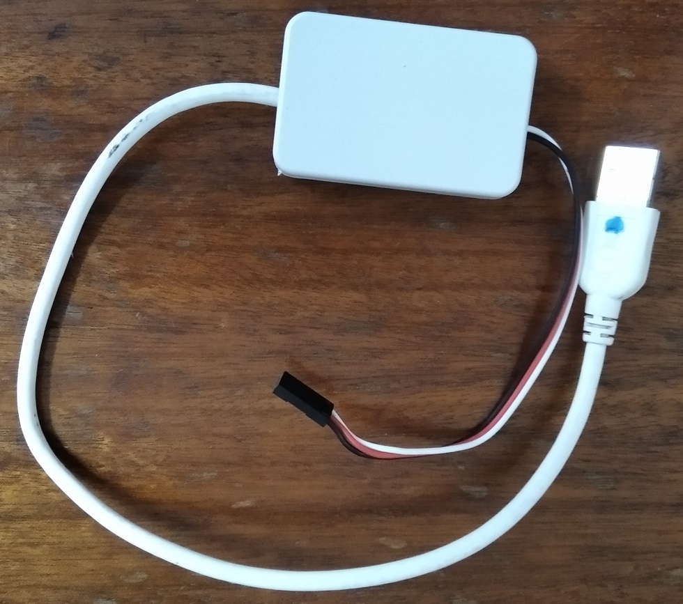

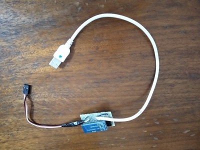

Today I start making my new BT box. Because the box is very small so I should call it BT cable.
Making an external BT cable is very simple and easy. You do not need to open the charger case. And it is 100% SAFE.
The first image underneath shows all components that I will use:
1. A half of an usb cable. It will be plugged into an usb socket on a 5V powerbank.
2. A half of a futaba (servo) cable. It will be plugged into the 3-pin hole on the PL8 charger.
3. A piece of prototype board. It fits the box (number 4).
4. A box 55mm x 35mm x 15mm that contains the prototype board (number 3).
5. A HC-06 bluetooth module.
6. A schottky diode. I use 1N5819 1A rated because it is the lowest Amps rated sold here. If you could find another with lower amps e.g 100mA, it might be better.
7. A header that will hold the HC-06 BT module (number 5). It is a piece of a long header.
8. A solid tinned wire that will be used to make tracks on the prototype board (number 3).
There are 2 ways to wire all components together:
- Soldering them inline as BM did.
- Soldering them on a prototype board.
I prefer using prototype board because it is more compact. The downside is that it requires a bit more accessories. The tracks on the prototype board look like in the second image. My dad will watch it while soldering components on the board.

Postby Burgerman » 28 Feb 2021, 06:12
I just soldered the diode across the pins on the BT board. Then took 3 wires away from it. No complication of any extra circuit board or anything needed.

Re: Electronic experts - BLUETOOTH
Postby snaker » 28 Feb 2021, 10:31
DONE !!!
Postby Burgerman » 28 Feb 2021, 11:05
Doesent it kind of defeat the object of the excersize to have 2 extra boxes and needing a USB connector to power it all?
If you are just a tiny bit braver, fit it inside, theres nothing to see or plug in?

Postby snaker » 01 Mar 2021, 02:27
Burgerman wrote:Doesent it kind of defeat the object of the excersize to have 2 extra boxes and needing a USB connector to power it all?
In my case, PL8 always sits on a desk. It is powered by huge and bulletproof 1.500w supply which sits on that desk too. The combo of BT cable and a powerbank is in fact very small and compact in this context. I can leave it anywhere on the desk on even on the supply. It looks nice too. You can think it like an ornament on your desk. Someone here even leaves their chair in garage, who cares about that tiny 'extra' space?
If I had a spare PL8 and had my hand control, maybe I would make an external BT. It must be done by myself, I could not trust my dad or anyone else in this stuff. And I would only do it for fun. Because the internal BT does not give me much advantage over the external one.

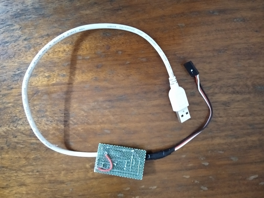

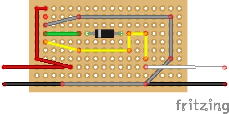

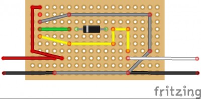

Postby snaker » 01 Mar 2021, 08:59
Some pícs above the prototype board. Do you see it is very simple? Do not leave the color tracks in the pic in my previous post scare you. They are not complicated as they look. If you go with a PCB, all those tracks are already printed on the board. You only need to solder components' legs into the right holes on the PCB.

Postby Burgerman » 01 Mar 2021, 11:24
Well if it works for you!
But fit it inside, and you only need the blue BT board. No wires or anything external. nothing trailing. And its powered interally. All invisible and self contained and neat. And actually easier/simpler to do. But both ways obviously work.

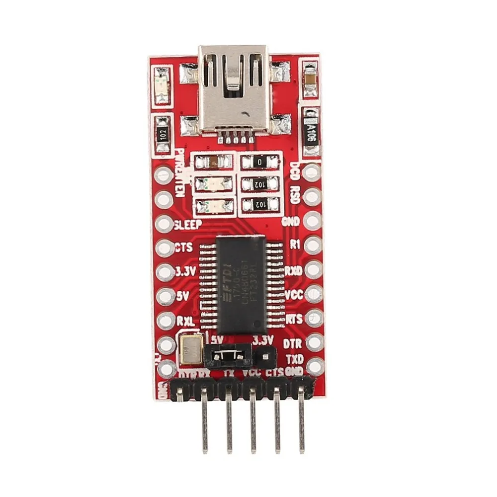

Postby woodygb » 09 Mar 2021, 17:32
1. To power JDY-40 by a 5V source,
...Buy a USB to serial UART interface that supplies 3.3v.

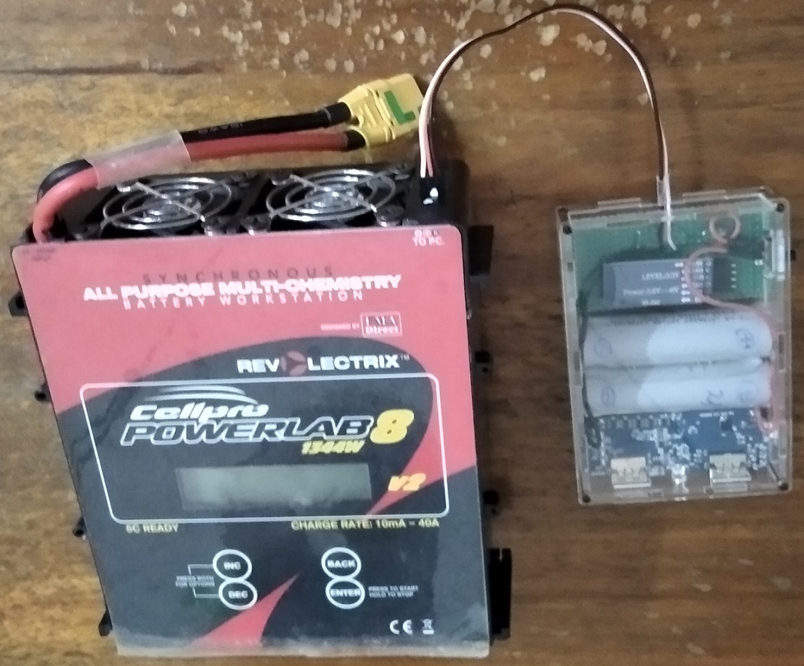

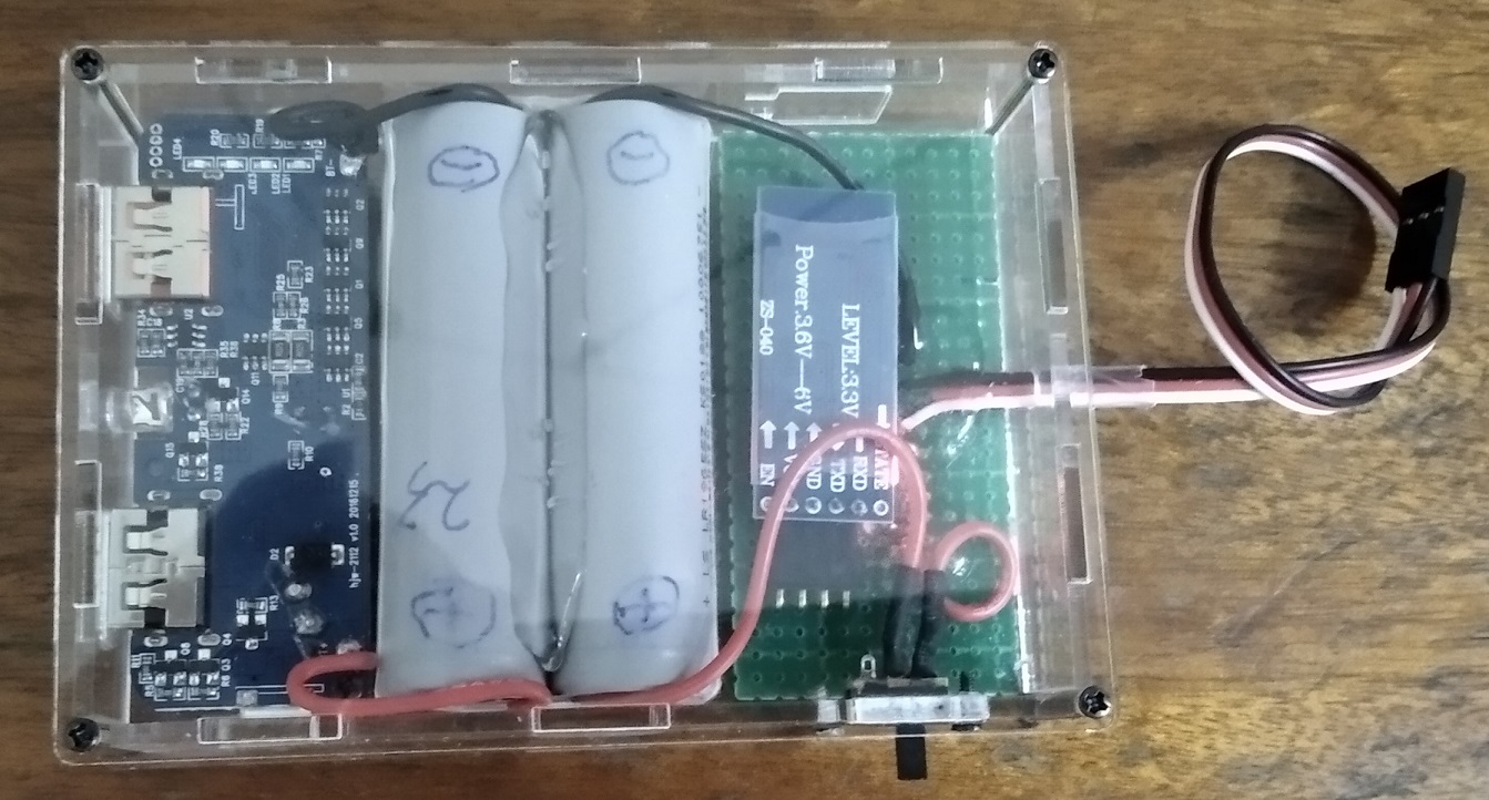

Postby snaker » 19 Mar 2021, 02:04
This is my new BT box. This one comes with battery and charger :joint
