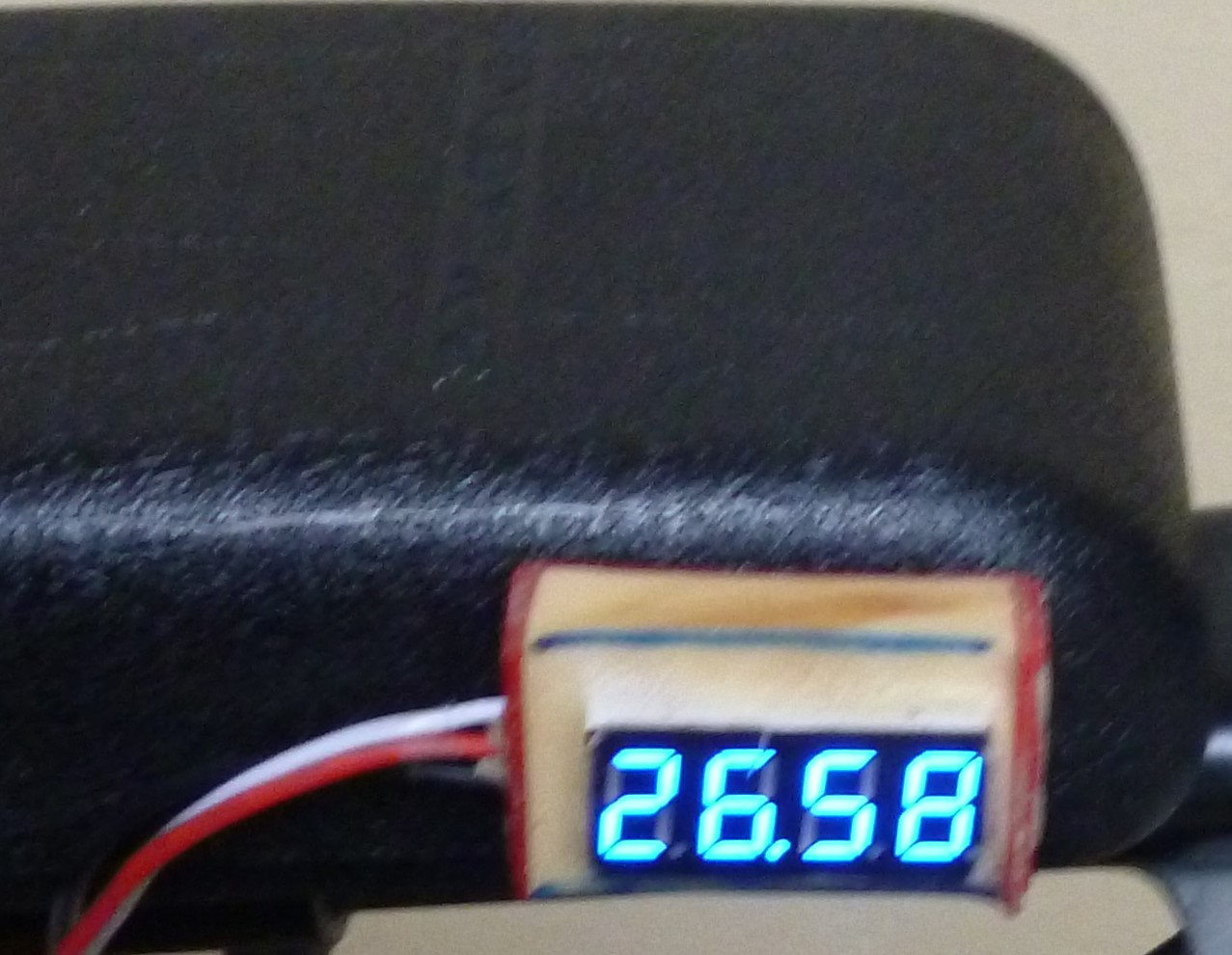

Postby snaker » 29 Jan 2018, 10:19
I just fitted a led voltmeter :thumbup:

Postby snaker » 30 Jan 2018, 01:40
Yes, it has an on/off switch but I will rarely use the switch. The voltmeter connects to the joystick xlr socket, I only plug it when riding.

Postby snaker » 30 Jan 2018, 02:03
Yes. Red and White wires connect to the positive, Black wire connects to the negative.
This cheap voltmeter is surprisingly accurate. Its number is only 0.05V lower than the voltage shown on PL8. It can be calibrated to be more accurate but I leave it 0.05V less for better safety.

Postby snaker » 02 Feb 2018, 08:05
I used this holder below. It's small and easy to solder. At least it adds some peace in mind :D
This cable also powers my camera, a fuse is a must for my case.
