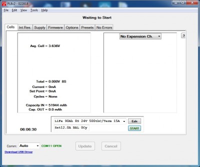

Postby Gnomatic » 28 Feb 2018, 16:20
I updated one of my presets so Balance Mode was set to Digital ON/OFF and turned the Deadband down to 2mv as suggested.
Not much changed for me as far as I can see. About the same amount of time at CV as what I got before.
Postby Burgerman » 28 Feb 2018, 19:25
You will only actually SEE the difference on a graph when you set the no of decimal places to 4. That also removes the cell grouping averaging. So you see reality rather than everything within +/- 4mV or so, displayed using the same pixels on screen. Very informative. But makes people worry more with a less tidy "appearing" graph!
Go to: view>preferences>cell display>4 digits... Dont leave it set this way as it will drive you to distraction. Doesent bother me, but it lets you see which cell groups are hard to balance etc.
Posts: 71104
