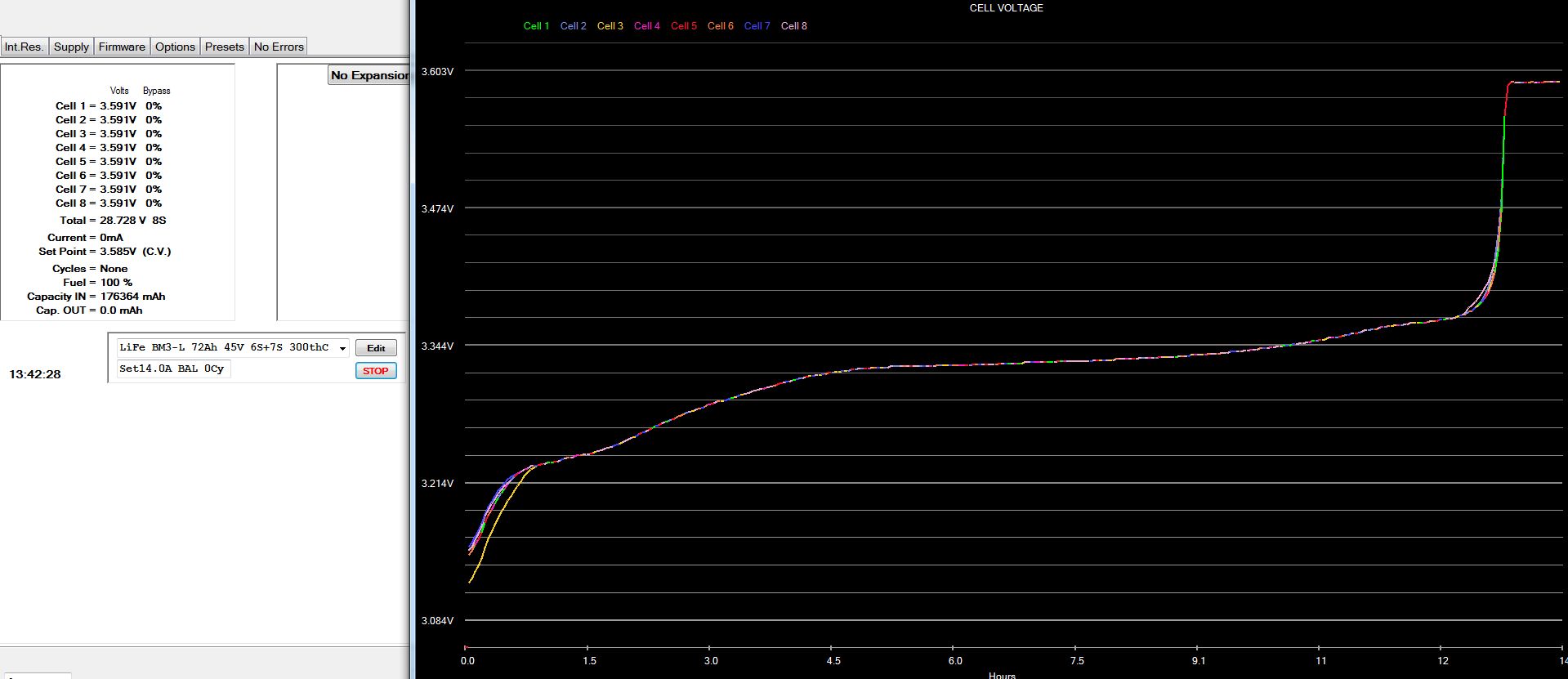

Postby shirley_hkg » 30 Jun 2018, 06:21
Cylindrical cells seem more reliable .
SONY 26650 @3000mAH .
cheers
Postby Burgerman » 30 Jun 2018, 09:54
Thats exactly what I see with lifepo4 though.
With the PL8 you need to set it for 4 decimals to see the differences on the graph, or it averages the data.
VIEW > PREFERENCES > CELL DISPLAY > SHOW 4 DECIMAL PLACES
Posts: 71109
Postby shirley_hkg » 30 Jun 2018, 10:01
Dunno it can do that . :clap
Postby Burgerman » 30 Jun 2018, 10:48
Your graphs wont look as pretty, but it shows more detail, no data averaging. It shows you why a long CV matters for balance after you stop charging for eg. It also shown you just how crap BMS are if you monitor a pack being charged. Looks like a range of mountains!
I only set to 4 decimal places and no rounding, when figuring out how long CV or what is the best termination current. Ideally you want long enough to be sure all cells end up properly balanced and charged. But as short as you can get away with as they dont like being held high for a long time. And different packs vary a fair bit. Then change it back.
Do you like the PL8? I think its an invaluable tool for anyone playing with batteries. There isnt another comparable at the moment.
