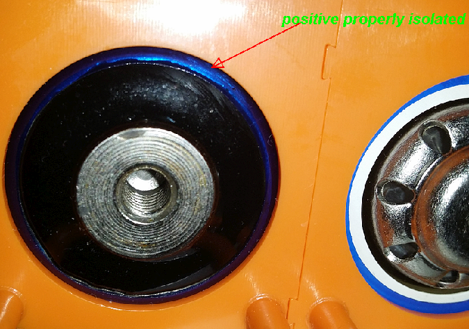

Postby FJC10 » 12 Sep 2018, 22:39
What do you think about this extra negative pole protection?
are insulating washers on the negative ends before adding the bus bars to prevent accident contact because the pos+neg voltages are right there a fraction of an inch apart, if both pos+neg come into contact by accident they will create instant spectacular fireworks, right?
FJC10
Posts: 128
Joined: 30 Jul 2014, 20:42
Postby Burgerman » 12 Sep 2018, 22:58
As long as they dont get in the way. Throw away those x head screws, use cap head - allen head screws...
Posts: 71111
Postby FJC10 » 12 Sep 2018, 23:51
Burgerman wrote:As long as they dont get in the way. Throw away those x head screws, use cap head - allen head screws...
The battery in that picture is not mine, it's from another forum. I have hexagon head screws Allen round head screw. What I don't know is whether to use split washers that came with the cells...
FJC10
Posts: 128
Postby Burgerman » 13 Sep 2018, 00:11
Best not. Just thin flat washers. Loctite the thread.
Posts: 71111
Postby shirley_hkg » 13 Sep 2018, 03:22
FJC10 wrote:What do you think about this extra negative pole protection?
are insulating washers on the negative ends before adding the bus bars , right?
It will be problematic , though it is thin.
That will put most of the current to flow through the bolts , which are not a good conductor and more unfortunately , Loctite insulated . :thumbdown:
It's useless. It can't prevent bus bars touching each others anyway , can it ?

Postby FJC10 » 13 Sep 2018, 19:04
shirley_hkg wrote: It will be problematic , though it is thin.
czy
He uses a 1 or 1.5 mm thick plastic material
If I didn't misunderstand the guy who invented that extra protection, he puts that in order to avoid contact with some object between the badly isolated positive part of the negative zone of the cell.
I took a picture of one of my badly isolated cell
And in these photos I show an example of a piece of paper. As you can see, it doesn't block the negative pole from making the same contact as without:
