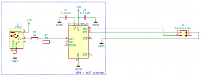

I built the cable on my own. It uses a CH340E.
Schematic:
The controller is answering. But for some reason it gets a timeout on the port. I dont know what causes this. If its the PC programmer or some driver issue, or what else it could be...

Use one of these instead of the CH340

Nope. No Change. Same old Status_Timeout. I think my Controller has some type of problem....

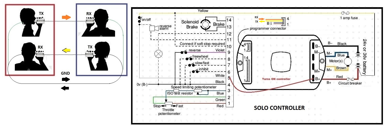

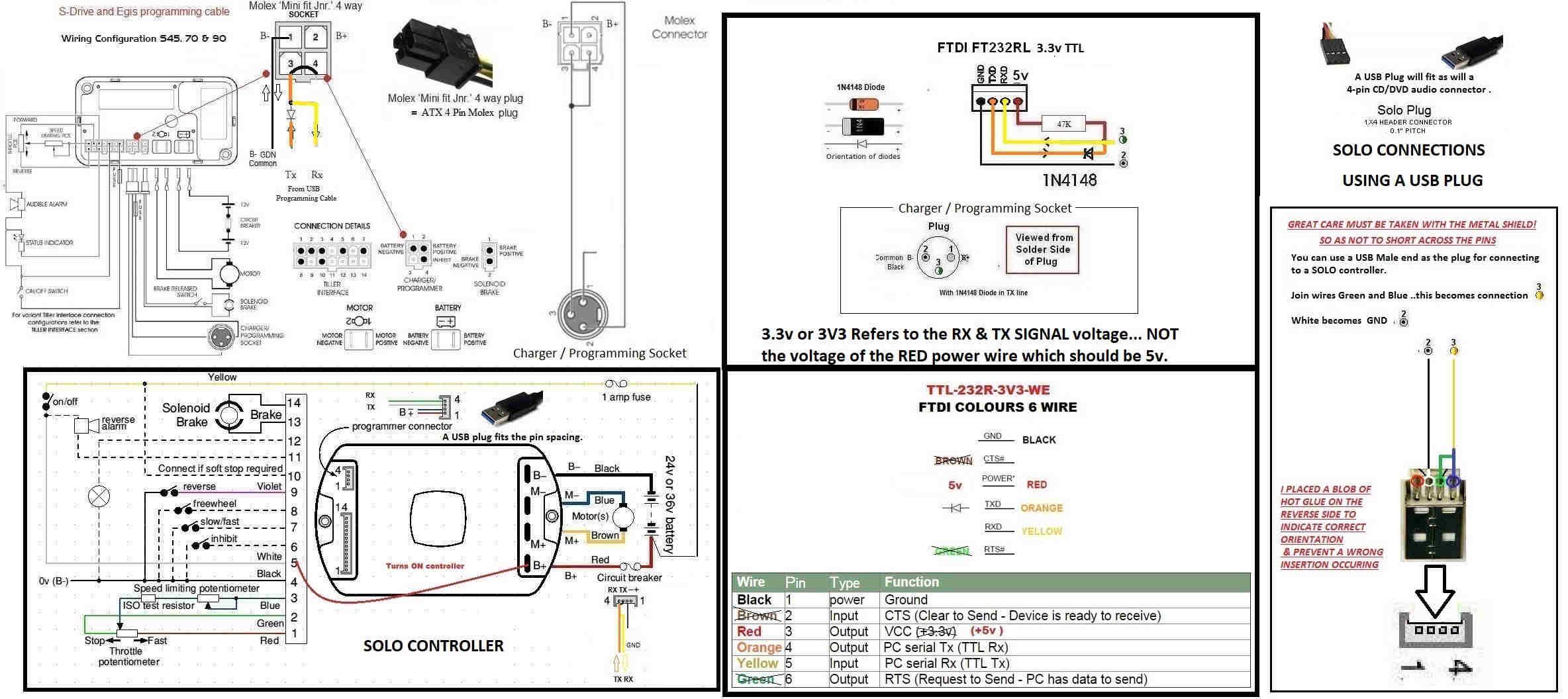

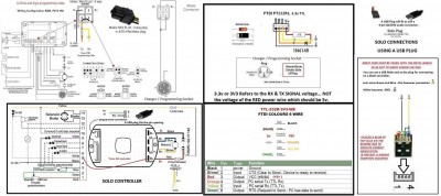

The pic below shows the connections using an FTDI cable , with the addition of a resistor and Schottky diode ...
BUT a direct connection ( TX of USB to RX of controller ) and ( RX of controller to TX of USB ) plus GND will probably work.

woodygb wrote:The pic below shows the connections using an FTDI cable , with the addition of a resistor and Schottky diode ...
Just making sure I am not interpreting this incorrectly, so where the charger usually plugs in to the controller can also be used to program the controller?
MOST of the time ...but not always.... there is no harm in trying.
