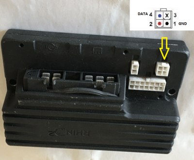

yes the driver is installed correctly. first it was on COM 8 then I switched to COM 2 because I thought that the software might not work with COM 8. I also measure a signal whenever the software checks the various ports with the oscillator between DATA and GND. The picture of the control unit that you sent has a different connector arrangement than that of the control unit from me. Can this be the reason?
Kaschperlpropper
Posts: 16
Joined: 05 Jun 2021, 09:34
Re: DWIZ-ADAPT
Postby woodygb » 22 Aug 2021, 12:49
Kaschperlpropper wrote: The picture of the control unit that you sent has a different connector arrangement than that of the control unit from me. Can this be the reason?
No ...
Sorry about the incorrect controller ...here is yours.
