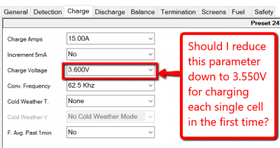

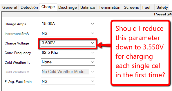

I read somewhere in this thread, BM said we should charge new cells at 3.550V instead of 3.600V in the first time. In the preset I see the charge voltage is actually 3.600V. Should I reduce it down to 3.550V?

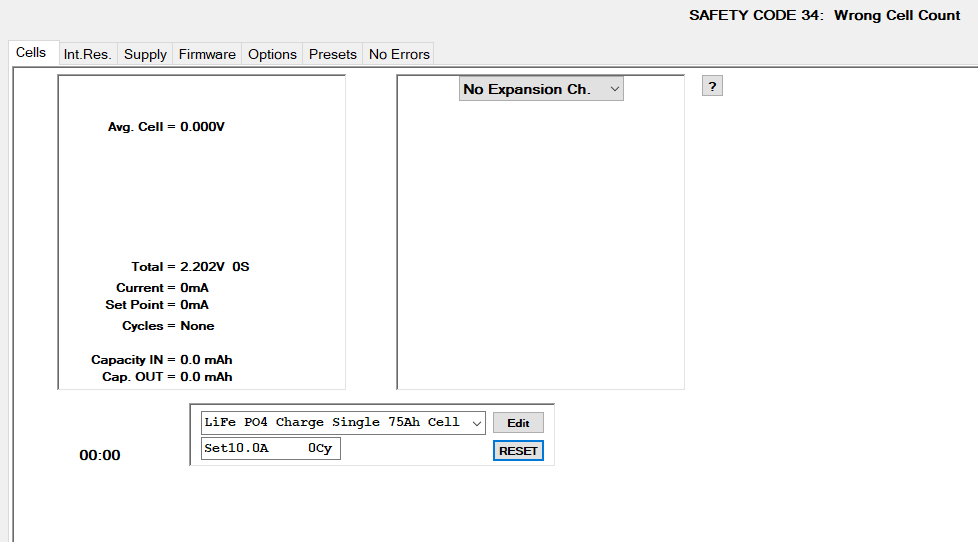

I am trying to charge the fault cell. PL8 shows an error "SAFETY CODE 34: Wrong cell count" as the image below. It seems that's due to the cell's voltage is too low. Can I do anything to fix this error?

snaker wrote:PL8 and cables just arrived. I will start charging each cell in tomorrow.
I am pretty sure you can leave this alone at 3.6V - not to worry

snaker wrote:I am trying to charge the fault cell. PL8 shows an error "SAFETY CODE 34: Wrong cell count" as the image below. It seems that's due to the cell's voltage is too low. Can I do anything to fix this error?
if your trying to charge just ONE Cell - you can lower the charge Rate - its showing 10A - that may be too much for a single cell - it may not be the error your getting - did you get a preset from BM for charging just ONE Cell at a time ?
thats the preset you need to use if charging just ONE CELL - double check
Postby steves1977uk » 11 Aug 2017, 16:40
I believe snaker is using 75Ah cells expresso, although 10A should be ok for these I would charge at 5A to be on the cautious side. Trouble with buying generic cells is we don't know their quality.
Postby expresso » 11 Aug 2017, 17:06
AHH yes thats right - i keep thinking always Headway cells -
Postby Gnomatic » 11 Aug 2017, 17:30
steves1977uk wrote:I believe snaker is using 75Ah cells expresso, although 10A should be ok for these I would charge at 5A to be on the cautious side. Trouble with buying generic cells is we don't know their quality.
I would think 10A charge would be fine for these 75Ah cells. Their max charge spec is 1C, which would be 75A. Unless I'm mistaken, a !0A charge rate on these cells would then be .13C. (if my understanding of calculating C rating is correct)
2.2v on the cell seems pretty low.
