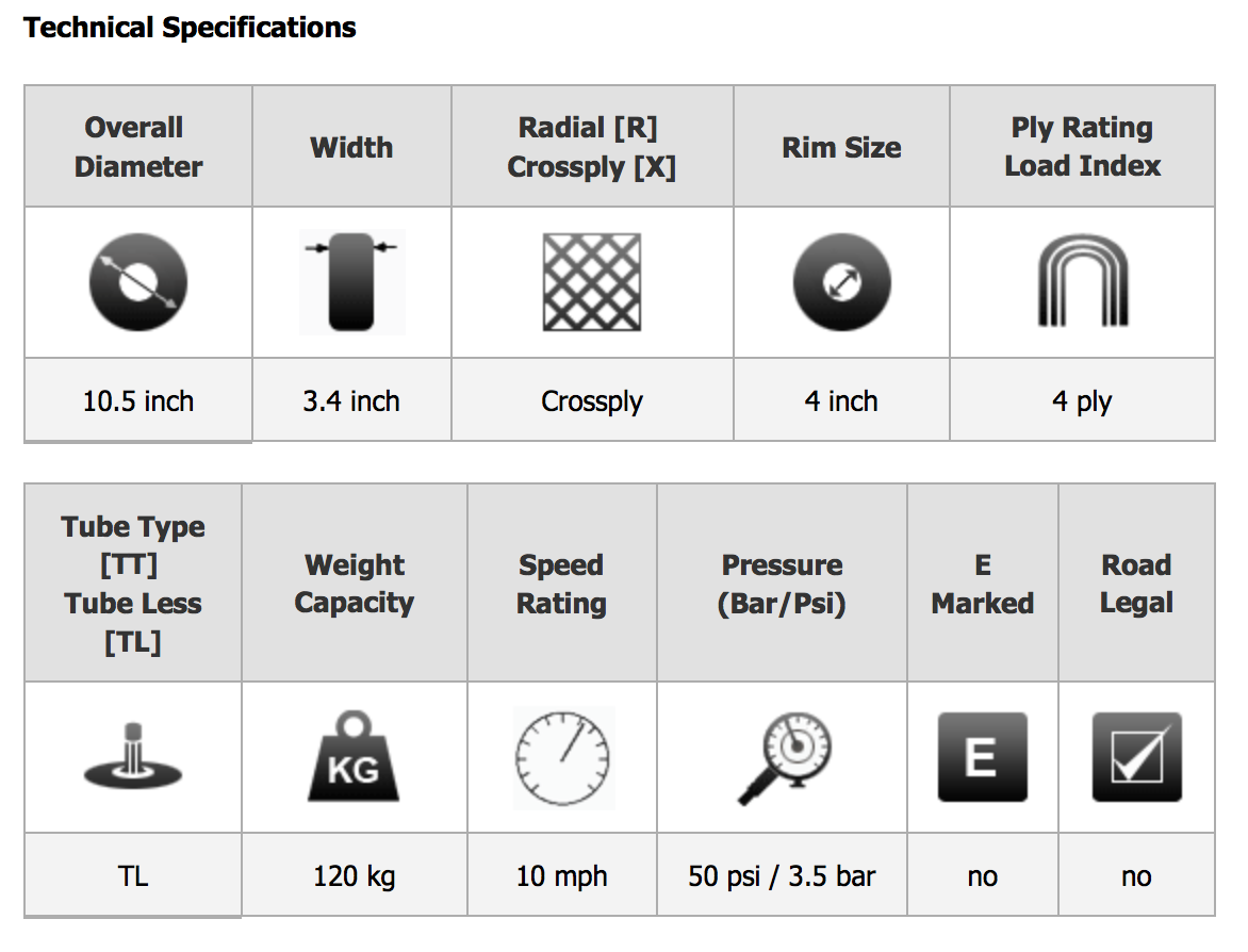

Will these tyres fit on shirley's 3.50 x 8 rims? And give an overall chair width of 25.25"?
https://www.oponeo.co.uk/moto-tyre-details/heidenau-k75-3-50-8-46-m-front-rear-tt#185027393
And I could stick these on the front?
https://allterraintyres.co.uk/index.php?main_page=product_info&cPath=1087_1241_1251&products_id=91538
Cheng C248 tubeless

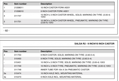

Although a bit concerned that at 10.5" dia they might foul castor fork throat?
https://www.oponeo.co.uk/moto-tyre-deta ... #185027393
No... You need 120/70 tyres for a 3.5 rim.

You could but those are the wrong kind of profile/shape. And a little big. You need smaller to help miss centre footplate. You need the ones I linked to earlier.

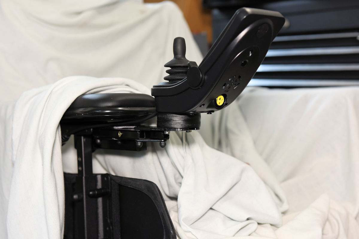

1st thoughts. With the control pod mounted like that you will need to have your arm snapped and reset with a Z in it to be able to drive! :cussing And they are all like that... So major arm surgery required ASAP! Or take a look at my pod position.

Before any of this, you need to figure out a way to mount the control pod about a foot higher, and about 2 inches inboard from the arm top centreline. And then adjust the swing away mount with allen keys and a spanner so the joystick does not wobble an any slight way if you wiggle it.
Re the armrests, as you've mentioned before they're not really strong enough to put any weight through.
Its not really the weight. Its about the fact that they move laft/right if you put any pressure on them when transfering. Or while you are attempting to steer on an uneven surface. That allows unwanted commands... You are not in proper control. Like expresso complaining about instability on bumps. Thats what he means.
I was wondering whether I could T-mount a chunky piece of flat steel bar to the base of the armrest and mount it in the existing sideguard mounting points? The armrest would then be more pedestal like, similar to your own? But I need to give some more thought?https://www.ebay.co.uk/itm/Bright-Mild-Steel-Flat-Bar-Various-Sizes-20mm-x-3mm-to-50mm-x12mm/391170005087?_trksid=p2485497.m4902.l9144
The correct single post arms and mounts are relatively cheap and easy to find. Maybe rover.

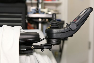

The image of the control pod above was still low. Its now 20mm higher on a alloy spacer, and the centreline of the controller is in line with the inside edge of the arm.
Posts: 70462
Postby Burgerman » 22 Mar 2018, 14:13
Note that there are now 4x 5mm thick spacers, sat one on top of the other. Under the joystick.

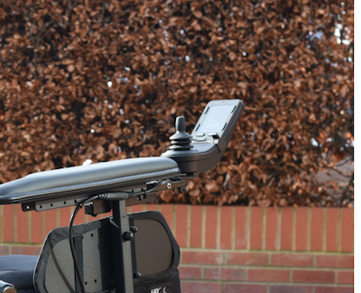

Two more of my chairs. Note joystick position. To the left of the arm, and the plastic body, a little higher than the arm.
http://www.wheelchairdriver.com/images- ... chairs.JPG
