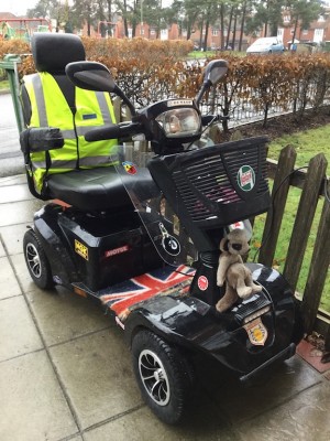

My large scooter does 15kph (about 9.3mph) and I feel much safer riding that. I think it must be because of the longer wheelbase and handlebars. Out of interest this afternoon I measured the wheelbase of my Salsa R2 which is 19 inches approx, and the large scooter is 39 inches, so just over double the wheelbase.
Back on topic of this thread, I'm particularly interested in converting my scooter to lithium first. I use it an awful lot for runs to the supermarket, DIY store, visiting friends. It's road legal and big enough to be safe on the road.
But I really like the Salsa too especially now I've done some seat mods on it. It fulfils a different purpose to the scooters. It's so much more manoeuvrable and I can access small shops and public transport which I can't with the scooter.

For the scooter conversion I would need to make two Group 24 battery packs, maybe Group 27 if there's enough height under the bodywork?

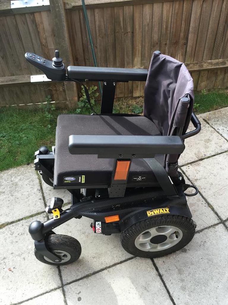

Yes - Scooterman - i will have to lower the gearing on my new chair to slow it down and get more bottom end power back - i will try to enjoy it first a bit in the summer before deciding but its looking like i be going down that road at some point. other than that - working out the little things during the winter - making a new pack for it and hopefully start using it this coming summer.

I demo'd the 12mph chair like expresso's. The speed is nice on flat ground, but I had to "fight" the joystick to get it to go where I wanted. Struggled to roll over a small tree root in the grass. Hard to control and under powered. I liked the 6.5mph offroad version of that chair better.
Its a trade I guess. But I'll definitely trade top speed for more power.

yes i felt i had to try it - i should have given it more though but its done now - let me say this - with stock 646 120 Rnet - chair was decent speed and i had no issues on hills etc, at 8.5 - i am not about 165lbs - not too heavy - for me a 6 is too slow of chair 8 at the very least is comfortable for me .
with that said - the 646 is faster than stock for a few reasons - first rear tires are bit larger OD - that make a difference - lithium also and upping the Volts was the bigger difference leaving the bottom end as it was before - that chair gives me a solid 10 - at times i clip 11 on GPS - but its quick speed should be fine for most.
now the bounder is faster on flat ground only. - i took a chance since its a gear sprocket change thats needed to bring it back down to earth :) at its slowest speed it will be 9 mph - changing out the chain gear set - at 9 - i will be faster than my P222 but slower than the 646 - but at least i will gain the bottom end back - at least enough to make it work better all around and not just flat ground -
i always planned to make an ADD ON for this chair either way - since 100ah isnt enough on any chair - between the ADD ON and lower gearing - it should work out nicely in the end. i may want to just bang it out first summer first to get my kicks with the speed. or maybe not - well see how the chair works with the ADD ON.
i will help but sucking out alot juice all the time with hills will be the biggest issue with this chairs range. its my mistake - what can i say - :|
