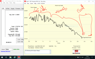

Postby Burgerman » 11 Jul 2019, 00:11
If you are planning on using a BMS it gets a bit complicated. And it depends on a bunch of complex things that nobody can know. For e.g what exactly does the BMS do? Every one if a bit different. What exactly does the mobility charger do? Again, I never saw 2 that came close to doing what you would expect them to do. And how these two randome things work together.
Its not so much about charger Amp power. Its about what each thing does when actually charging. So what you are planning on doing may or may not work at all, may cut off before cells are fully balanced, or before the lead is charged properly, or work OK. Nobody knows...
Some simple relevant questions.
What is the CV voltage of the charger? And does it do this in a stable fashion. Many dumb chargers certainly do not!
What is the method of termination? Is it time? Or some arbitrary current point reached? Because ideally it needs to be 500th of the leads Ah, and around 300th of the lithiums Ah. Added together. Or a time limited 4Hours at CV or both, whichever occurs sooner.
At what voltage will the BMS begin balancing? Does it continue after charge? If so it will require a longer CV or the lead battery will be pulled down lower after charge ends. And it may not balance at all if balance current is too low or starts too soon. Does the BMS end charge when the balance ends, or when current is low and at what point?
What decides on the BMS when the pack is balanced? And does it then continue at CV or cut off the charger?

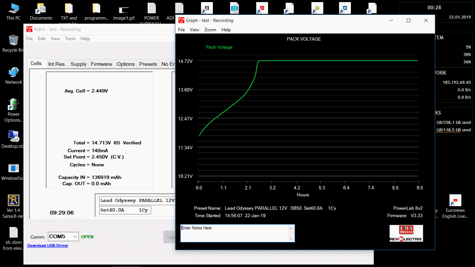

And heres a graph from a typical mobility charger (from a member here) MONITORED by the PL8 we use.
Ignore the red, thats all wrong. This should show rock steady CV volts!!! The balance or BMS wouldnt work properly or at all if your charger does this!
ALL WRONG!!!
This is what a GOOD charger (the PL8 itself for e.g.) and the one above SHOULD do. This is a PL8 charging correctly at the right stable voltage, and at the CORRECT voltage as set.
PL8 charge.
THIS would allow the BMS to "work" and correctly end and terminate the charge for lead at least.
So will a BMS work??
It might. Or it might not. They are awful things, doing the wrong thing in the wrong place.
So will a dumb charger work?
It might. Or it might just not allow the (crappy) BMS to do its thing.
So will they work together?
They might. In a fashion. If you are lucky. Frankly I think its a great way to get problems and ruin the lead and the lithium fast!
But you MAY be lucky.
