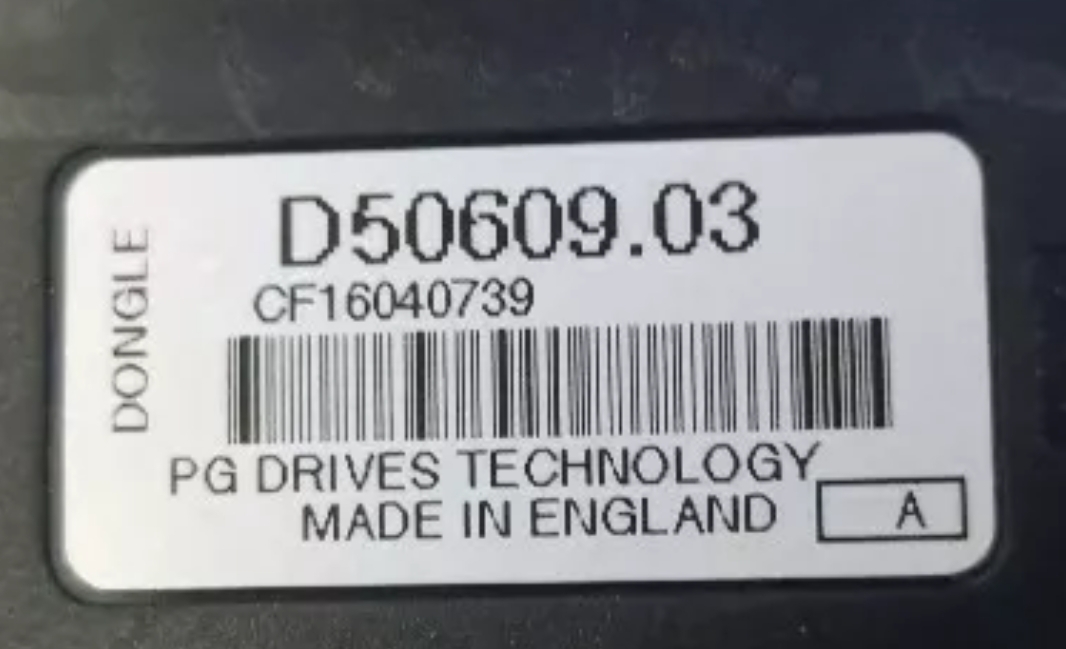

Postby shirley_hkg » 06 Apr 2020, 04:51
Is it an OEM ?
Posts: 4656
Postby expresso » 06 Apr 2020, 04:57
Mines shows B - would say its not OEM
Postby shirley_hkg » 06 Apr 2020, 05:01
GOT IT .
Posts: 4656
Postby rover220 » 06 Apr 2020, 07:57
Dealer. 50609.02 is OEM with a B in the little square box.
Postby Burgerman » 06 Apr 2020, 09:50
No shirley "A" means dealer.
EDIT: I didnt look above! :roll:
You can still use it as OEM with a small anoying workaround.
Posts: 71096

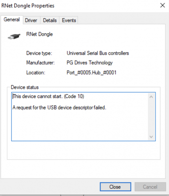

Postby thebassman » 27 May 2020, 16:53
Here's what Device Manager looks like...

Postby expresso » 27 May 2020, 16:57
try new cable - i guess its a computer issue with devices - go to device manager and delete some things there - usb connected items etc,
reboot - and try it again - or do a search on what Code 10 means - you might see some items in device manager with question mark - those are the ones not working correctly - remove them and reboot - hopefully it will reinstall correctly -

Postby swalker » 28 May 2020, 02:28
Perhaps the cable you tried to use was not a data cable.
USB can have 4 wires, 2 for power and 2 for data. Some cables only have the 2 wires needed for power and omit the data wires. These can be used to provide power to a device, but not to send/receive data.
It seems unlikely that a USB cable with a B connector on one end would be missing the data wires, but it is possible.
It is also possible that one or more wires had a break in them (typically near where they join up with the connector).

Postby thebassman » 30 May 2020, 00:04
....It was the damn cable. Thanks everyone. Last thing I would have checked. Now to have some fun!

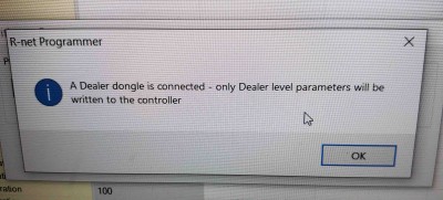

Postby wchl25 » 05 Jul 2020, 18:38
steves1977uk wrote:The workaround is the following steps:-
1. With the Dealer dongle connected, save the settings from the chair using either Dealer or OEM programming software. Save the file with an easy name, e.g. Dealer.r-net
2. Disconnect Dealer dongle and open the Dealer.r-net file in the OEM software. Do not make any changes at this point and just re-save the file with a dfferent name, e.g. Dealer_OEM.r-net and then close the software.
3. Re-open the OEM programming software and load the Dealer_OEM.r-net file. Make the required changes and save as a different name if you like.
4. Re-connect Dealer dongle and write your new settings to the chair. Job done! :thumbup:
Hope this helps,
Thanks! I was able to re-save the file and edit it perfectly. However, it would not allow me to write the settings back to the chair. It said that a dealer dongle was connected and only dealer settings could be written. Is there a way around this?
