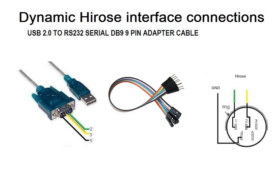

Question 1 ...No idea....Rover might know.
Connection via the hirose is fairly simple ...you just need a RS232 - USB Adapter and 3 Dupont leads.
DO NOT USE WIZARD 6 ..Use The "special" version of Wizard 5 .

Note that the 5 pin Hirose plugs are now obsolete....here are the part numbers should you wish to chase around the web.

The 5 pin is the cable that goes before the DWIZ adapter, you dont need it (the DWIZ adapeter)
