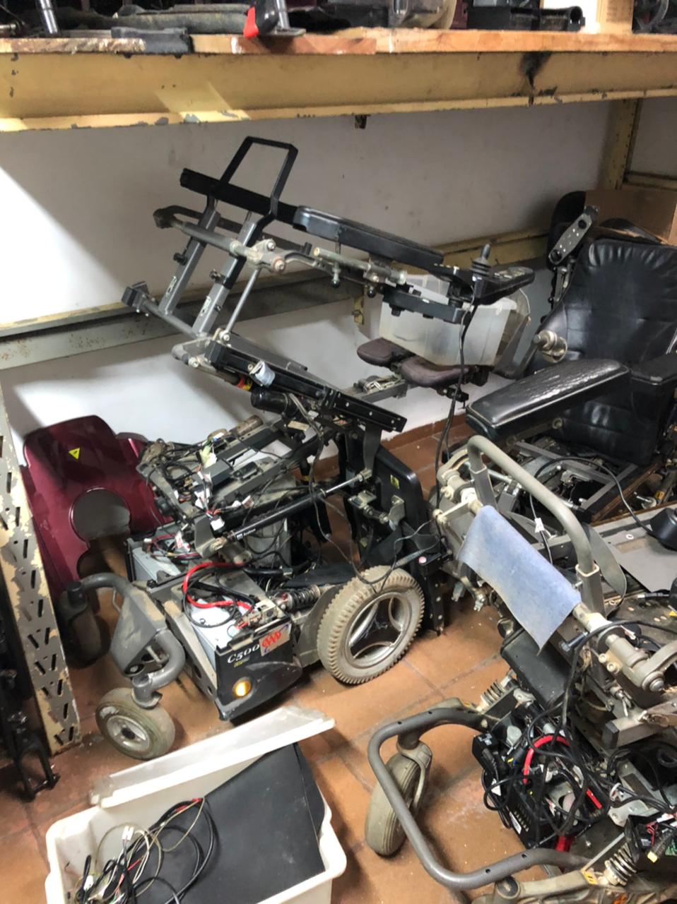

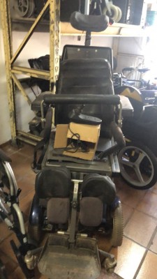

I have technical assistance , at the moment , 4 permobil , 2 - c300 , 1 - c500 and 1 - M300 are here for repairs
as below in the images, just don't notice the mess, kkkk .
I can not understand what could be the parameter that could be the cause .......
Would I have any configuration room , or maybe , play with the one I sent him , there or trying , rsrsrsrrs
