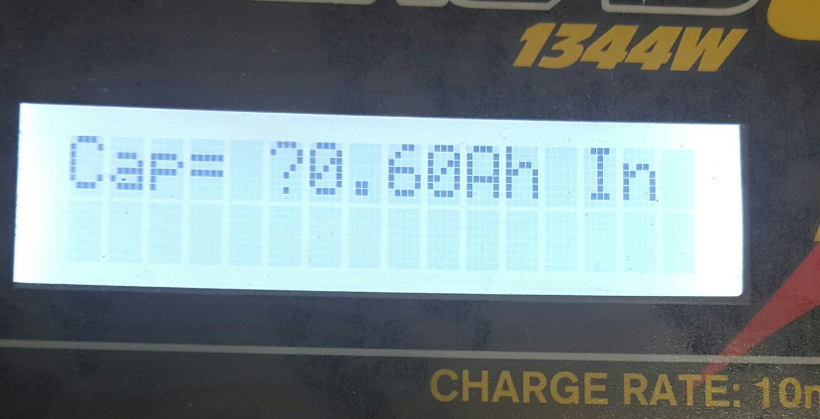

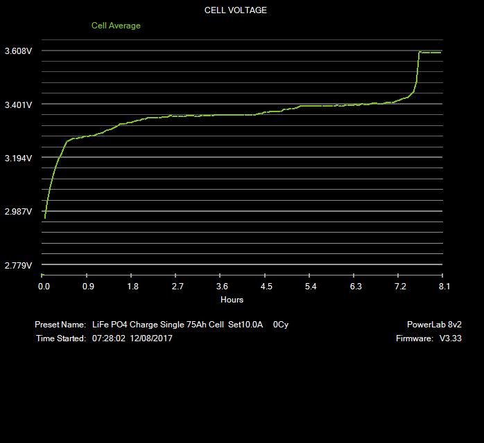

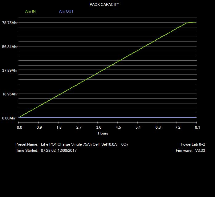

Postby snaker » 12 Aug 2017, 09:58
I just finished charging the first cell. It looks good, 75Ah as claimed.
I will charge 16 cells that are actually 2.8V first. After that, I will deal with the fault cells.
Shirley, by your experience, are these cells fine if charged at 15A?

Postby snaker » 12 Aug 2017, 10:23
In the next days, I will leave my dad charge cells through PL8 base (not software). Does PL8 show a summary on its small screen after it finishes charging? I just want to note the charging time of each cell.
Posts: 1258
Postby shirley_hkg » 12 Aug 2017, 13:45
snaker wrote:Shirley, by your experience, are these cells fine if charged at 15A?
That's fine .
However , its common sense to charge an empty cell SLOWLY .
Start with 2A , and resume to higher amp after 3.1V
Postby shirley_hkg » 12 Aug 2017, 14:20
snaker wrote:Does PL8 show a summary on its small screen after it finishes charging? I just want to note the charging time of each cell.
YES ,it tells every thing BEFORE you press STOP .
PL8 only tells up to 99.99 Ah charged .

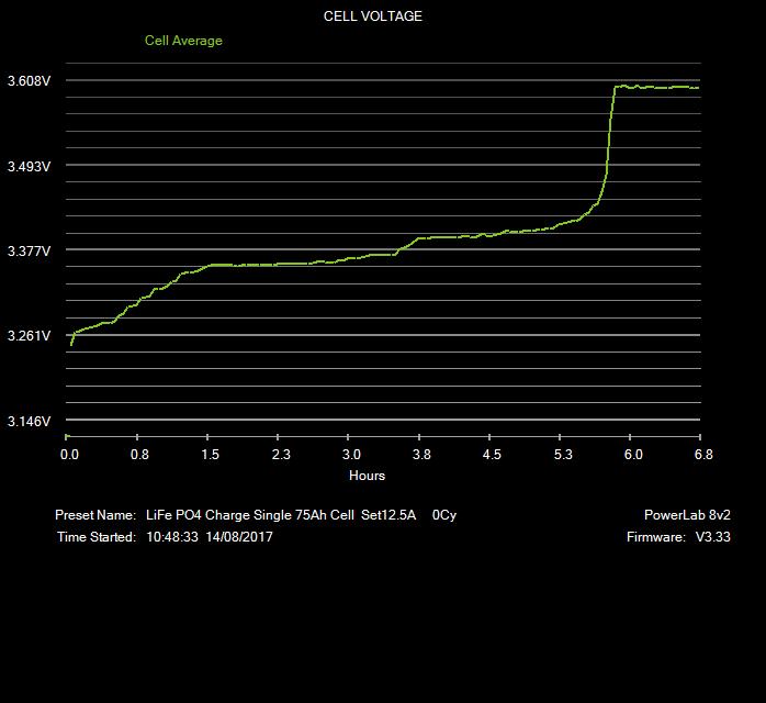

Postby snaker » 14 Aug 2017, 01:32
My dad is making a long, thin cable. We will see if the low cell could survive.
I see PL8 takes very long time (about 1 hour) to charge the last 1Ah. E.g I set charge current at 15A, I see PL8 takes only 5 hours to charge a 75Ah cell nearly full (74Ah, 3.590V). Then it continues charging in 1 hour just to put 1Ah into the cell. Is there any setting to reduce that last 1 hour charging time? I mean PL8 no needs to charge full 75Ah, it can stop at 74Ah or when the voltage reaches 3.6V or it can continue charging but in a shorter time (i.e 15 minutes instead of 60 minutes).

Postby snaker » 15 Aug 2017, 01:35
The 2.2V cell survived :D
I charged it full, its charge result is the same as other healthy cells.

Postby snaker » 15 Aug 2017, 08:02
After a week, I will discharge some cells (including the low voltage cell) to check their real capacity. I am charging cells in their first time. I see their input capacity is in range 76-78Ah. After a night, their voltage drops and stays at 3.4xx as expected.
