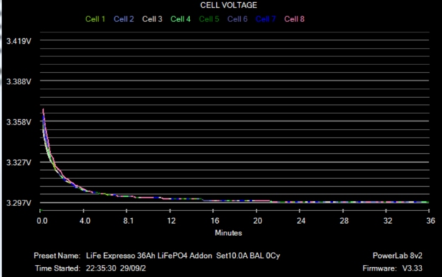

The pack is built, I am discharging it a bit using Expresso's 36Ah lifepo4 addon preset. All cells are at 3.297V
