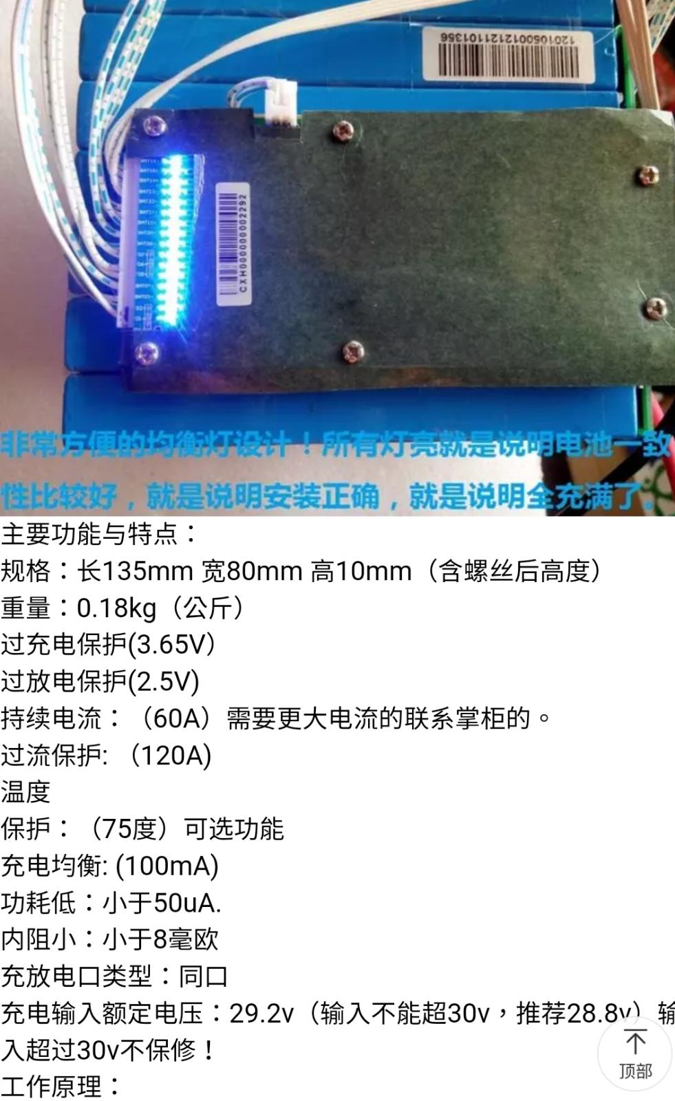

Postby rickystyx » 18 Jul 2019, 10:07
These are the specs that are listed but I have messaged them for detailed spacs for the BMS - Sadly I don't understand much about any of it but it does say that the output current can be changed - I'll see what I get back from them

Postby Burgerman » 18 Jul 2019, 10:22
It will work. But its an oversized and overpriced way of adding 40Ah. Its also potentially unreliable and will have a shorter service life. And you will be in the dark about what is going on under the hood. But it is the only option if you really dont want to build a pack yourself. At least using a BMS pack as an addon will not leave you stopped dead at the side of the road.

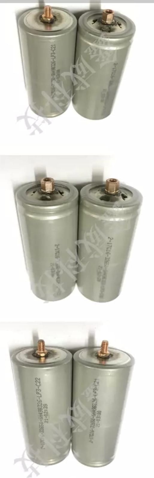

Postby shirley_hkg » 18 Jul 2019, 11:57
I'd avoid these 32650 cells , notorious for leaking. drunk2
Pick something else . cheers

Postby shirley_hkg » 18 Jul 2019, 15:24
Yes . It is useful for putting the pack together as an initial balance .
Get a BMS with same port for charging & discharging , and cell over-volt cutoff @3.65V max.
You'll then be able to charge both batteries as one as usual . May also need a few Schottky diodes to perfect it .
