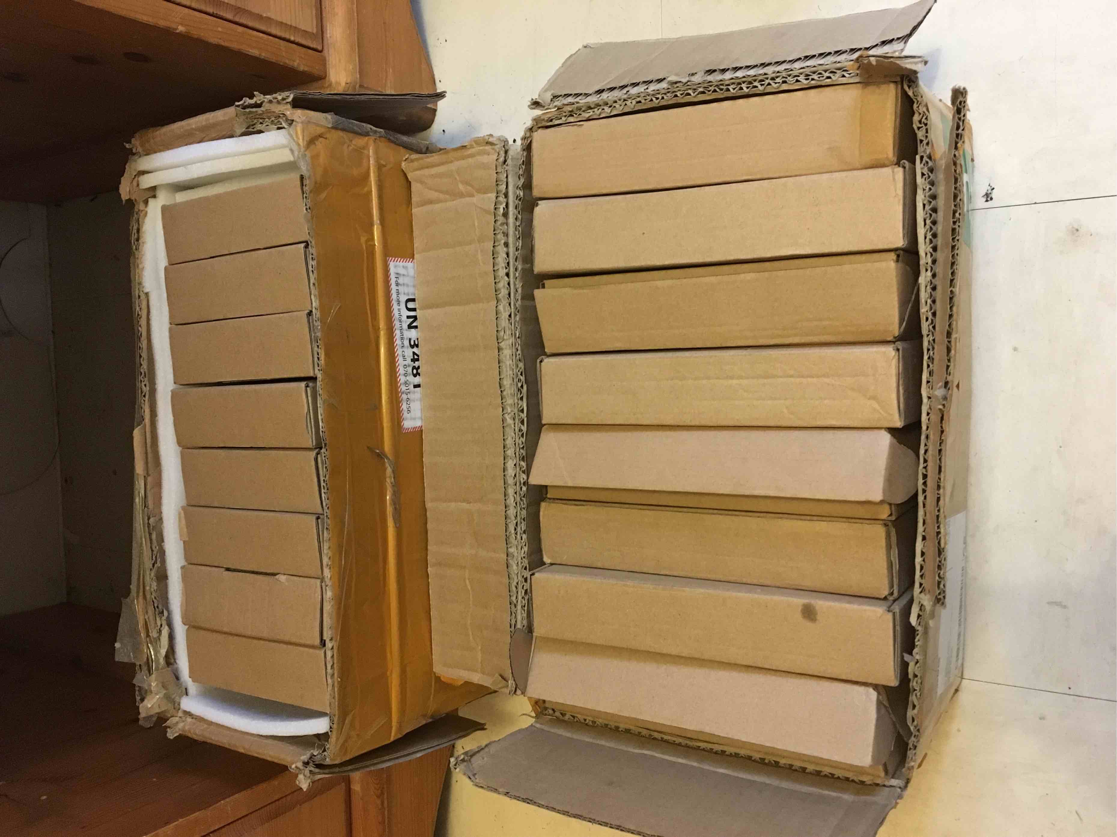

terry2 wrote:They have just turned up :)
I've got a friend to bring them in for me. And so far so good.
There are some scratches and marks on the cells. But no bulging.
Now to find out what to do next czy
We're they well packaged?
Postby terry2 » 05 Mar 2019, 12:10
There was a smaller box which had foam around the 4 (top\bottom and sides)
Then that box was put in a bigger box with bubble stuff around. So yes very good.

I was disappointed with how mine were packaged. I'm not blaming Shirley as I think they came direct from his battery guy. But it was the box with no polystyrene that had split. Perhaps if they'd been packaged similar to yours they would have survived?
But then as Steve said, smaller boxes probably mean cheaper shipping. I've just started testing each cell individually at the moment. My dodgy power supply seems to be able to cope with a single cell at 3.6v 18A without smoking.

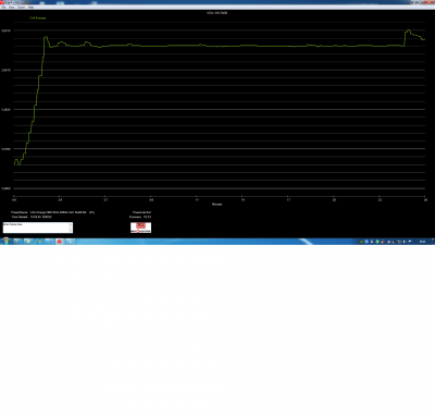

Will the PL8 know when to stop charging or do I have to watch it?
Also. Which graph in the software is best to watch.
I'm still pooing myself :( :)
Postby terry2 » 05 Mar 2019, 17:25
That my first try. Is that ok?
The little spick at the end is when I accidently touch the power supply knob.
Postby Gnomatic » 05 Mar 2019, 17:32
Looks like that one at least arrived fairly full, unlike swalker's. No buldging either.
You and he ordered the same cells from the same company, correct?
Postby terry2 » 05 Mar 2019, 17:41
Gnomatic wrote:Looks like that one at least arrived fairly full, unlike swalker's. No buldging either.
As far as I know Yes.
The second cell is charging the same. The first one took 25 mins.

Postby Burgerman » 05 Mar 2019, 17:41
That would seem to be correct. And also slightly amazing. They SHOULD be shipped around 30 to 50% full. But some are shpped at full charge. Not the best way. Those look to be 99% full. The swalker ones were 1% full...

Postby terry2 » 05 Mar 2019, 17:43
Burgerman wrote:That would seem to be correct. And also slightly amazing. They SHOULD be shipped around 30 to 50% full. But some are shpped at full charge. Not the best way. Those look to be 99% full. The swalker ones were 1% full...
I would bet that swalkers were a set that had been returned or warrantied for some reason and resold. The fact that they are bulged means that they were likely abused in either load or charge voltage (BMS or some other abuse). I expect them to be fairly high impedance. Although hard to measure. I would be demanding a refund. Or replacement as a matter of course. Or a refund from my credit card or paypal.

Cell 2 is the same(it's still charging)
