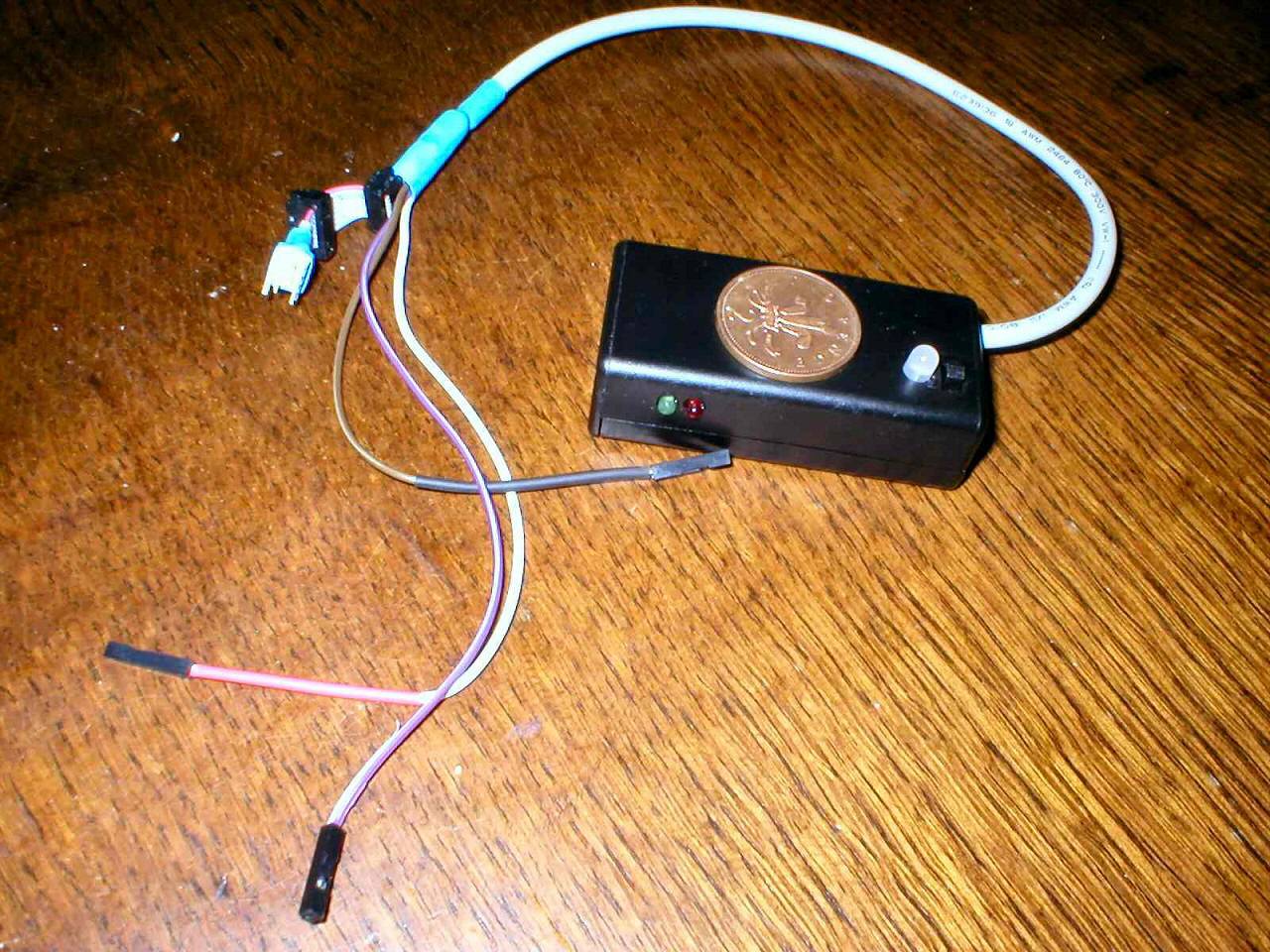

Postby woodygb » 03 Sep 2014, 13:28
Pic of "finished" Blue Tooth interface.
Red and Green led's denote Fore/Aft & Left/Right ... they get progressively brighter with increased input from the joysticks.
The larger led ( Blue ) lights when the Blue Tooth has connection.

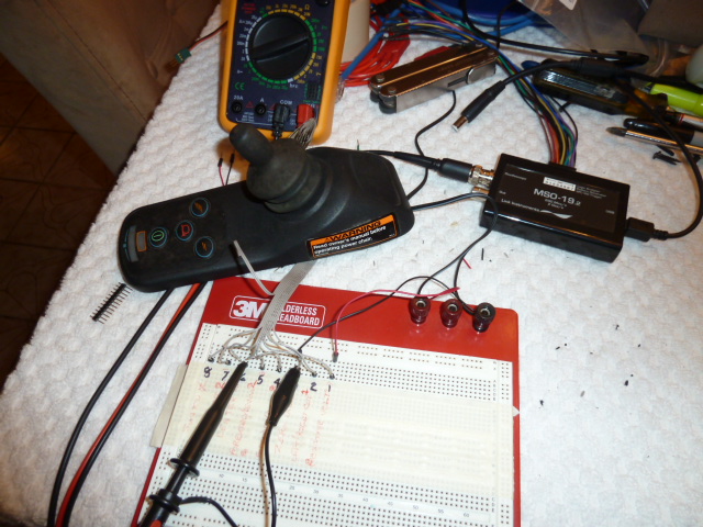

This is a pic of the insides of a Pilot+
download/file.php?id=3262
