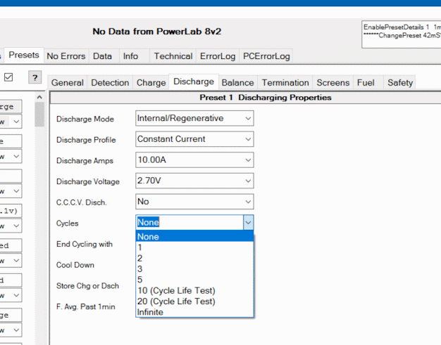

Postby snaker » 20 Aug 2017, 02:02
I finished full charging all cells and step into the discharge stage. As I remember, when I clicked on Start button I saw the "n CYCLE" option. Now the "n CYCLE" option disappears as the image below. Does it depend on presets? How to get it back?

Postby Burgerman » 20 Aug 2017, 05:56
You dont really want it back. Actually I only ever used it on metal hydride.

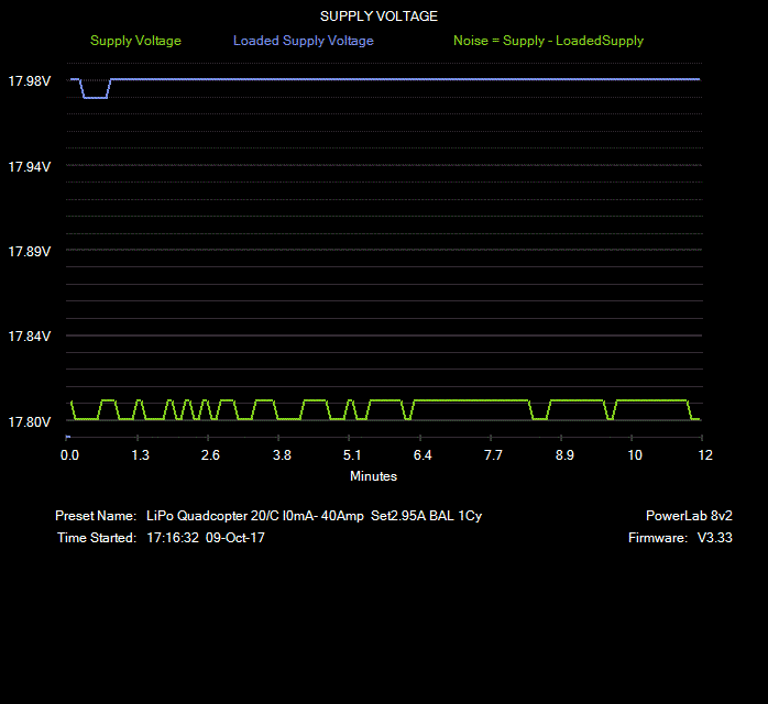

Postby Gnomatic » 09 Oct 2017, 15:48
So I got a new PL8. Both times I've charged with it, the charger gets well into the CV stage, but stops when the current falls to 1.5A-2A, On the charger itself, it says "PACK REMOVED (Undercurrent)." It won't complete the charge.
Any clue what's happening?

Postby Burgerman » 09 Oct 2017, 16:47
I see two reasons why this may have happened.
Your power supply has a full volt and a bit change between on load and off. (this is pulse width controlled). Thats not great. But alone will cause no problem. Mine varies by 1/10th of a volt.
In addition its not well regulated as evidenced by the wavy line showing that current on charger input and cell being charged varies up and down most of the time along with the volts. It makes the charger hunt all the time as it tries to adjust to the varying supply. This means it may see the voltage drop below the termination current you have set before it should. Hence charger sees an error or thinks the pack has vanished?
But this is made worse due to the battery CV voltage coinciding with the swap from buck to boost. Theres 2 seperate inverters in the chargers. One can charge a battery lower than input voltage. One charges a battery at higher than input voltage. Because your charger sees a voltage rise, from the power supply, as it reduces current, it then tries to swap to buck mode. As it does so and adds current, the voltage from the power supply falls again... So it keeps swapping...
Solution, a more stable supply. or set the power supply voltage well above or well below the CV voltage. A couple of volts below CV is the worst possible option.
You can change CV slightly, better still change power supply volts. Or try setting a higher frequency for conversion.

My PSU is a pair of 12v server PSU's cobbled together and wired in series. The only way I can change the voltage on it is not plug in one of it's server PSU's. In which case the overall PSU runs @12v.

Well here is an example of my bench supply, both are equally good.
This is the voltage while charging my lipo batteries in the bot... these are charging at 3A and its currently falling down to around 1A.
Thers just 0.18V difference loaded and unloaded. And the loaded volts are ABOVE the unloaded.

Postby Burgerman » 09 Oct 2017, 18:23
Set CV voltage to a higher or lower voltage, and set frequency to higher or lower speed. It will likely not do it then. First be sure no bad connection.

Postby Gnomatic » 09 Oct 2017, 19:32
Burgerman wrote:Well here is an example of my bench supply, both are equally good.
Looks much tighter than mine, no doubt. I'm guessing those weren't cheap! :lol:
